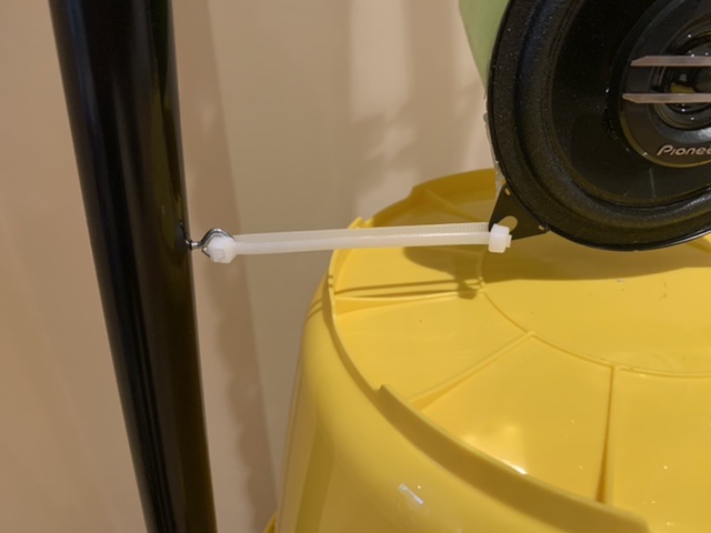

I’ve been testing them a bit with some bass heavy tracks. I think the sand in the buckets is helping. I think there’s less energy going into the floor and the bottom of the bucket at the top seems to be vibrating less.
I think they sound fantastic BTW but I may be a bit biased.
I used screw in eyes to tidy up the cable ties holding the bottom of the line arrays and some more pens to make mechanisms at the tops to allow fine adjustment of the angle the arrays hang at. I’ve set them precisely vertical using a spirit level.
The conduit from B&Q is sold in 2m lengths but they are not cut very accurately. The bottom of the conduit is raised off the floor by about 1cm so it doesn’t vibrate and I tried to get the tops to line up precisely when I drilled the holes for attaching to the buckets but the tops are not quite at the same height. I tried to correct this by measuring the locations for the new holes for the pens to be the same distance from the floor.
I want to get some stainless steel springs to replace the bungees and cable ties. I think that will look neater. Maybe if I can get some whippy springy steel I can make some to fit.

Maybe take it up a notch with ceramic pots😉
It’s necessary to cut holes in the bottoms of the buckets to install the woofer drivers. I used the saw feature of a penknife (which was doable but a bit painful). You’d need a diamond hole cutter to cut the same holes out of ceramic pots.
I paid £1.99 each for my buckets at co-op (B&Q has some that look suitable for 95p). Ceramic pots are going to be 5-10x the price maybe.
Concrete might be an option. You could just put the buckets of the current design into a slightly larger bucket and fill the gap with concrete. Take away the pens and use some rebar in the concrete instead. It would be quite a lot of effort and mess for a marginal improvement though.
One of the things I like about the design is that it’s quite light weight. With the cones inside to eliminate the flat surface of the bottom of the bucket, the buckets make quite good pressure vessels and the opposing drivers cancel each other out so there is very little movement. When suspended from the pens in the middle it all works quite well and the bass is very tight. There is a little flex though so the design isn’t quite as good when the buckets are used standing on the floor.
Using concrete would help but I think it’s a bit of a brute force solution and it would make the speakers very heavy and hard to move. I think it would be better to come up with a different frame design that would allow the woofers to be suspended from the middle above the floor.

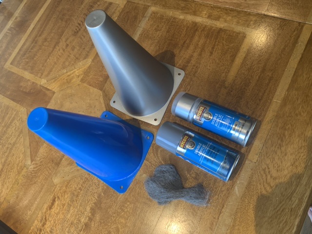

Testing out paint adhesion. Seems to be good enough if you rub the surface down with wire wool before priming it. The plastic has some flaws so the finish isn’t perfect. Coverage is not very good — using those paints would be expensive. I bought the silver by accident thinking it was a clear lacquer. I don’t like the color. There is a nice pearl black though. Anyway, I think the bottom line is that it would be easy enough to paint them any color you like but better to do that before assembly. I’m tempted to make another pair.

I think with two extra buckets per side it would be possible to decouple the woofers from the floor:
Disconnect the woofers from the frame. Put a ring of foam neoprene around the top and bottom most bucket rims to act as suspension. Sit the woofer in one of the additional buckets, resting the neoprene ring on the new bucket rim. Put the other bucket on top upside down to rest on the other neoprene ring. Attach the new bottom most and top most buckets to the frame. The woofer assembly will now be a little taller with the two additional nested buckets and the old woofer will be suspended inside between the two neoprene rings.
I think most of the flex in the woofer is in the bottoms of the outer buckets between the internal cones and the bucket walls. By suspending the woofers inside another pair of buckets this flex will happen inside the gap between the nested buckets and will no longer be pushing against the floor.
The frame would no longer be a statically determinate structure so it might need a brace somewhere but I think it might be OK without if the neoprene was compressed a little to prevent the top bucket rotating.
Nested buckets could alternatively be used to implement the concrete idea by filling the gap with concrete but expanding foam between the nested buckets might work and would be a lot lighter.
So, a couple of alternative design possibilities to test out.
Maybe sufficient just to sit the existing design on a ring of neoprene around the bucket rim nested in one more bucket per side. The frame would still be coupled to the woofers but the line arrays are decoupled from the frame by the bungees.
Another option might be to add T junctions and feet to the conduit on either side and use that to raise the bucket off the floor so the speakers stand on the frame instead of the bottom bucket.
You can also buy stands for decoupling subwoofers but they are quite expensive.
