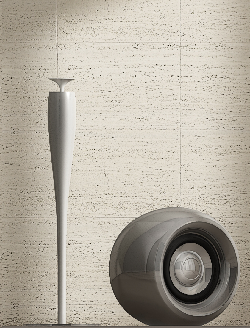

Guess Bill is far more concerned with aesthetics than acoustics. We all have our priorities. I just can't understand that kind of investment without considering the sound.
BTW, I prefer my Dayton RS to their Titanic. I prefer my Peerless 830500's to either. I run slightly larger boxes so I can get the Q lower. My preference for subs. 60 to 70L.
Putting a hemisphere on top of the deflector would reduce diffraction problems the knife edge will introduce.
The deflector could be attached to an "X" across a standard speaker, or to a perforated metal screen which would reduce the amount of dead bugs collecting on the cone in coconut land 😉.Hi, how are you going to attach the deflector to the top of the sats? Through a hole in the middle of the driver? Looks great, like something B&O would sell for 20 grand.
I am very concerned with aesthetics. If it looks like a duck, swims like a duck, and quacks like a duck, then it probably is a duck.
but seriously, I do want it to sound as good as possible within the brief of the design. The drive units will be chosen on sound quality and the cabinet shape is as much function as form.
The deflector is mounted inside so I'll remove the dust caps, or if using the Omnes I'll take the phase plugs out
Or the deflector could be used as a Phase Plug and mount directly to the driver core.
yes thats the plan, similar to what I've seen people do with Fostex drivers

Back to function. I would be concerned you will have localization of the sub problems as I doubt your mains can get down low enough. The steeper the crossover the better. ( I do LR4 @ 60 ) Your sub will work, but at only one foot the Q will be on the high side which may leave you with less bass than you want and a big hump where you would rather it just roll off. Custom EQ may be able to tame it. Every extra cubic inch will be to your advantage. You are going to need quite a bit of EQ with those mains to deal with the baffle step and diffraction as well as no real tweeter. If this is to be an integrated system, then that is a piece of cake.
Several people have tried the midrange reflector idea. Never seemed to work very well. For no other reason, the round shape is the very worst thing you can do with regards to baffle step. (See Olson) Omni mains tend to be difficult to use in real rooms. It really comes down to needing about a 6 inch mid to reach down to the sub and a real tweeter to get anything like high fidelity. I offer the challenge is to make that blend in. In-wall is the least obtrusive. If your goal is just background music or a little better TV, they you may be fine but a couple of wall plates could be better.

The full rangers I'm using have a raise in the treble region and should have an f3 of 120hz. The sub will have a Qtc of around 0.82/ slight raise around 50-70 hz, which has some advantages.

High Q sub, full range, and high crossover. You have been advised that is not a good combination for quality sound reproduction. Best of luck.

I'm factoring in a 10% difference of drive unit measured parameters - if I go by the factory numbers there is no rise at all.
I'm guestimating the sub Q leads to a small 1dB rise around 50-80hz which is ok; 28-30l volume makes for an f3 of 35hz with the rise factored in. I prefer a small dip around the 150hz region and this can sometimes help w/ Bsc; crossover is 100-120hz.
Bill, consider the Dayton HO series 12" vs. the HF. With the HO you will get better extension in that size box, and may even be able to do a very nice rear facing flared port.

Speaker first:
10% is a fair guess for a driver after it is broken in.
My preference is I want my bass to roll of gently. Any hump makes it sound boomy. Remember, you will get some boost from the room. A woofer that models perfectly flat will sound fine on top of a 100 foot pole. I don't sit on a 100 foot pole. This is why I like sealed subs with a Q below .6. They just seem to work better in a real room. You should also remember balance. If the bottom end is nice and flat, but the top is lacking, it will sound un-naturally dull. With no tweeter, you may want to back off more of the lower mid and bass that you expect. Only way to know is to prototype. I might have mentioned that.
Have you thought about replacing your diffuser with a sphere holding a small footprint neo tweeter?
If you insist on such a high crossover, be very careful to keep the woofer the same distance from each main speaker or you will have serious cancellation and boost problems in the upper bass. Finding a driver you can push down to 80 and as I mentioned, steep crossover would help.
Thanks, i haven't modeled that driver yet. The back will be full of plate amp, so not much space.. It would look great with a great big flared port instead 😎
I modeled it a while back, I know the HO 12 will do better than the HF 12 in one cube. I can't recall the exact figures, but for my desired response, it was something like 40L HO vs. 80L HF, volume including port, in hornresp. I'm not sure if you can do a ported HO 12 in one cube and get the response you want, model it. I ended up with a pair of 15" HO. Another thing to consider is the HF has a problem with oil canning (the cone pinging) when pushed to hard in a small sealed box.
I've personally never been a fan of plate amps. I'm liking the behringer inuke series these days- cheap, powerful and has onboard dsp. You could do a nu1000dsp for $265 (750 wrms bridged into 4 ohms), with a sealed 12 HO, and boost the low end with a linkwitz transform, plus eq it all you want to compensate for the placement. Hide the amp anywhere you want....
Speaker first:
Yes lots of things to consider, room placement and size etc. Luckily the plate amp controls give some flexibility with x/o point and tailoring the in-room balance.
I'm in touch with the factory which make the subwoofer so will be able to go into some detail with them regarding the design; its a cheap air fare so I might pay a visit and pick some samples up directly.
I guess you have not had the time yet to study the relationship of T/S parameters and how it relates to a box volume. I really encourage you do do a bit of background reading, or show me a 10 inch sub driver that can work in a quarter cubic foot. One foot is pretty small for a SINGLE 10 inch drier. No stuffing identified so far is going to give more than about 10 to 15% volume equivalent. A Q of 2 and massive eq does not a high fidelity system make. Sunfire proved that.
How do you know so much about what I've been doing or not doing with my time, yet know nothing about the box compliance enhancement effects of activated charcoal, properly applied?
