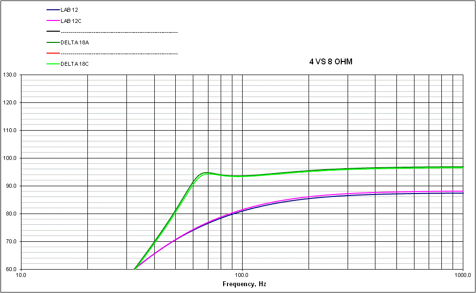

Well I looked at the specs of the 2 woofers listed, the LAB12 and the Delta 18 in their 4 & 8 Ohm versions. If one goes by the T/S parameters listed, they are basically identical at 1W. Of course it takes more voltage to achieve that 1W in the 8 ohm versions, no surprise there.
Plotted from their T/S parameters, please see graphs below at 1W.

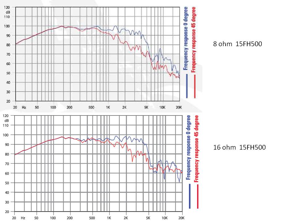

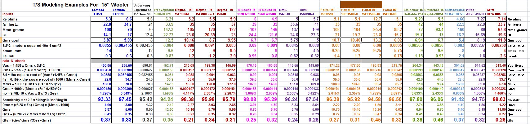

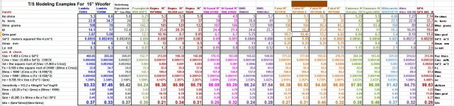

The table compares the T/S parameters for the 8 vs 16 ohm version of the Faital 15FH500 WOOFER. Frequency plots also attached. The Faital 8 ohm has Le=1.3mH Qts=0.31, the 16 ohm has Le=2mH Qts=0.45 in the specs.
When using a 15" driver as a "midbass" a low Le is often considered desirable, and this is why there are many Lambda TD15M (0.3mH) fans. I use the Beyma CP380/M 1" polyester diaphragm compression driver - worth a look.

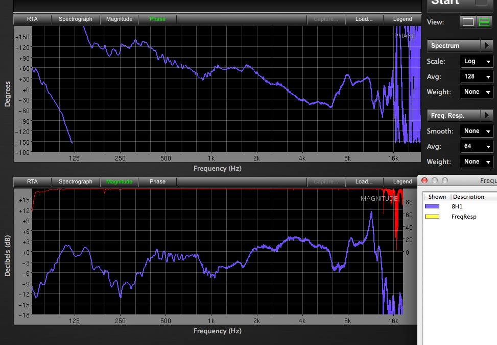

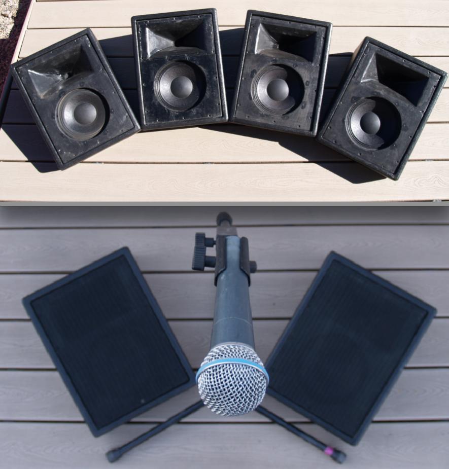

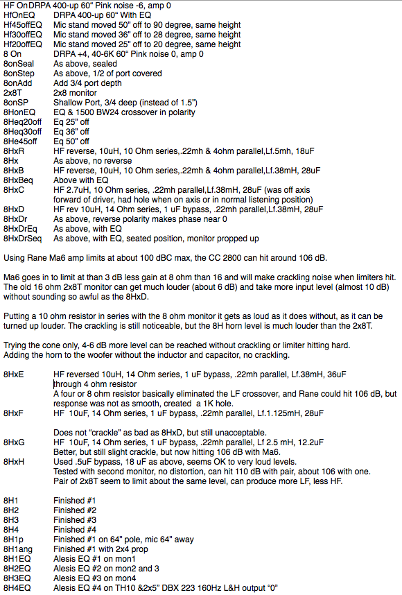

Below are the tests and revisions I went through for creating a passive crossover using an Eminence Alpha 8" and a Eminence PSD2002 on my 90x40 constant directivity horn. Although all of the dozens of Eminence woofers I have tested are remarkably consistent in frequency response, none of their HF drivers I have owned (PSD2002 and APT) have had consistent response.
Not to bore you with the entire blow by blow report, but at revision "Dr", thought the crossover design was done- it had flat frequency and phase response through the 1300 Hz acoustical crossover region. It played fine using a Crest CC2800 amp, but the Rane Ma6 amp I planned to use with the monitors couldn't handle the load without making horrible cracking noises when it hit limit.
After four more revisions, got a frequency and phase response not quite as good as revision "Dr", but could hang a pair on a channel of the Rane Ma6 (about 75 watts per cabinet) and hit 110 dB at about 6 feet outdoors, good enough for the more quiet and gentle life I lead having retired from pro "sound by the pound".
Art

Art. It took me quite a few seconds to figure out the photo with microphone. At first I thought they were tiny speakers. LOL!
