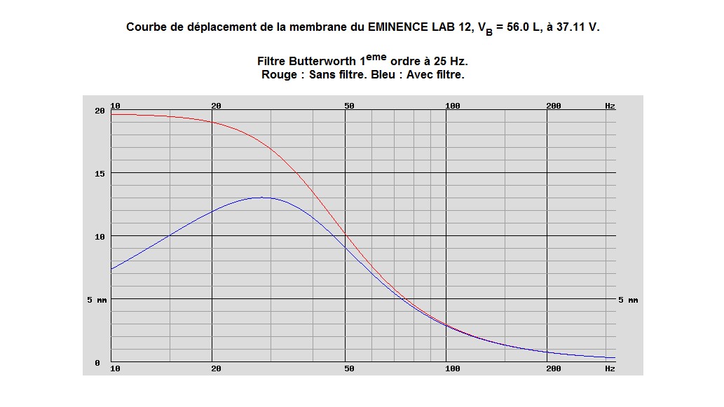

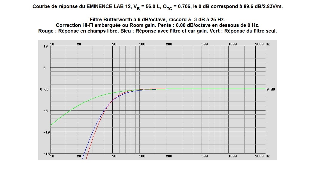

Yes, in fact the Dayton Audio RSS315HF-4 needs slighter bigger enclosure than the Eminence LAB 12 (the Eminence Lab 12C High has also less LF extension) on a sealed 2ft³ = 56.6L.
http://www.oaudio.com/docs/manual_v1_6.pdf
http://www.eminence.com/pdf/LAB_12.pdf
(specsw) amp: 325W RMS (into 8Ω load @ <0.01% THD)
Setting the filter to 25Hz (2)
F3 = 48 Hz - (with filter on) 320.9 W (2): pic of freq and excursion shown below with filter activated.
F3 = 43 Hz - (no filter) (1)
(1) amp@listening levels/power, (2) amp using@max power

I wish I could find an Oaudio bash amp, I believe they went out of business a few years ago. I already have a 500w bash amp from PE. Oaudio had a parametric EQ and adj subsonic filter, the PE version is fixed. as far as the graph I cant read whats at the top.
ah I see thats pretty close to what I got with winisd and another program that uses excel. I was going to buy a 300w a/b amp and turn it up all the way but I already has a 500w bash amp from a prev project I will probably use. if I set the amp gain to 12 oclock (250w at 4ohms) how would that correspond to driver at 6ohms?
You don't need filter if not abusing it, I would say.
F3 get's lower.

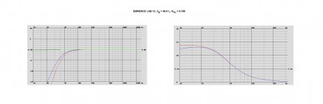

You can have the amp measured for max. speaker output () but I don't think is necessary.

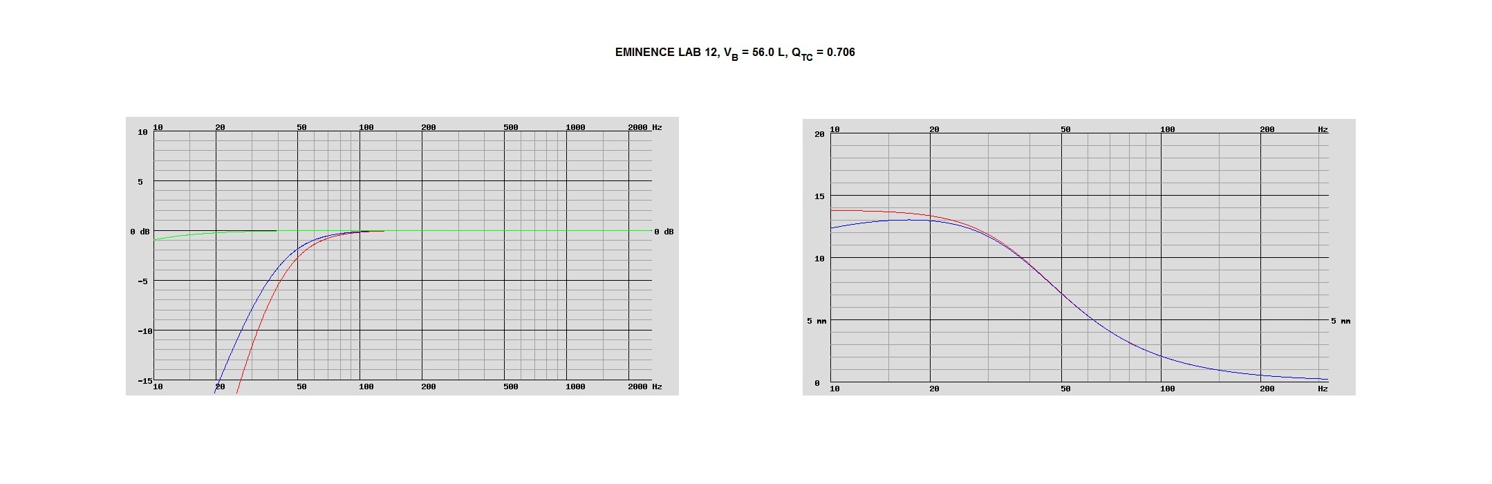

The Lab12 has a max excursion between 13mm to 22mm (Xmech) before destruction. 😀 😀 😀
