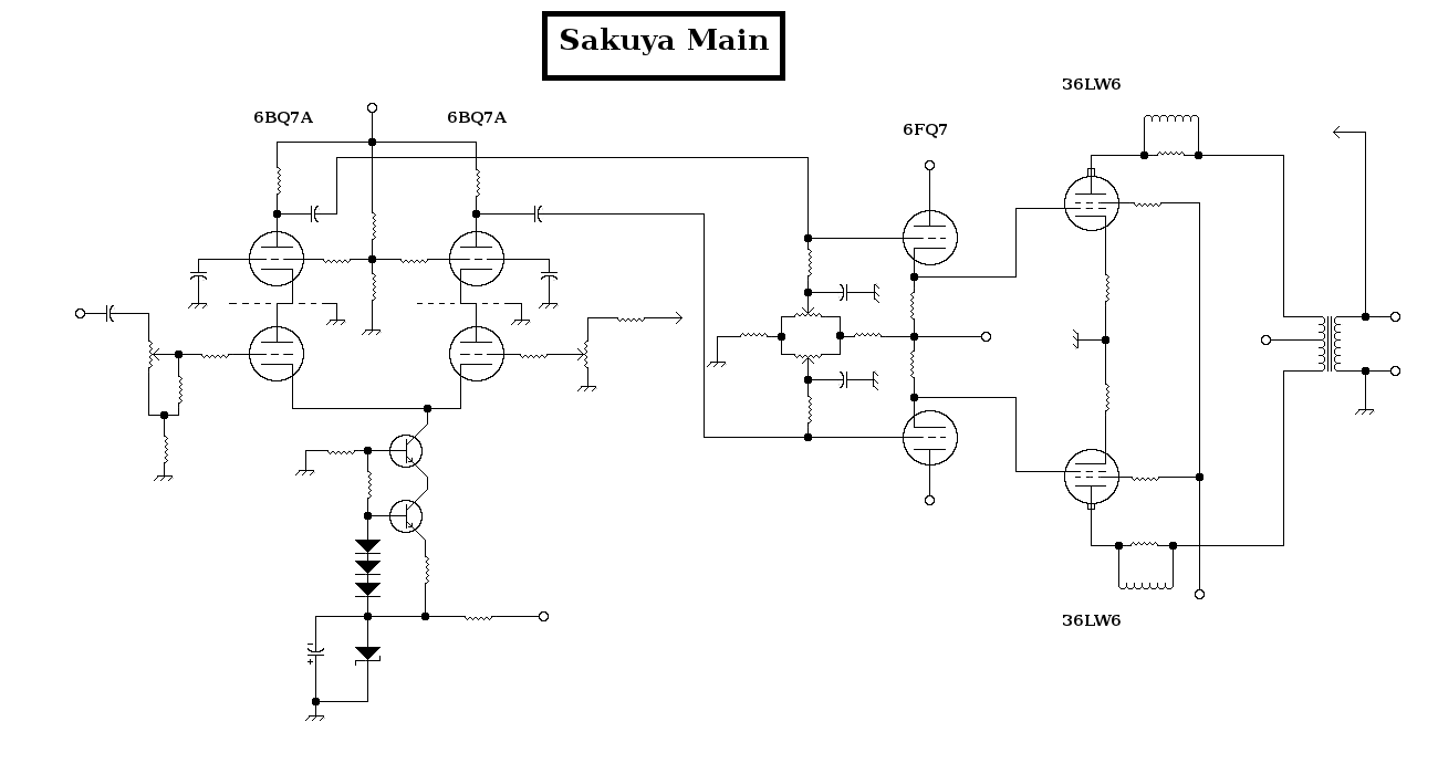

I have a preliminary design for a really big amp (attached). I have one NIB 36LW6 in my collection already, and some more on the way. Nice thing about this is that Edcor already has an OPT that'll work with these as a stock item. The peculiar heater voltage is somewhat problematic, but I figure I'll wind my own PTX for that: heater volts and a secondary for the negative rail voltages.
Another nice thing about HD VTs is that UL isn't necessary. These are linear enough so that all you need is some gNFB to take the edginess off and improve woofer damping. 6BQ6GAs sound as good as the famous 6V6, yet can out out almost three times the power.
Also, vertical deflection pents for color TV aren't bad either as audio finals. Some even include a small signal triode in the same bottle: integrated cathode follower grid drivers, or LTP use.
