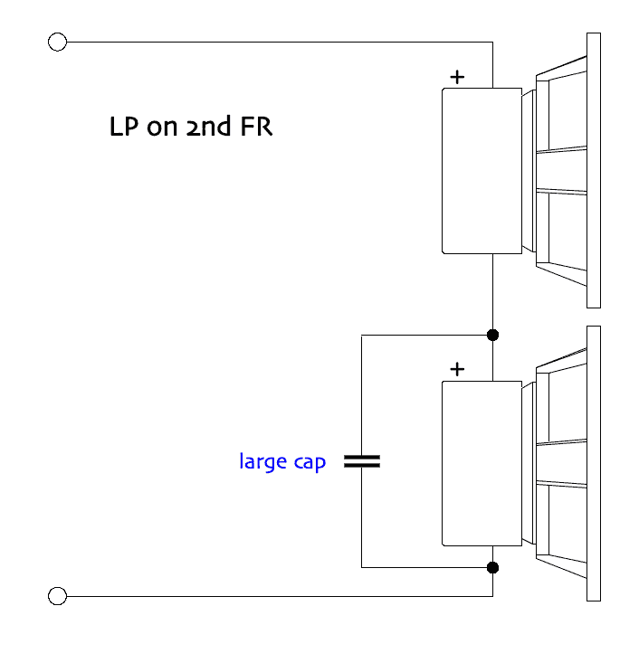

I think there might be a little confusion here. The purpose of a X.5 way is to reduce the mid and high out put from one of the two drivers.
A normal X.5 way is with the drivers in parallel with one of them having a coil in series and perhaps a shunting cap.
In a series crossover if you run a coil on one side to ensure the high end cut off of one of the drivers you have to put a resistor on the other side or you'll have a short. If you add the cap instead of a resistor, you've just made a normal series XO that divides between a woofer and tweeter and there'd be no point in using two of the same driver. You'd be losing the low end of that driver which effectively defeats the purpose.
I can't see why you want the cap in there. The idea of the 1.5 is to increase the bass.
The cap shunts hi-frequencies past the associated driver. To act as BSC one needs to use a current amp. With a voltage amp the increase in efficiency is countered by a factor of 2 decrease of power, so there is no lift.
dave
So something like this

If you wire 2 drivers in series, you use a shunt cap on one driver to cut its HF. One requires a current amp to get the power increase needed to get typical baffle step compensation. (ie with a (true) voltage amp you only achieve double the cone area at low frequencies, no gain in sensitivity)

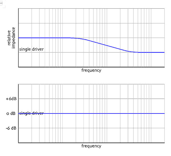

Hi dave, I'm sorry this is an old post. I'm having trouble understanding why there's no baffle step compensation if one driver really does have the highs rolled off, in a series connection with a cap on one driver. Wouldn't there be less highs then overall? I wouldn't bring it up, but this would work out well in my project if I could get the BSC this way. Thank you!
Have a look here — i am working on a revision of this document with this, the existing 4 driver, with added information as developed in the 3-driver wiring.
http://www.planet10-hifi.com/downloads/Dual-Driver-Wiring.pdf
In short, with a voltage amp, one gains 3dB due to the doubling of the drivers, but -3dB in power being delivered so the net is zero.
So at higher frequncies you are delivering N Watts, at LF you only have N/2 Watts.
dave
No. Series wiring does not do the same thing as using a 2nd driver as BSC. That requires a rise in output at low frequencies of 2-6dB.
It just doubles the cone area, greatly increasing LF output, but without the hassle of BSC (very often causing as many issue sas it fixes).
dave
I can't understand why there are not less highs though if the highs of one driver are rolled off. I understand there will be no +3db like with parallel, but if there's a high cut of one driver, why is there the same amount of highs..?
I don't get it. Why does the value of the cap matter, if there is no change in the frequency response?
The size of the cap in this config is not overly critical, its choice needs to be made to suit the application and needs to be large enuff that the LF driver does not come in until the driver centre-centre is less than a quarter wavelength.
