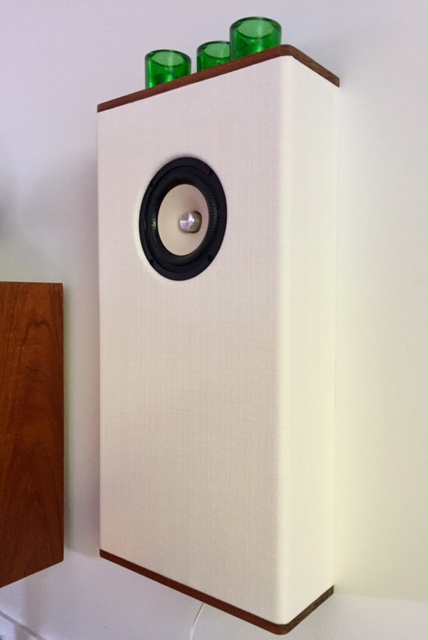

I would love to try a pair of W5-2143 in something like the Castle style microTowers but I lack the tools and knowledge to execute. So I just have to rethink my strategy and get back to my initial problem. The lack of SPL and low end when using the W5-2143 in a bog standard vented box.
I stumbled over Srednivashtar's wonderful dual PA130-8 XKi in my search for an alternative solution. A really inspiring project so I might try a dual W5-2143 XKi or another spin on the Karlsonator instead...

If you are looking for more bass especially more "slam" in the 80-200 Hz range, a 5" wide-band driver will probably not satisfy you even if you do a Castle style cabinet. In my experience, even with wide-band driver-cab combos that dig pretty deep and sound decent with electronic music, the performance on rock music was not particularly good.
The up-firing Micro-Towers give a different and more spacious sound-stage, but perhaps at some cost of the point-source imaging that a single FR driver offers.
