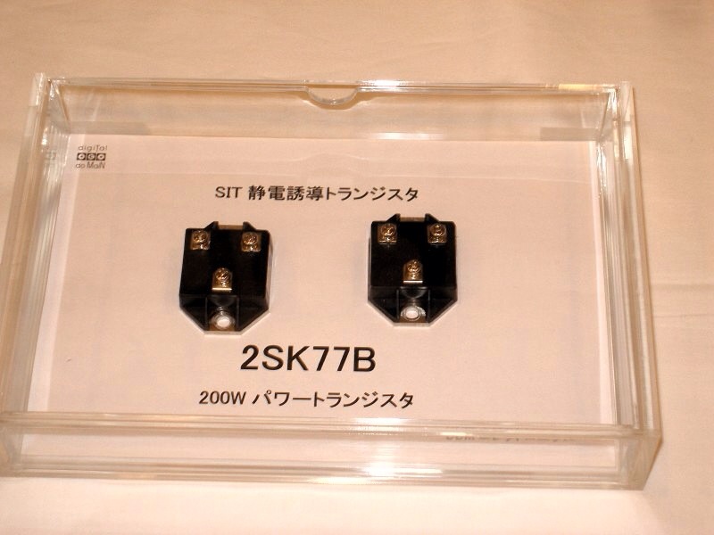

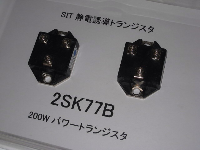

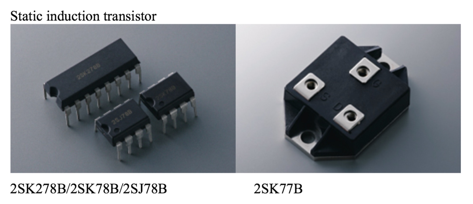

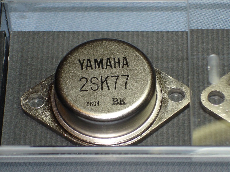

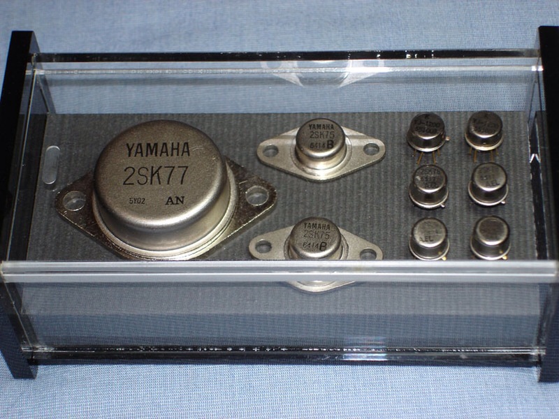

6moons article have typo on first page is not 2SK278B but 2SK77B made by Digital-Do-Main. Yamaha name was short 2SK77.

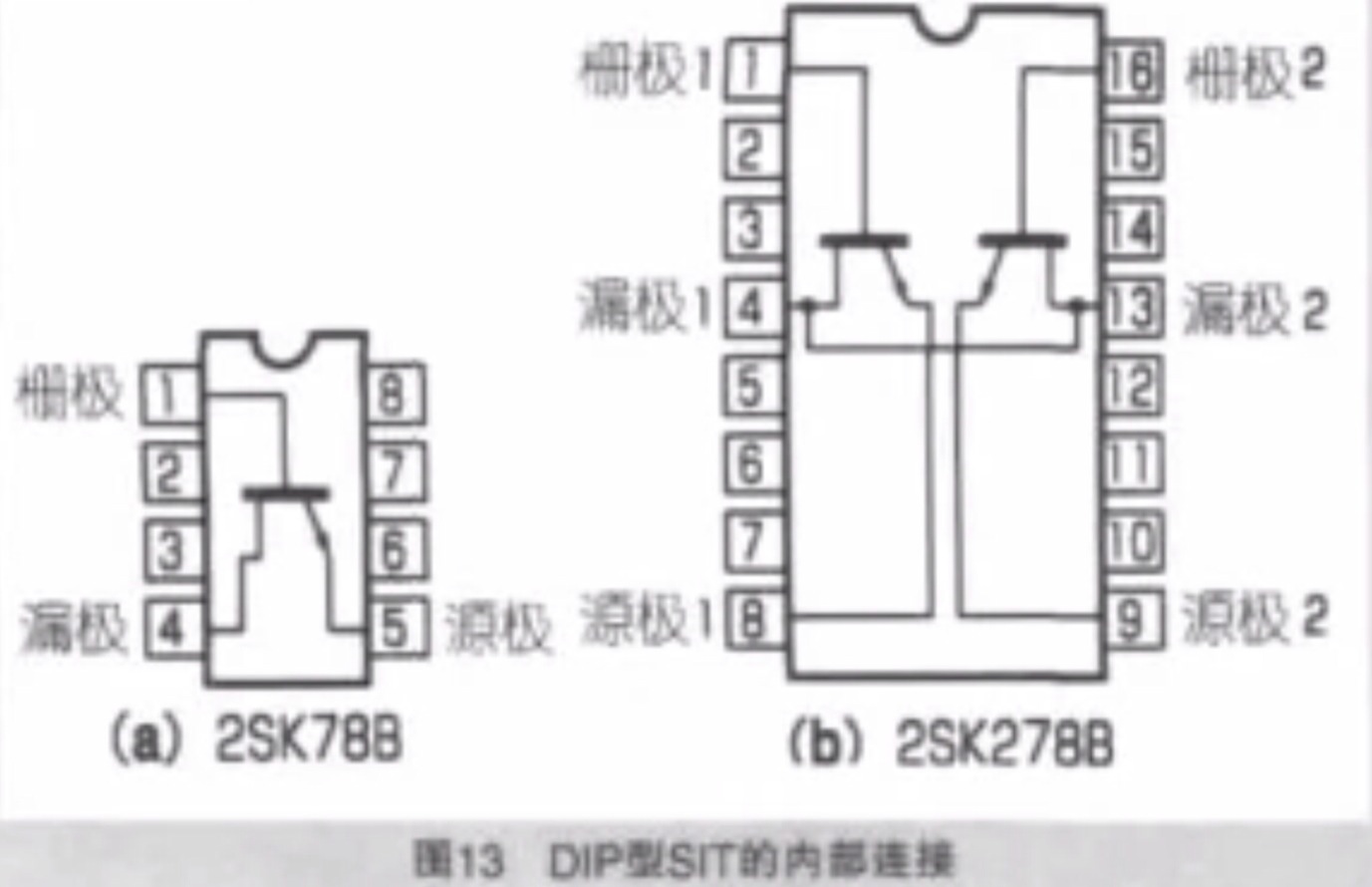

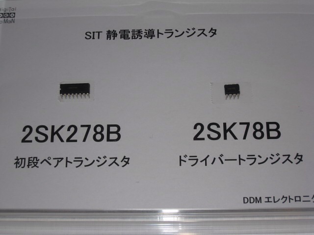

2SK278B are small signal SIT's in IC packaging format 😀

6 mons SIT-3 article describe DIP package reference SIT's but on the photo show hockey puck 2SK77B
that make small confusion 🙄

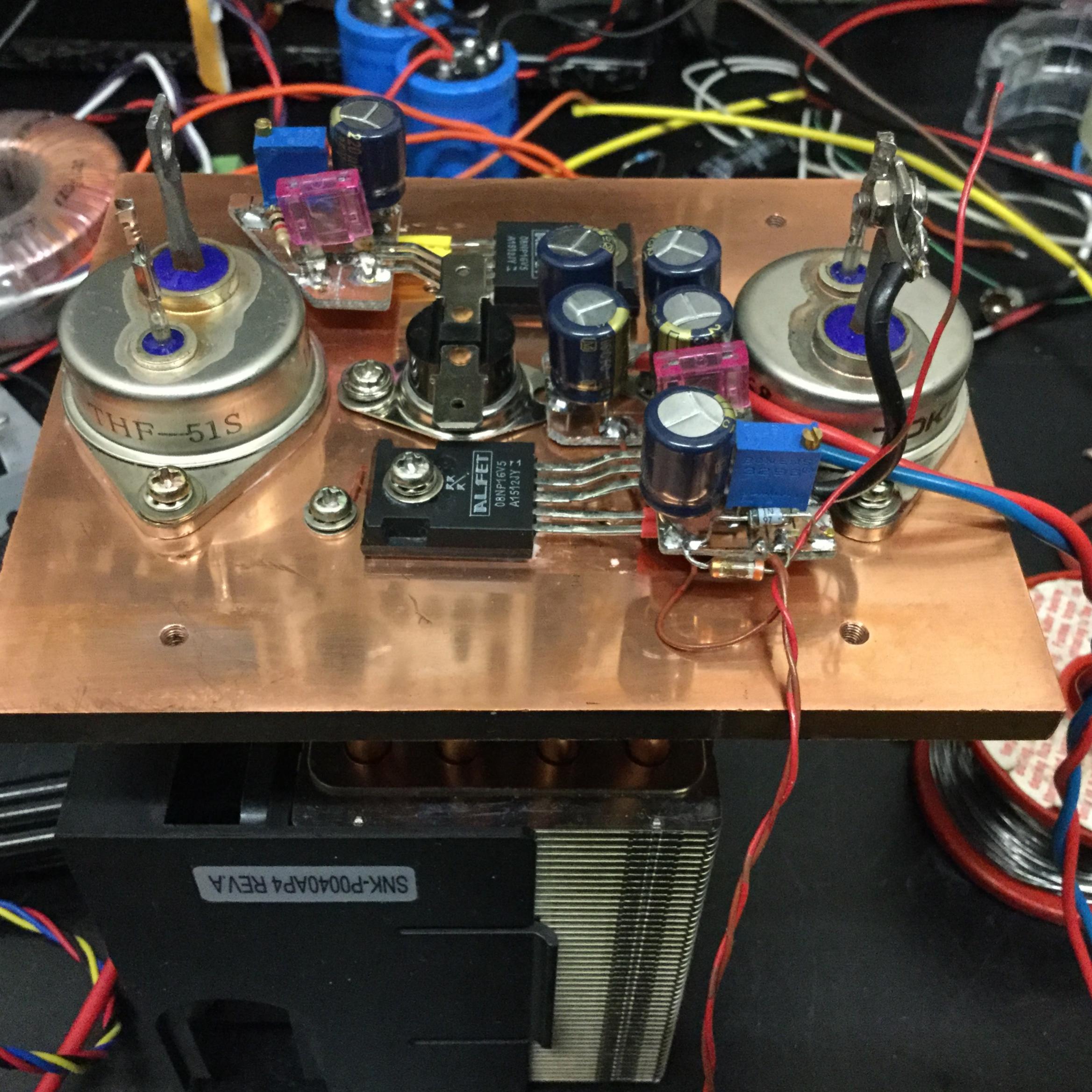

Obtainium THF-51S

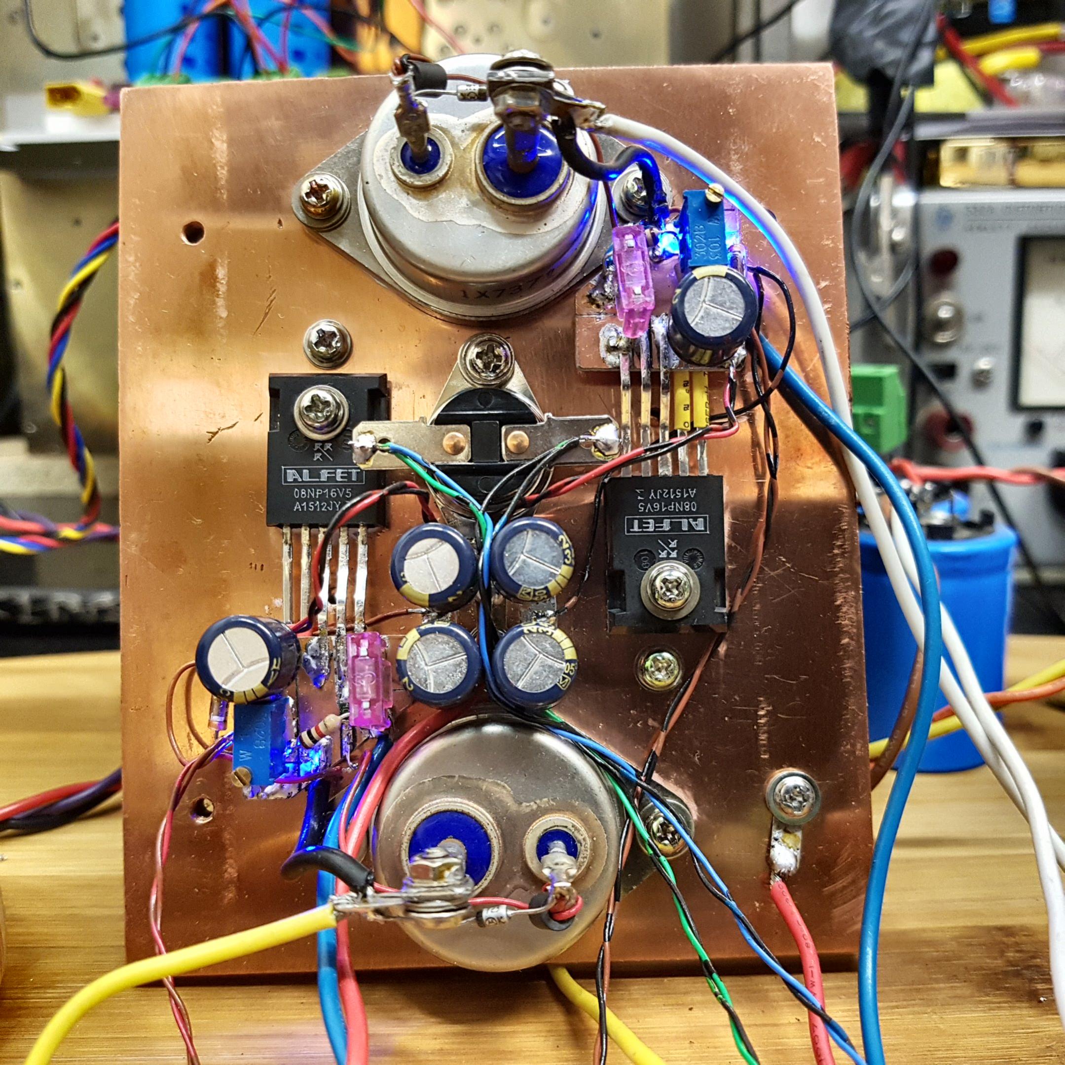

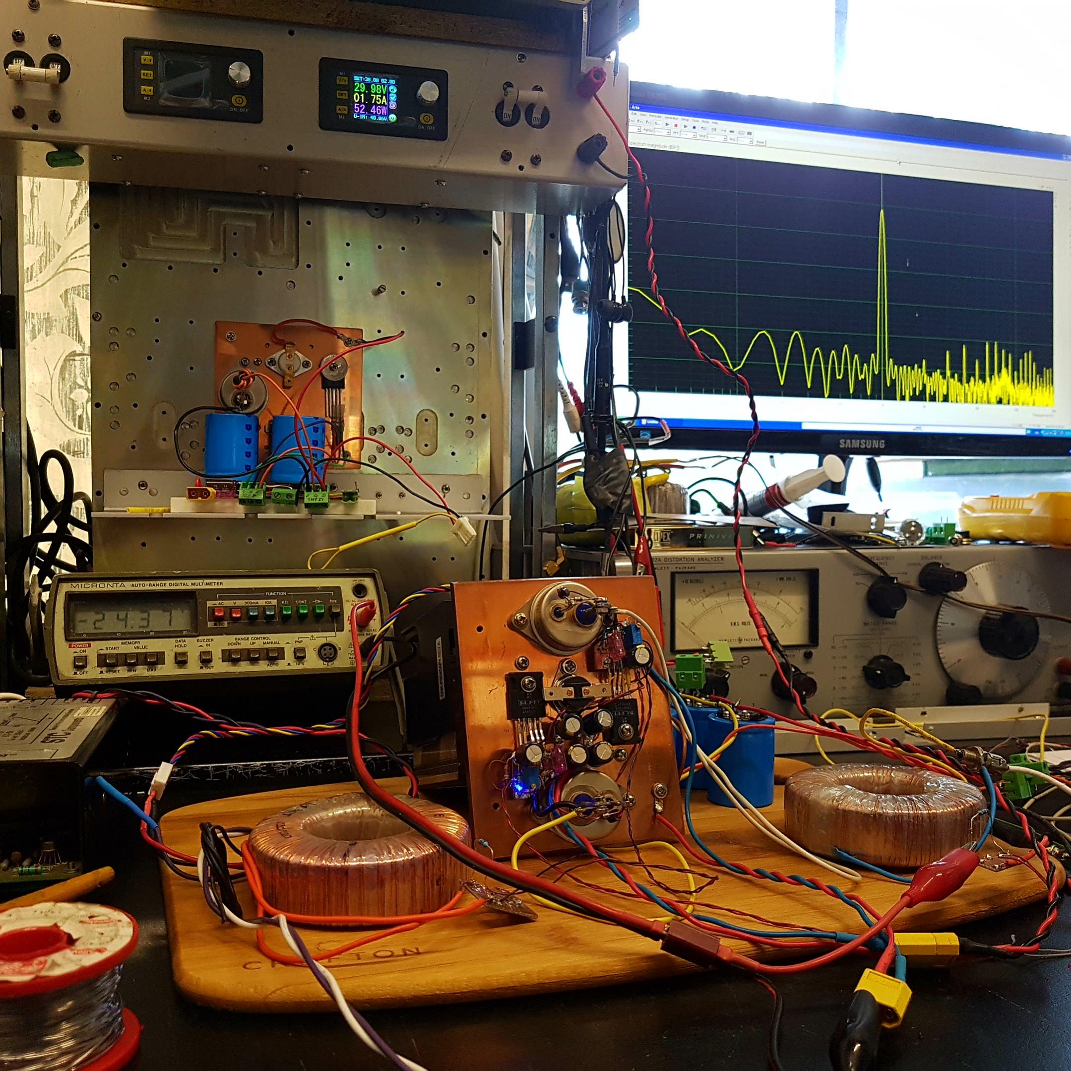

Many thanks to Antoinel and my gratitude to Mr Pass, here is my SIT-3 approach as an amateur.

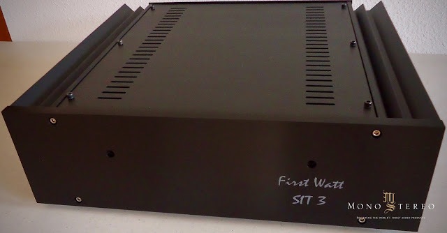

SIT-3 photo from short article on this web page
Mono and Stereo High-End Audio Magazine: NEW FIRST WATT SIT-3 STEREO POWER AMPLIFIER
