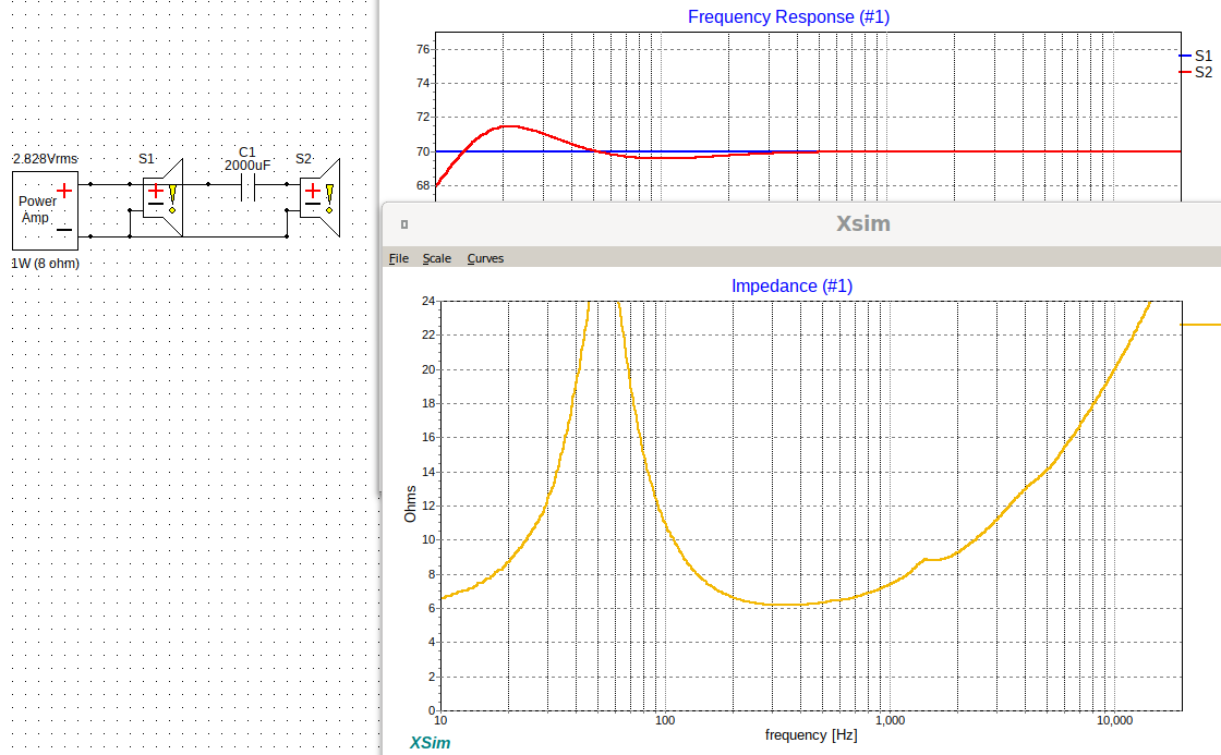

How it works, is if you have an undersized closed box for a bass driver, say like 20L for an 8" bass, you can dig a bit deeper and steeper on bass by adding a big capacitor:

Yes, a large capacitor reduces the rise in frequency response of the woofer near its resonance. That is, it works as a 1st order high pass filter.
For example, a 200 μF capacitor will work for an 8 Ohm woofer from a frequency of 50 Hz : below 50 Hz there will be a smooth falloff, above 50 Hz - an even Qtc.

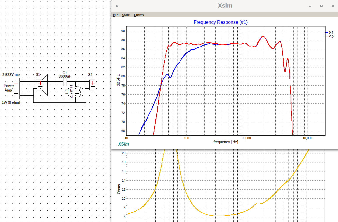

Correct. It can also be done second order for a 24dB/octave rolloff.

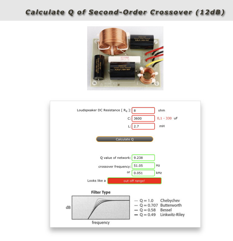

Could you please let me know the calculation method? I had put the values of components shown in online calculator, and it gave the results on attached. Q are out of range, but that might be fine since we would need the boost at cut-off region. Is it required any specific method for selecting Q?
