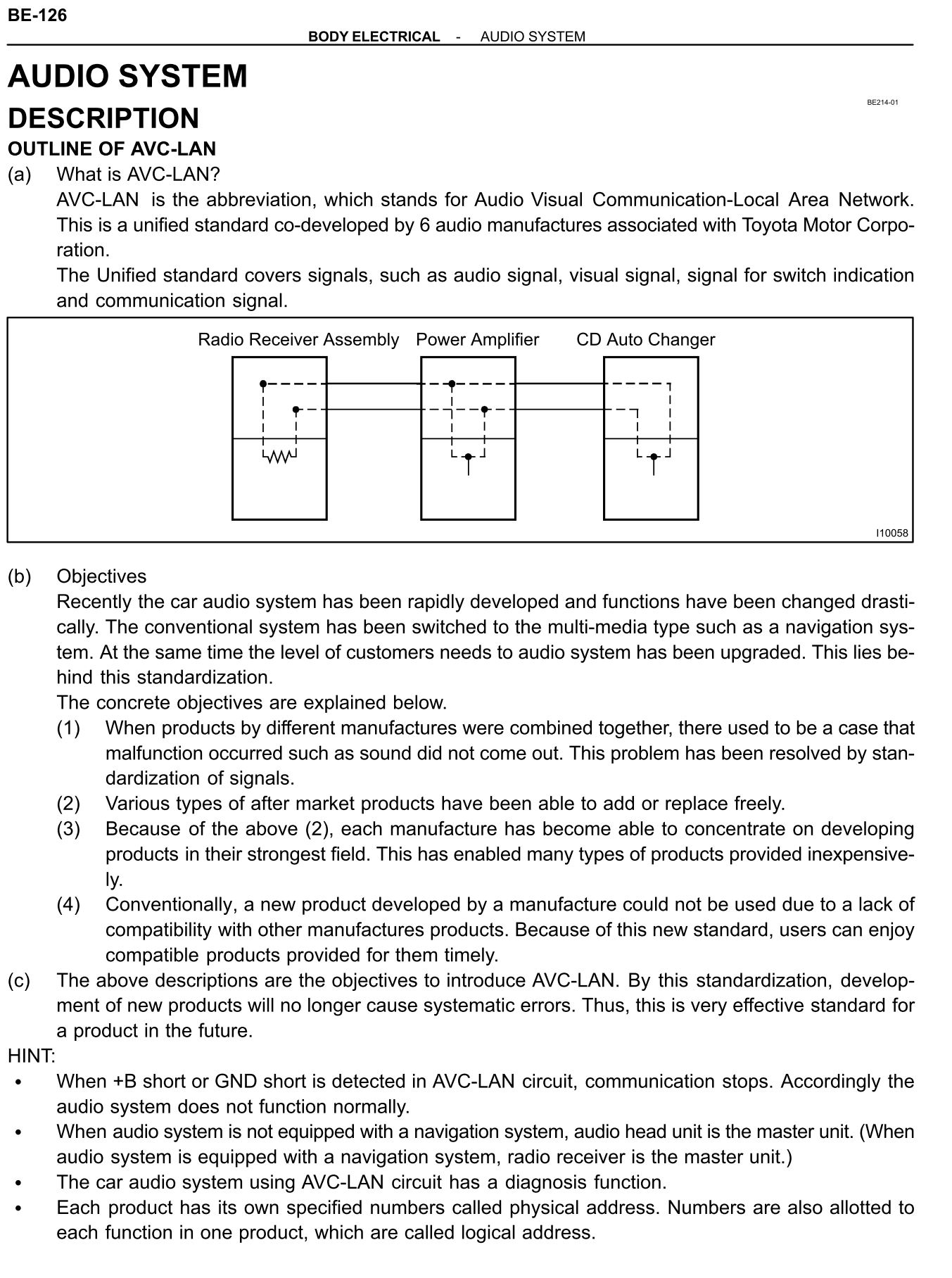

After reading a part of the Avalon's service manual I decided to try re-assembling the unit to see if the unit wasn't powering on due to not being connected to the car's 'AVC-LAN' (attached).
No luck, I believe I may have misinterpreted the manual because I now recall reading on toyota forums that owners experienced problems with the factory amplifier being 'blown' but the HU would still power on.

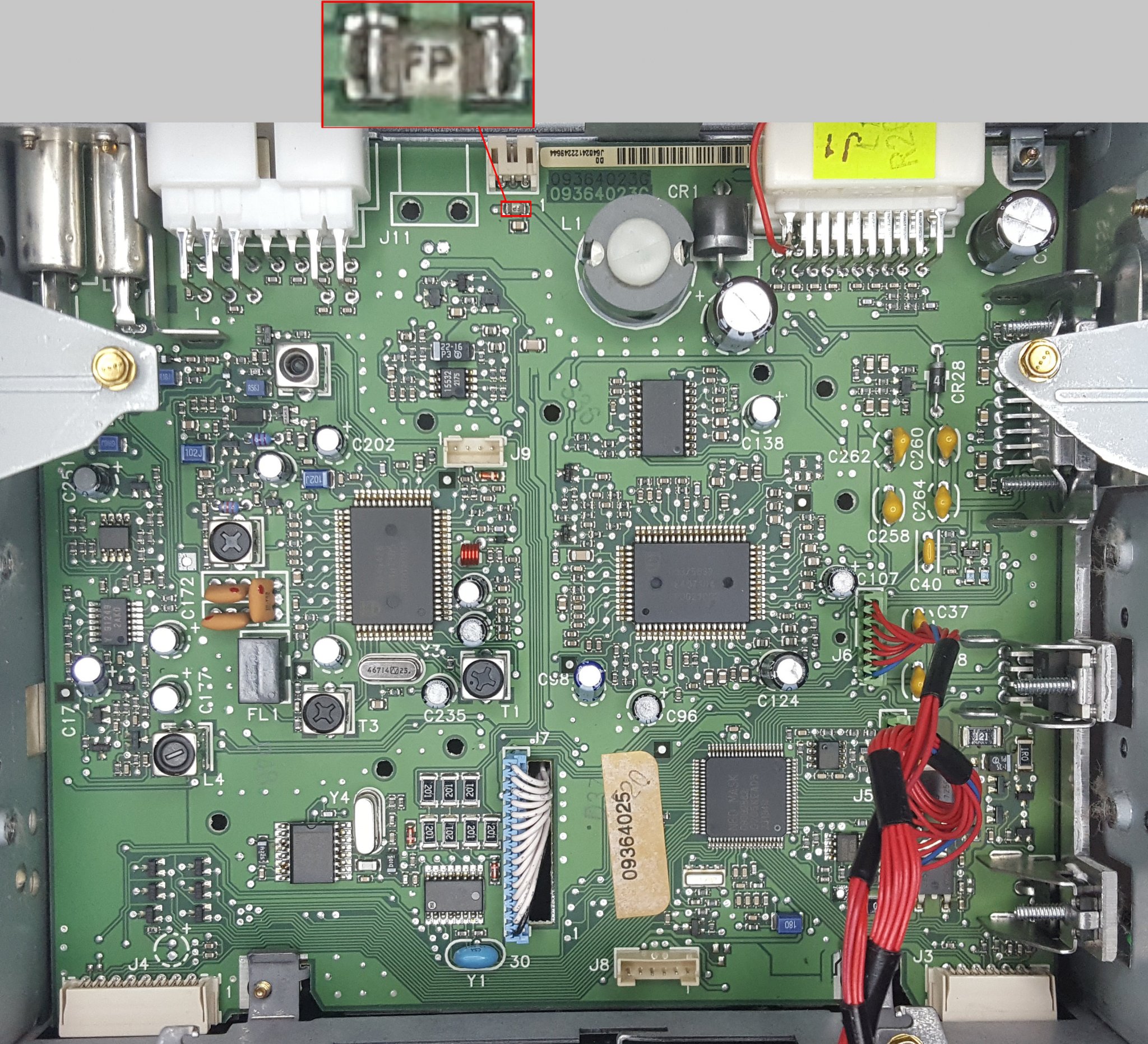

By SMD with amps marked I assume you're suggesting an SMD fuse? I did find what I believe was a fuse, an SMD labeled "FP"
Researching it returned results that it is a 'Littelfuse' branded component. I measured continuity across it, it had continuity.
I also checked voltage across it when it was powered: 12V on both sides.
I seen no other similar fuses nor any with amps marked on them, will give it another look.
Attached pic of the fuse and it's location -- not a very good picture just clear enough to show the location of the component.
