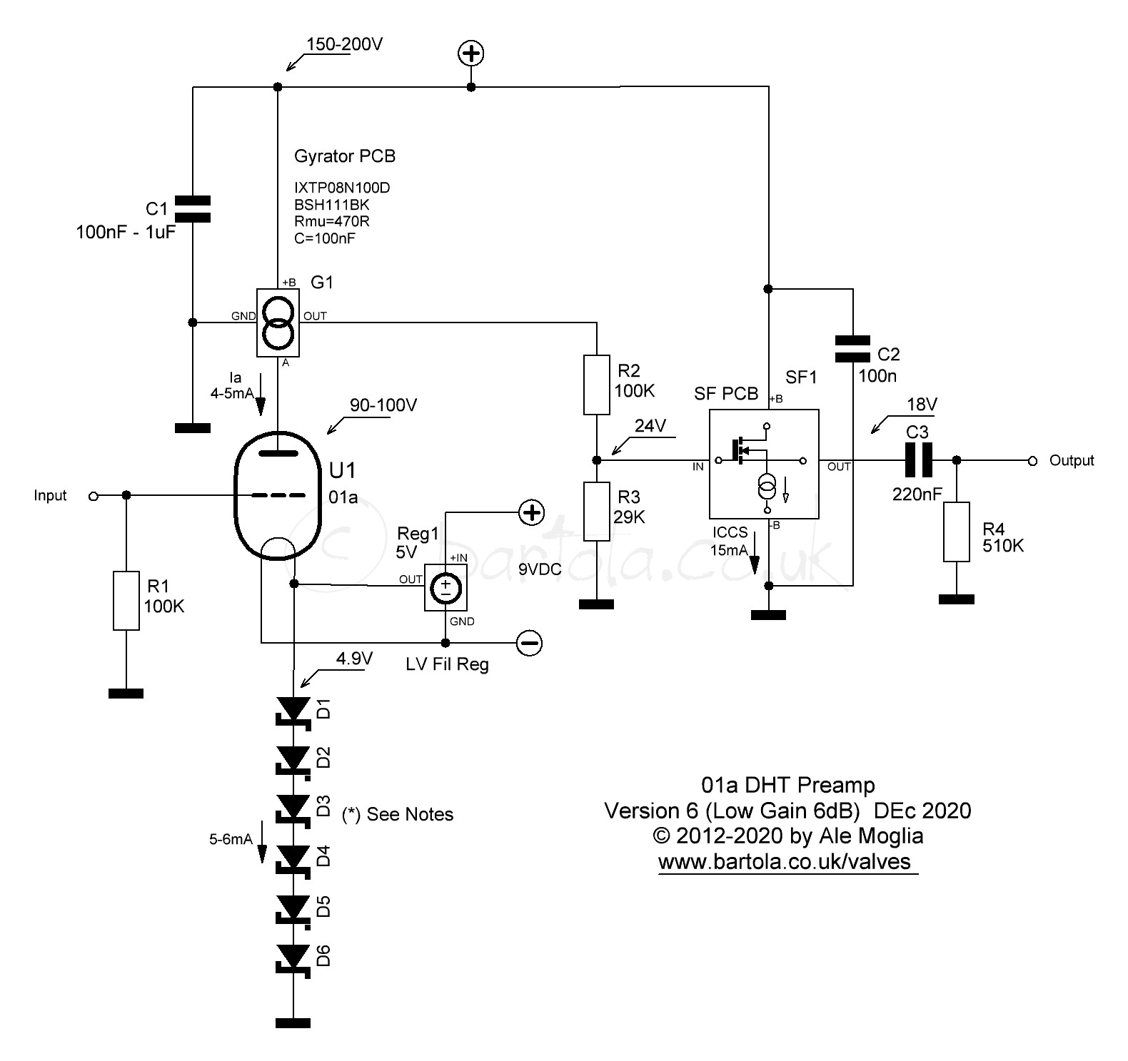

I am starting to build 01a preamp and I can not find any information if filament pin1 is positive or negative or it does not matter? Other thing is that if I use Rod Coleman V9 regulator with 6 sic diodes connected to the positive side and sic diode cathode to the overall amp ground (not regulator - negative?)?
Like in this picture?
I built the Bartola 01a line stage a few years ago. Never got the hum controlled. Have a few ideas and will get back to it one day. Good luck with yours.
Connect the diodes to the negative side, with the V9.if I use Rod Coleman V9 regulator with 6 sic diodes connected to the positive side and sic diode cathode to the overall amp ground (not regulator - negative?)?

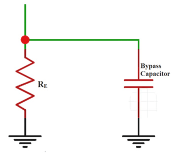

What value resistor and bypass capacitor to use with CX-301a? So the connection would be as shown in the picture?I think it's worth comparing the sound of a good resistor - like the excellent non-inductive (Ayrton Perry wound ) Ohmite WNE, with a DC link bypass capacitor, against the diodes.
Only 5W rated Rod?Connect the diodes to the negative side, with the V9.
It's not filament biased version, so via resistor (or diode string) only the tube cathode current (few mA) flowing.
SIC diodes sound edgy and unpleasant on music like classical and opera. I tore them all out and used good resistors and DC Link caps. Filament bias is even better.I think it's worth comparing the sound of a good resistor - like the excellent non-inductive (Ayrton Perry wound ) Ohmite WNE, with a DC link bypass capacitor, against the diodes.

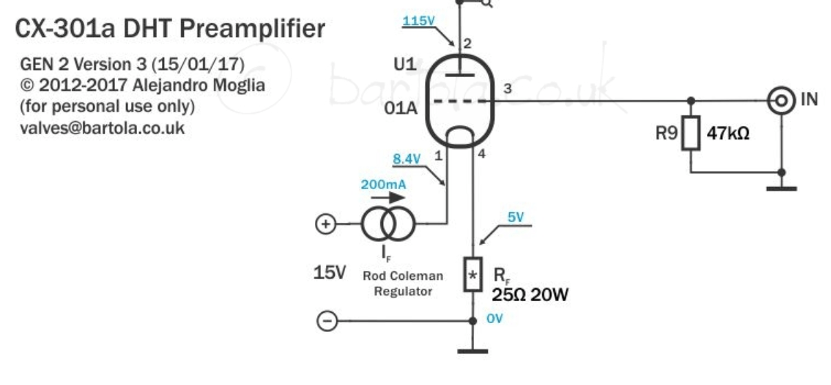

Filament bias is perfect for 01A stages (only burns ca. 1.2W in the resistor), but you need to change the DC input voltage to 14 - 17V, to get the same 5V bias.
If you can make up 20 to 22 ohm with available Ohmite WNE resistors (parallel preferred) that will be well worth listening to.
The Ohmites are industrial resistors, made with high quality materials and construction, including copper leads, & Ayrton Perry winding .
They should be able to challenge most audio types IMHO
If I use 20 ohm resistor then I connect it like in this schematic? What would then be a good bypass capacitor for that?

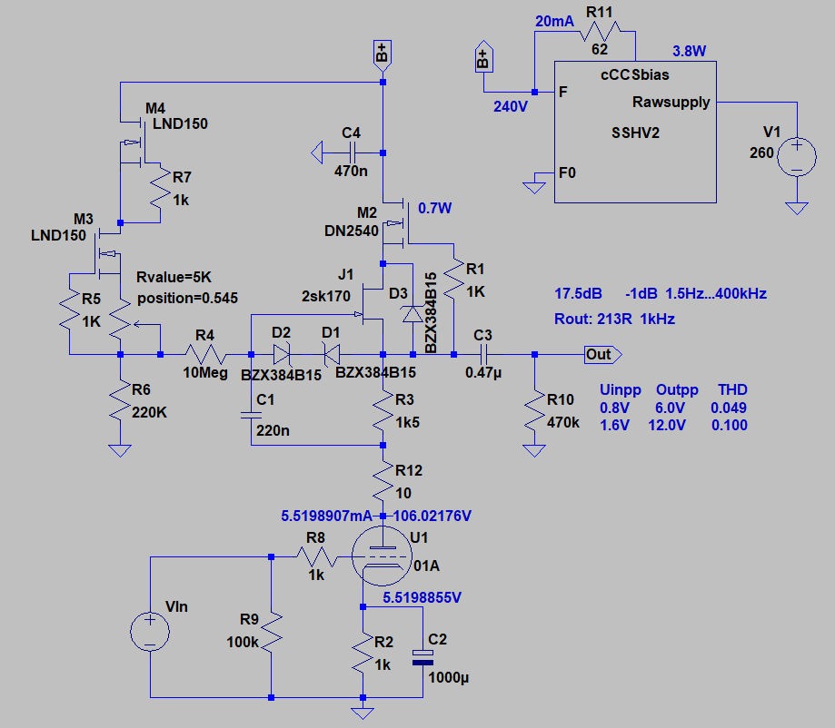

@euro21 Why are you using in the #712 post in filament 1k resistor R2 with 1000uF if others use only 20-25 ohm resistor? What is the difference? In this schematic pin 4 is used as positive voltage from regulator and pin 1 is flowing to ground through resistor and cap?
In post #704 the schematic shows cathode biasing.
In the #715 it's filament biasing.
Another animals. 😉
Another animals. 😉
Yes, for filament bias, connect it like that. No need for a bypass capacitor: with filament bias, the Rk of 20 .. 22 ohm is low enough already.20 ohm resistor
BTW, low filament current is not recommended for long term use. At 200mA, the 01A might only live for ca. 100 hours. You can adjust the filament current to get 4.75V on the socket, but lower than that is not good.
