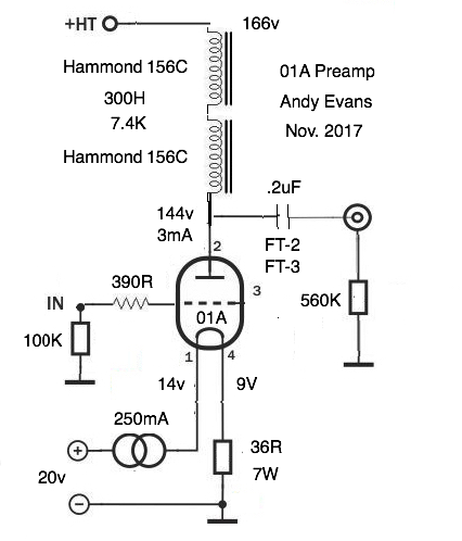

I think Ale has answered you pretty well here. I'm on a plate choke expedition right now. I've been putting 2 of the Hammond 126C interstages in series and getting much better sound than a single one. Works nicely with the 10Y, and I really must try it with the 01A. I may also invest in an amorphous plate choke at some point. Will report the results if and when.
My plate choke quest has taken me back to an old friend from 8 years ago - two Hammond 156C in series. These are fastened bottom-to-bottom and connected out of phase. I was originally using these with the 26 which is another option, but this time I used 01As. I think I gave up on this before because I was getting hum. This time - miraculously - no hum at all.
This is good news for me, for a start, because I have several of them. And also because they sound really good. We have 300H here, so no shortage of Henries for the 01A. Sound is very clear and detailed. I've been using 2 x 126C in series with the 10Y, and I'll also try that with the 2P29L. They're good too and they can take 15mA instead of the 8mA for the 156C. Not much to choose between these options in terms of sound - both very good. I've just got this up and running so extended listening will tell me more, but I'm pleased with this. These chokes are also really, really cheap to buy. Nice result!

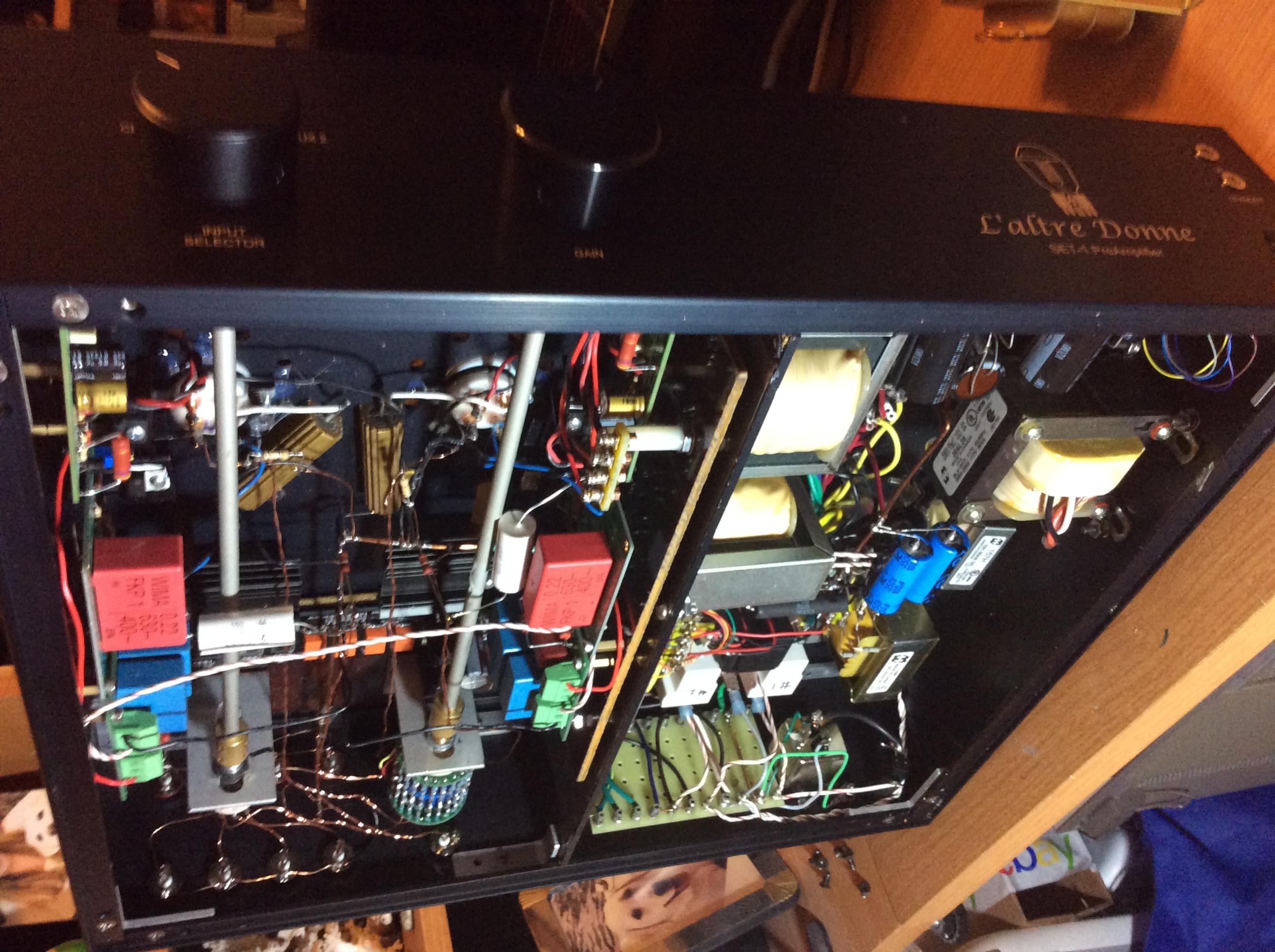

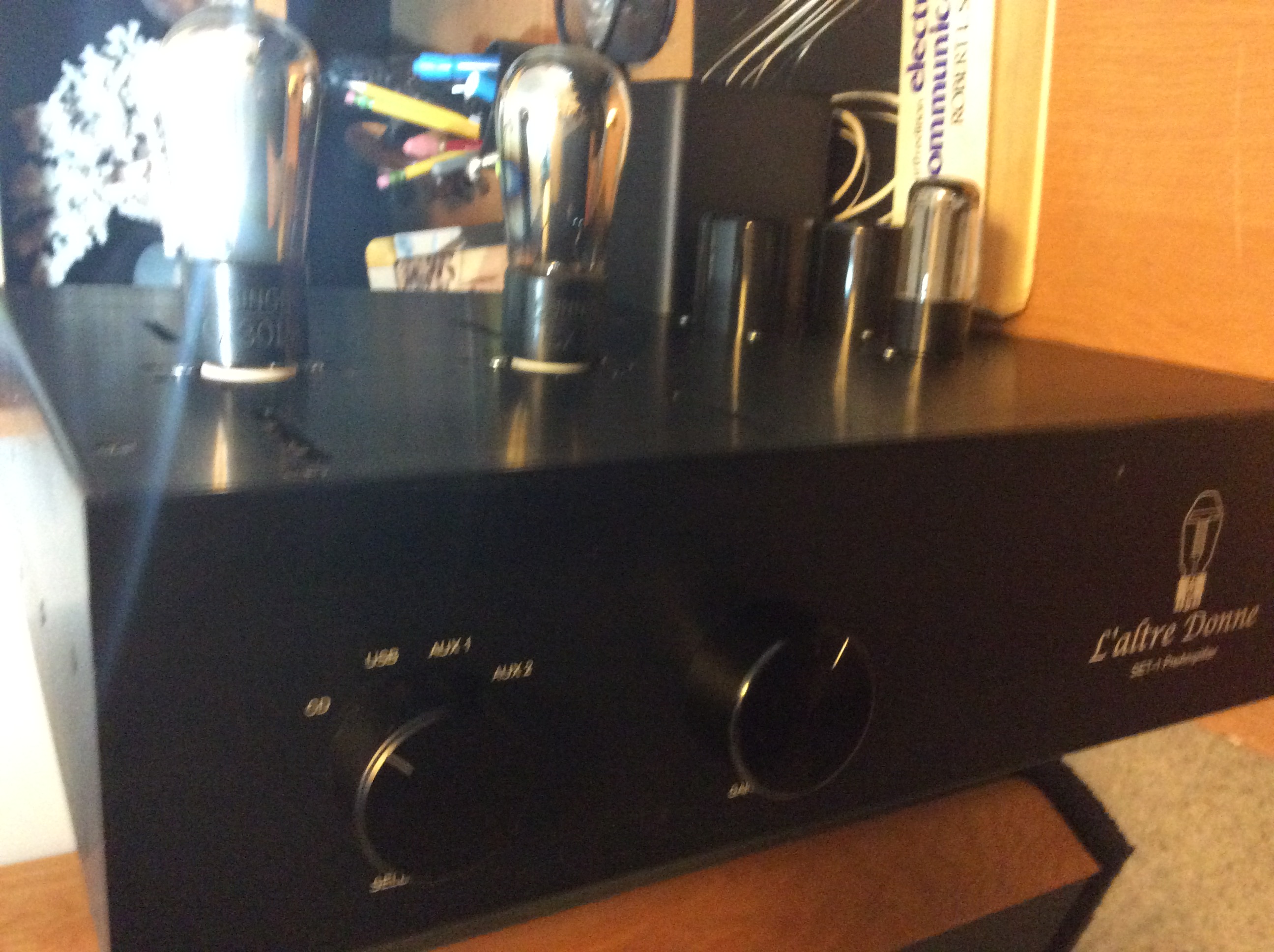

01A preamp completed
First and foremost, thank you Andy and Ale for all your help. The 01A is a beautiful sounding preamp but very difficult to keep quiet. I purchased several tubes(globes) just to find a couple that were not microphonic. The ST tubes however are very quiet along with the 112a tube. My next mod is to remove the resistive pot at the input and install Dave Slagles AVC at the output of the preamp. This should definately bring this preamp to new levels. At unity gain, it will also give me about 600ohms out which is great news for driving longer cables. Also, at 140Henry, the bass is still very good according to my LTSpice model. As of now, this preamp smokes my Audio Research SP6, cant wait to hear it with the AVC!

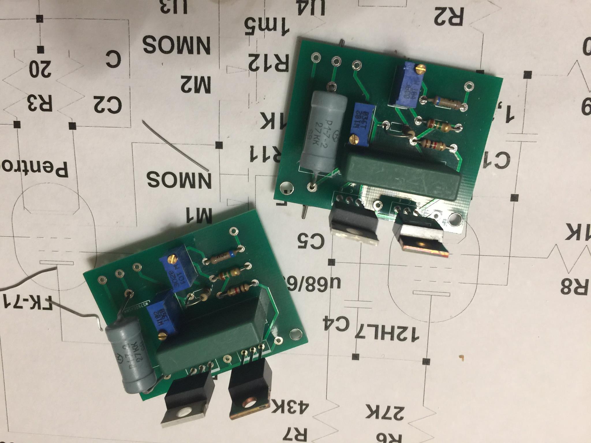

Here is the best way to go into A2 territory:
