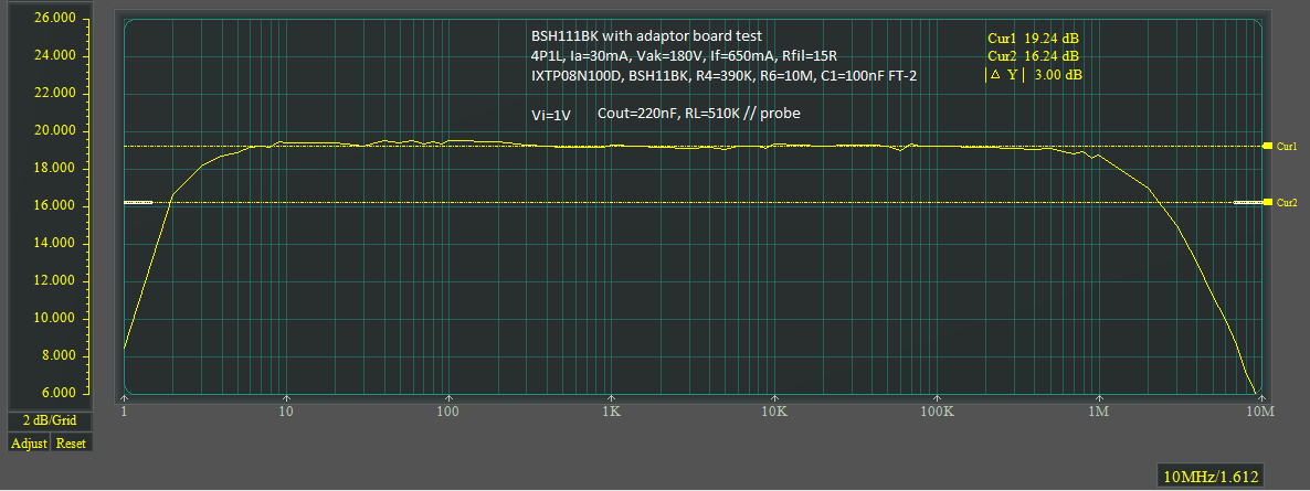

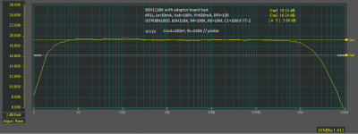

Someone over on the Wigwam mentioned this, gyrators acting as RF generators. Is this relevant, or even true? DIY Audio Projects Forum • 300b preamp
No, I think they have misinterpreted that the resulting hybrid mu-follower stage (i.e. gyrator load) has very high bandwidth. If layout is poor and/or the right measures are taken (e.g. grid/screen stoppers) it can oscillate when unstable. With the 4P1L this can be done easily on the bench by placing the voltmeter probes in the anode. If you add ferrite beads/stoppers then there is no problem.
Have a look at the frequency response in the attached. Loading it with 100k just impacts the LF response, not the HF.
