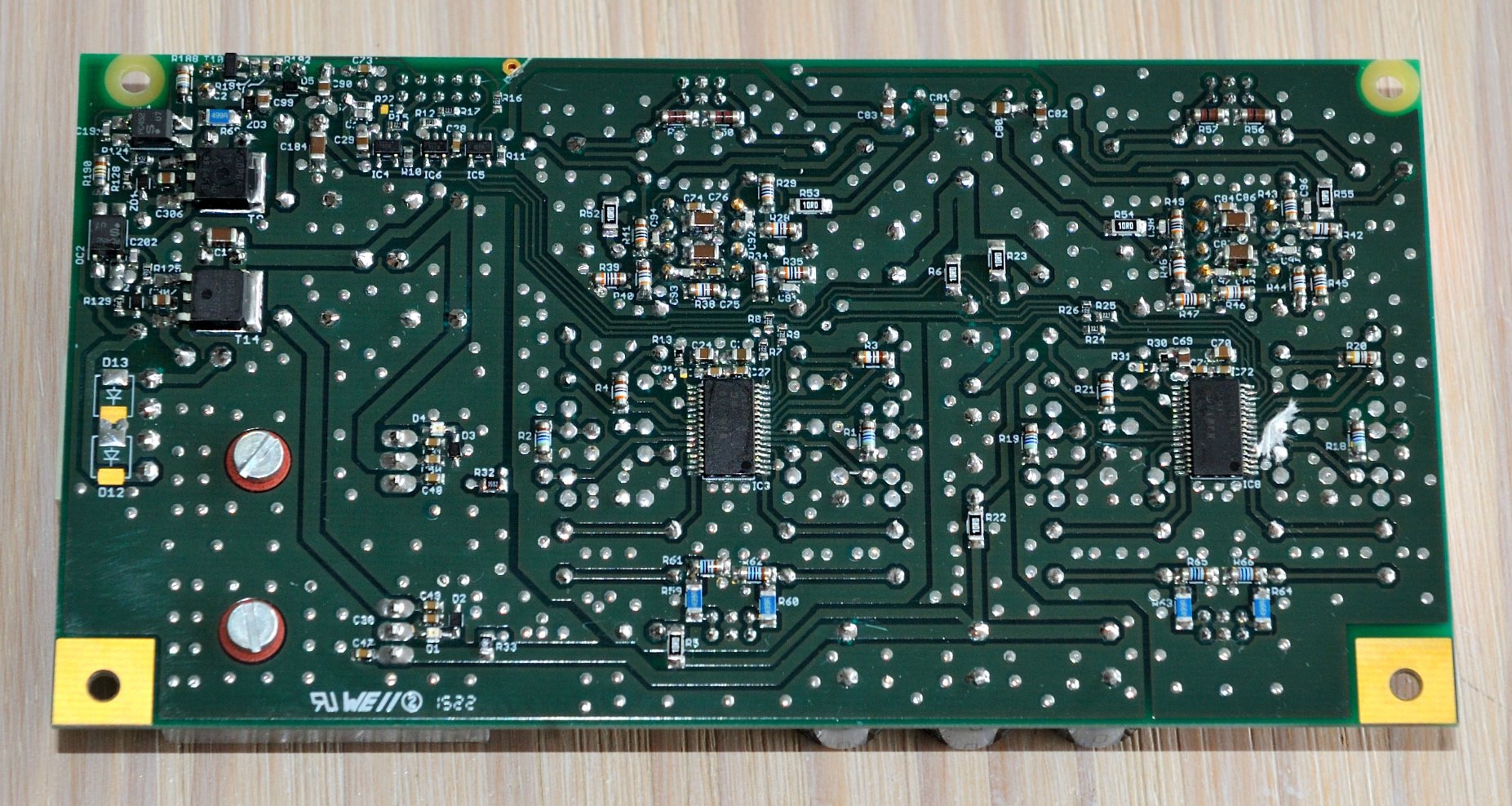

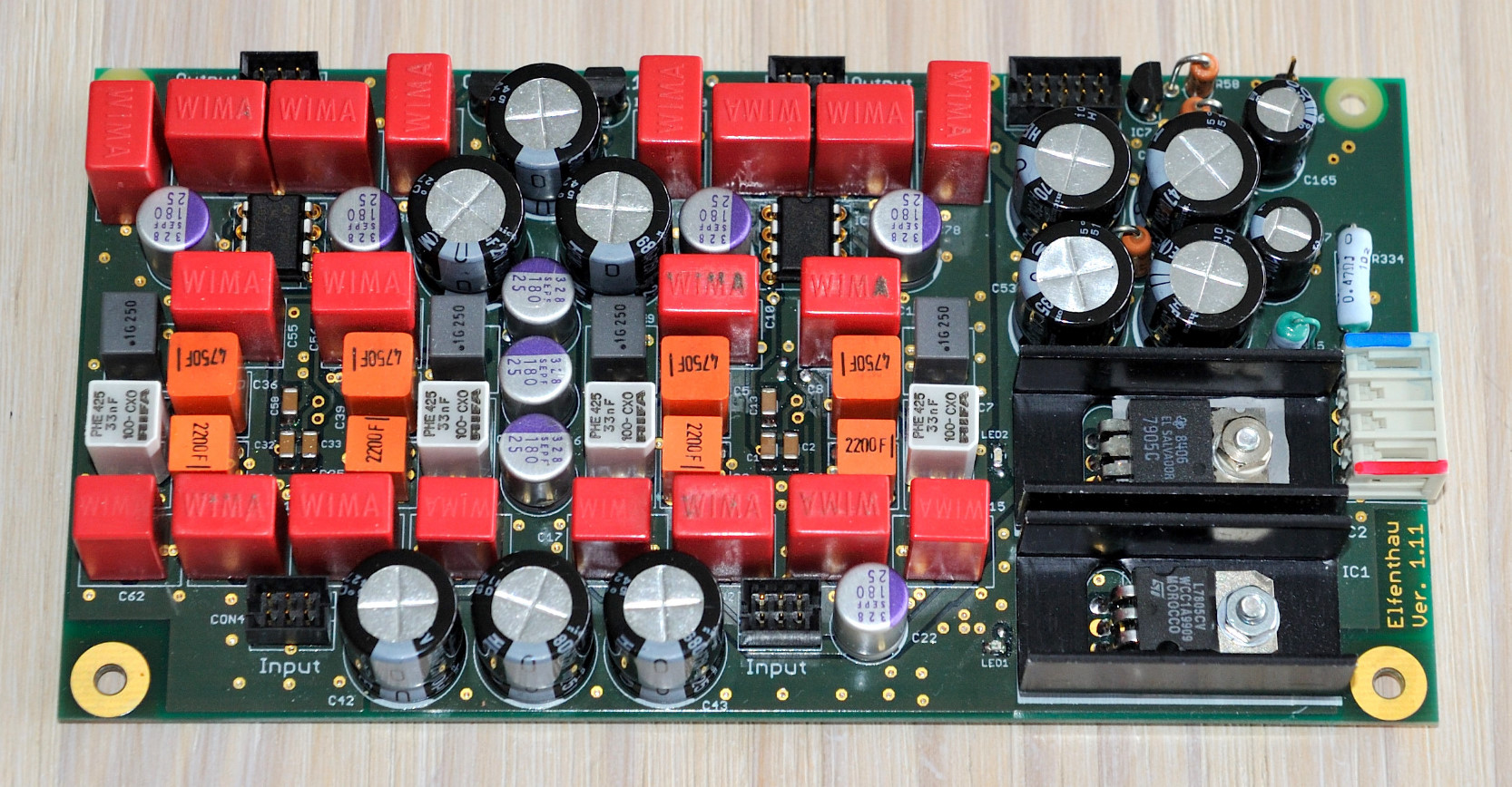

Hi Rick,
you can find some code attached in a .txt-file. It just the NJW control code.
No user interface or so because this is hardly related to my hardware.
I will attach two photos of my self build preamp as well, where on can see
the tone control board. It is a little bit hiden behind the main board and the
active subwoofer crossover but i guess you will find it ;-).
Btw. i used a Marantz NR-1501 case for my amp from which i removed all
original electronics.

elfenthau,
Your work looks beautiful. What functions and features have you built into it, and have you measured its performance parameters?

Very nice build out Elfenthau! I see lots of serious layout work and effort there. Congratulations!
Where did you get the case by the way?

@ Bonsai
Very nice and professional work! And may be not that far away from what i did.
I will attach two schematics (preamp + active crossover)
For the case i bought a used Marantz NR-1501. I took out all Marantz stuff
and build in my own ;-). The Marantz electronics i could sell for nearly the
some money i boght the device 🙂.

The input stage consists of two parallel instrumentation amplifiers (less noise)
which can be bypassed via relays. The opamps are OPA827 for the first
and LME49720 for the second stage. This stage is low gain usually but can
be switched to +12dB if gain is required.
The input stage is followed by two (!) PGA2320 for each channel. The two
chips are put in parallel for lower noise and then followed by a crosscoupled
differential stage to lower 2nd harmonic distortion.
Behind the volume control there are relays enabling tone control and/or the
subwoofer crossover. Unfortunatelly crossover is no more differential any
more because of the excessive effort (space) for it.
Then a line driver = headphone driver follows made of OPA627 (not 827 as
in schematic) and a LME49600 buffer. This is bypassable via relays as well
for the line function. Headphone output will always have this driver active.
The PCB is a four layer one. I just reserved one layer for GND plane only.
Most signal lines (layer 2) are shielded between layer 1 and 3. All inverting
opamp inputs have a guard ring fed by its related output.
