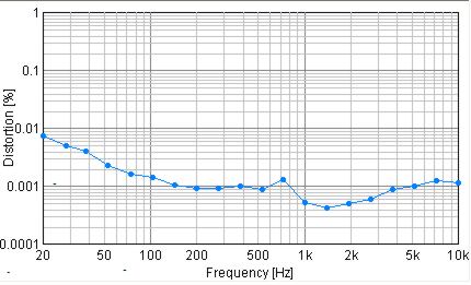

0.0004% THD Class D Module
Using the (rather radical..) new measurement methods as proposed by Per Anders, i hereby post the first measurements of THD on the 700XE.
I guess the serious message in this result is that pre filter NFB can give as good THD measurement as post filter NFB.
Take a look below 😉

Excellent THD results, and what, there for a pre filter NFB design!!! :whazzat: :angel: 😀
As peranders asked, "How does it sound then ..." 😎
Lars, the graph only goes to 10K, what's the THD from 10K to 20K? 😱
IVX: Kind of a joke between me and Per Anders. 😀 From another thread. 😉
And please note, the posted THD data are real, but NOT official data release.. I just posted the best looking results i could get (under the most beneficial op conditions .. but not totally useless anyway). 😎
Of course a more parametric result will be released later on.
This is the problem I have found with measurements, if not measured with a true inductive load then your not getting real world results. If you can get below 0.01 with a real speaker including crossover, then you have something.

I have even lower THD on the loudspeaker, then on the 4om resistor, at least in highs.
PS: Reducing THD by the huge loop gain, IMO, is not so much intelligent approach. I have said "STOP" to myself, when could not provide flat THD/Freq more, it's occured at 50db loop gain and no more then 500-550KHz idle switching, because i still prefer cold amp. But if i could develop the discrete amp with 30db loop gain and .005% THD at 10W etc, i would be really proud.🙂
