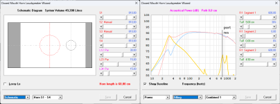

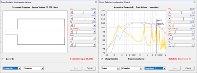

I had some time to think and simulate and I guess there is not even the need for a spreadsheet! At least for the very fundamental rules.Now @stv has to make a spreadsheet for best port placement!
And I am sure I am not at all the first one to find this "solution".
General requirements:
- keep efficiency of the desired bass reflex resonator high (thus, as little stuffing material as possible)
- generate as few resonances as possible
- avoid resonances exiting through the port (and the driver, but the port usually better transmits resonances)
- try to move resonances up in frequency, where they are easier to dampen with (thinner) stuffing/lining material
1. avoid lowest resonance
the stronger and difficult to tame resonances are the low ones.so let's try to avoid the lowest resonance in a given enclosure.
lowest possible resonance is the first mode generated by a wave travelling back and forth along the longest box dimension (λ=2*L).
if we place the driver at the exact half length of the longest box dimension, the waves travelling in both directions will coincide and cancel out at the driver position.
we have "virtually" halved the longest box mode!
there is, of course, still a resonance with double that frequency (λ=1*L).
2. avoid the resonance exiting the port
the resonance mentioned above with λ=1*L is still strong (and it does indeed affect the driver, which hopefully will be able to handle it).how to avoid it exiting the port?
put the port in a position far from pressure peaks (enclosure walls and driver), that is: at a quarter of the enclosure length.
3. dampen the rest of the resonances with lining/stuffing
4. if you are not happy with the driver and port positions for aesthetic or practical reasons
use a tapered enclosure or divide it creating a taper. this allows to change the ideal driver/port positions (simulations will follow!).using the hornresp offset port transmission line model is great for simulating this!
alternatively: switch port and driver positions. this seems to be just very slightly worse.
5. it even seems possible to cancel out enclosure and port resonances in simulation
but I am not sure how well that translates to reality!Hornresp simulations

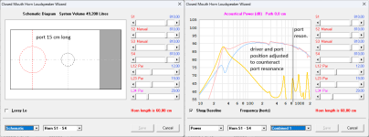

a) worst case: driver at one end of a long enclosure, port at the other end
with strong first longitudinal mode resonance at λ=2*L (~ 283 Hz):
b) better variant with both port and driver at half enclosure length (front/back, for example):
first visible resonance one octave higher up at λ=1*L (~ 567 Hz).resonance peak can be lowered with filling, also lowering the bass reflex output (here about -2 dB):
c) even better with driver at half and port at quarter length and vice versa:
very thin peaks, easily dampened with a bit of lining.bottom variant has a stronger resonance in the total output (red) at 283 Hz. that is because the longitudinal mode is excited by driver not mounted in the center and can excite first mode.
upper variant with filling:
d) a quick attempt to cancel enclosure and port resonance:
but not sure if it's worth it - it definitely needs some more optimising work!

Question guys: Why not look at cabinet and port resonances with the planned low-pass filter in place?
Seems to me they'll only resonate if excited.
In Hornresp, once I add a low-pass to a sub with the filter wizard, resonances go bye-bye...looks like masked.
Masked look is for subs that are being used as subs, low-passed say no higher than 200Hz,
......not to a woofer trying to reach much further up (which I never fool with)
