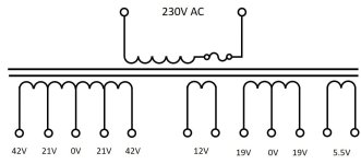

The 600ish watt models typically have secondaries that look like this:
I especially like the 21-0-21v taps as these are quite usefull for chip amps etc, I imagine various lower power class A amps as well (which I haven't gotten around to yet)

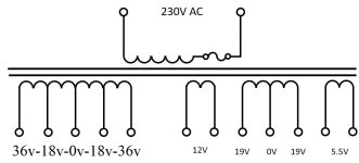

The 300w models typically have secondaries like this:
Some of the higher power models have even higher voltage on the B+.
