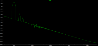

I have picked up an old idea that Slagle once came up with. If I remember it correctly, Rod kindly helped me with the servo. I have now "updated" it with DHT driver and "free lunch" anode voltage for the driver through a CT LL1667 anode choke.
Question is how to feed the PP heaters with Rod´s regulator?
For some reason it sims better with parallell heaters,
SE style FFT footprint. Below simmed at 5W giving ca 0,7% THD.

The idea of a single unit for PP heating was discussed a long time ago - but in practice it affects the sound too much.
The two PP valves have anode current flowing in the filament in antiphase (180° apart). The anode current produces a signal-voltage across the filament.... and connecting the two filaments in parallel creates a crosstalk between them.
PP filaments should be heated separately for good sound!

Having being away from electronics 10 years I have lost a lot of knowledge. Thanks for explaining Rod, actually what I suspected after reading your precautions in the Bartola article, but hoped for a little more economic solution like in 4, 5 and 6 😉. Haven´t looked into it, I guess four regulators can not be fed from a single supply, so do I need two or four?
https://www.bartola.co.uk/valves/dht-push-pull/
“The important thing is that the currents flowing in opposition may well degrade the sound. Possibly, it will degrade it very badly! I would try it out, and listen – but a good outcome is not guaranteed!”
“The music signal current in each of the PP sides is in anti-phase, like the cathode current (in fact, it is the cathode current!). Since any improvement in filament supply quality can usually be heard, I would suspect the parallel connection sounds worse than individually regulated DHTs.
Series might be better, but I would check by listening for a long time.” (Rod Coleman)
These put the Filaments in series.... Now the problem is that one « cathode » is biased below ground; the other is above ground. So the grid-cathode voltage is offset. The isolation is not so good, either.but hoped for a little more economic solution like in 4, 5 and 6
You can use the same DC feed for PP filaments, but only if the cathode voltage is the same point (eg ground - with grid bias).

Not quite... you still need separate regulators, to prevent crosstalk between the antiphase PP halves.
But if the cathode resistor is shared (or zero) the Raw DC (rectifiers, caps, transformer) can be a single unit
