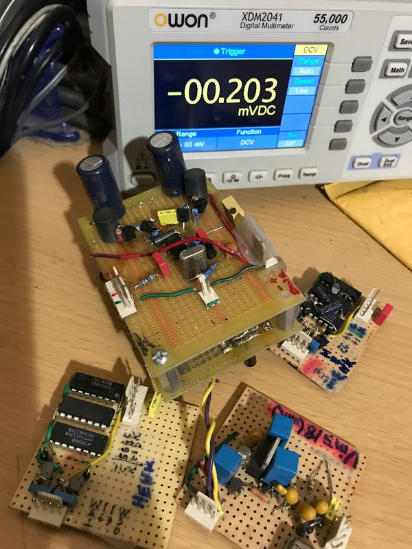

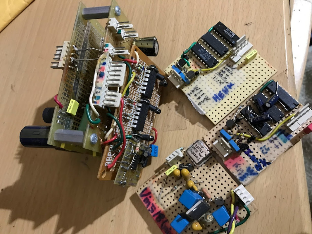

I've Veroboarded some high-performance clocks, and related projects, in years past. The "multi-story" device is the photos below is, I believe, a Kwack Clock, a re-clocker and a divide-by-2 (all-in-one) contraption.
Been out of practice for many years ... forgotten what I did here ... one of the Vero's is a Flea Clock (???). The "Henk" Vero's may be re-clockers (?????)
I see a Tentlabs low jitter clock on one of your boards. That contains all electronics besides the crystal. You just divide its output by 4 and ready to use.
