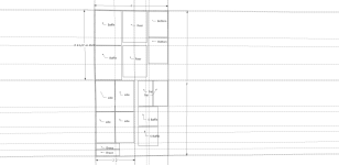

Basically one sheet for 2 cabs if you lay
out everything well on a 4'x8'
I laid it out so the sheet is first split
almost in half at 45.5"
so easier to handle 2 halfs of a sheet.
Then I can set the fence on table saw
and get sides, baffle. top all in same
straight cuts.
It is easier to make top, sides, bottom
and especially the baffle slightly larger
than needed to get the 8 degree slants cut.
I get sides top bottom cut correctly and assemble first.
then add the baffle. But make the baffle larger
at first, then trim route flush for perfect edge
once glued. The speaker cutout and rear sunken recess
cut first of course.
