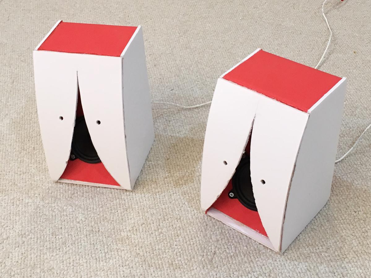

I made something similarly sized a long time ago with a curved front. It works as a satellite speaker and will need a woofer but was fun and easy to make out of foam core. I used a 3FE22 but the PS95-8 would probably work fine here.

hi X
I had forgotten about that kurved little K. Do you think the reduction in hollowness was mainly a function of the new front chamber shape ? - or due to the curve lending more strength ? It should be something to try with larger cabinets.
