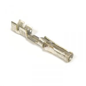

I'm looking for something like the connectors in this picture. I have boards with a single hole for a wire, so I couldn't install a two-leg connector, but I still want the ability to disconnect without desoldering.

The top one in your picture
is probably:
Pinball Life: Molex .093" Female Connector Pins 18-22awg
but looks like a kludge to me, it is not even insulated.
It should at lest be heatshrinked, but much better inside its own rigid housing:

I'm looking for something like the connectors in this picture......
Those are taken from miniature (7 and 9 pin) tube sockets.
They are a perfect fit on a TO3 device's pins (because early transistor bits came from the same bins as tube bits).
I would not use THAT system today. There are many options in wirewrap size, as JM shows.
