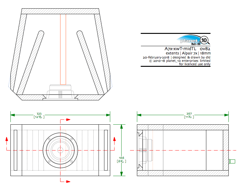

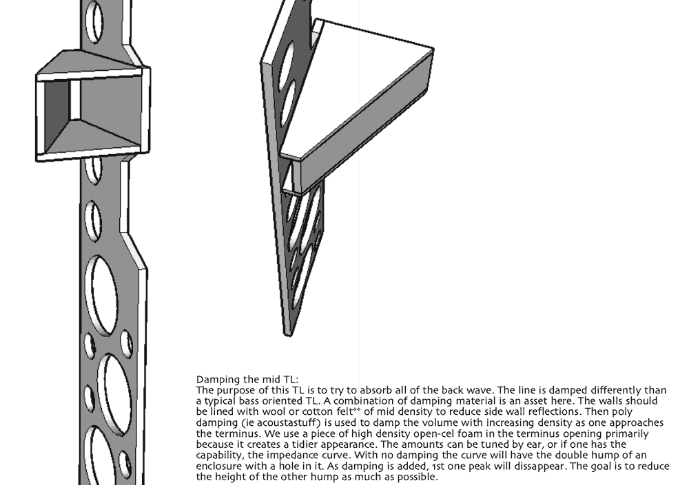

GM’s post reminds me that i have done a number of (close to) aperiodic midTLs.
Here the impedance from an early one:
These don’t make for pretty pictures, but this should give an idea:
Meant to sit on top of a miniOnen the same size.
And this the midTL in the big A12pw MTM:
That aperiodicTL is inside these boxes:
dave
