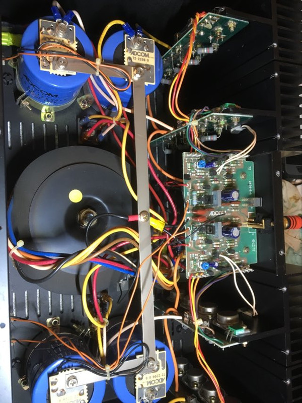

Well I got this $10 yard sale Adcom amp up and running and it's in perfect spec now and making music.
Did some heavy visual inspecting and a little bit of initial testing with my DMM and couldn't find anything that was obviously wrong with my very novice skill set.
So when I initially got the amp from the lady at the yard sale she didn't have a clue as to whether it was working or not. She stated that it was left in the basement of their rental property that they were putting up for sale and made no guarantees about its condition.
I did plug it in at her residence and saw it powered up but that was the extent of things. I paid her $10 and drove off.
Got home and checked the bias and it was in spec so I then tried to play some music through it on some junk Sony speakers and it made no sound at all through either channel.
I just assumed that the fuses were good because all 4 on the output boards looked to be in great shape visually as I didn't see the filament being damaged, but guess what when I inspected them further with my DMM the two outside board fuses were NG.
The filament looks perfect but they were both open.
Replaced them with new ones and the amp is running with 0.6mv on the left and 0.14 on the right.
Sometimes it the most overlooked simple stuff.

Not seeing any type of fans in this unit. I did read about not having any type of speaker protection in this particular amplifier.
I did visually inspect all the PCB boards and didn't see or notice anything obvious that has indicated any over heating around the resistors.
Honestly, I was pretty surprised as to how clean this amp was internally. The pictures attached show the unit in its current condition without any kind of cleaning by me.
I tested the power supply capacitors with my LCR meter and those 4 capacitors are in perfect spec.
I'm inclined to believe that the previous owner put this amp on the shelf when the fuses failed and never touched it again.
I'm going to swap out the front end board electrolytic caps and button it up and use it as is.
But I 'm open to any suggestions on improving the amp since I have only $10 invested and about $8 in fuses.
