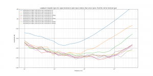

Loopback frequency response
See graphs. Note hardware channel numbers are 0-based.
Rear line inputs and XLR mic inputs have the best extension, -0.5dB at 40kHz when using 192ksps.
Front line inputs are -1dB down at 40kHz.
So, very usable, no problem here.

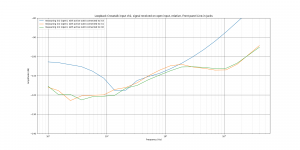

Input crosstalk
In order to measure things, like LDOs or filters, this also has to be accounted for, since you want to measure both the input (for calibration) and output (for measurement) of the device under test, too much crosstalk in the soundcard screws things up.
The rear line inputs have little crosstalk with anything, especially the front inputs.
The two front line inputs have quite a bit of crosstalk between each other, but not with the back line inputs.
The four front XLR inputs have an embarrasingly high amount of crosstalk between each other, though.
So, if low input crosstalk is necessary, this soundcard really has three inputs: two on the back, and one of the line jacks on the front. That's useful to know, which is why I did this test.
But, well, below 10kHz, the rest of the inputs aren't that bad.

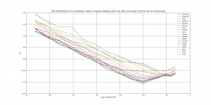

Distortion
All the line outputs are identical. The inputs, however, are not.
Rear line inputs and outputs are powered by timeless audiophile standard NE5532, so they deliver a pretty honest performance in loopback.
Front XLR mic inputs however, contain a JRC knockoff of the TL072, and it shows.
And the two front jack line inputs run on the same circuit, including the accursed 072.
I'm not exactly sure of the amplitude calibration in these graphs, but well, the take-home point is, if you want to measure distortion, it is wise to stay away from the inputs that have a TL072 in the signal path. The rise in THD at high frequency is truly spectacular.
