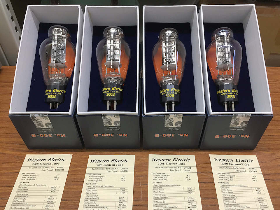

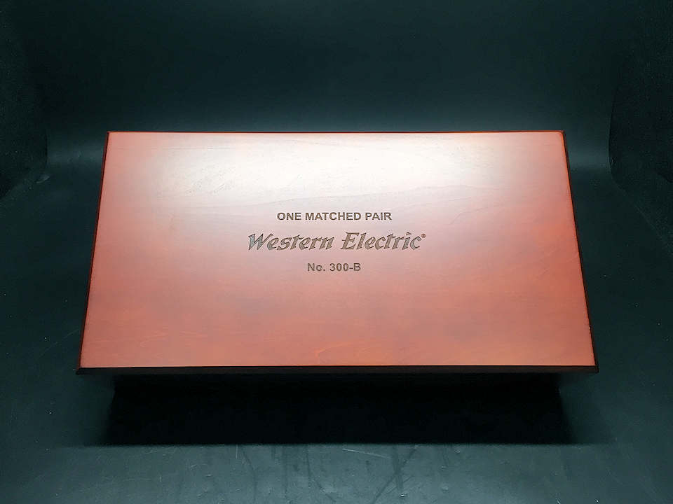

What appeared in front of me after unpacking it ...
There is no different from 15 years ago. This is the best of the original Western Electric.
In the box, the instruction manual, measurement data with serial number, and warranty registration card are stored as they were in 2006.
The most important measurement data sheet. The method of measuring the Ip value at Ep = 300V and EG = -58V is the same as at that time.

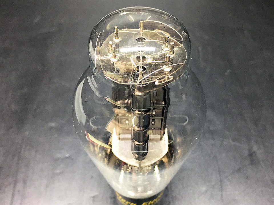

Each part in the valve has not been changed from the original. The thinness of the glass remains the same as it was at that time.
The pitch of the sound when the glass clicked with the index finger is also unique to the WE300B.
Print of the base part. The miracle of date code 2113 (first quarter of 2021) will be handed down forever.
The appearance of the rice ball-shaped mica, including the filament hook shape, has not changed at all.
This is the serial number stamped on the base. The new lot starts at 3.
It can be said that the product is complete only when these three numbers, the outer box, the data sheet, and the engraved base, are complete.

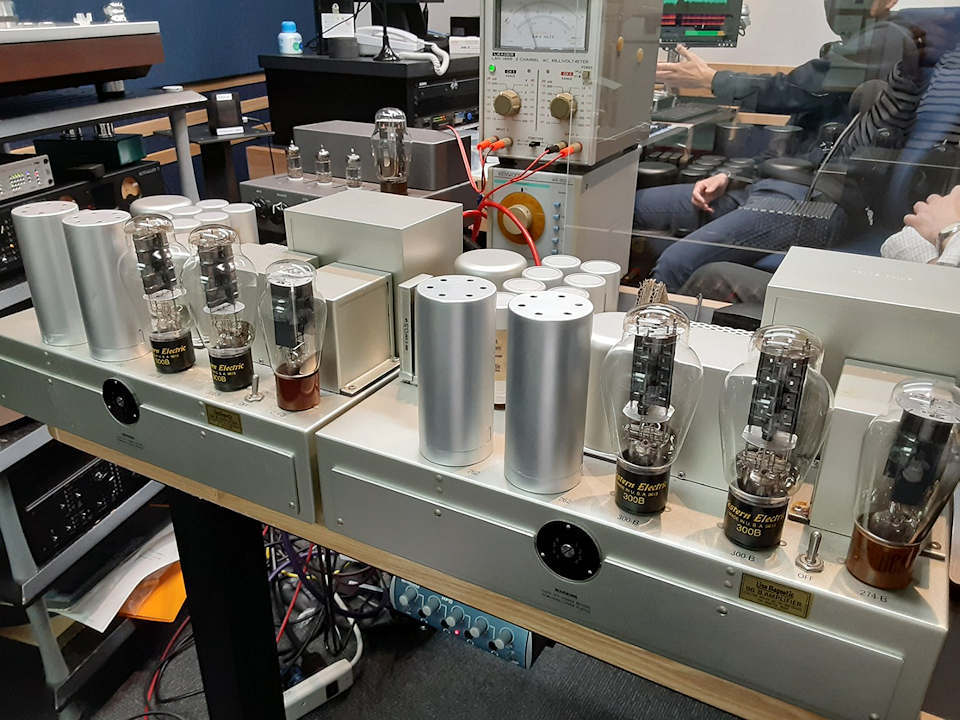

This is a device that records the dynamic characteristics of a vacuum tube by swinging the plate voltage and grid bias.
All control and data management is done on the computer.
Is it easy to understand the device for measuring the Ep-Ip curve that is often found on vacuum tube data sheets?
Is the wonderful Ep-Ip characteristic attached to the reissue WE300B ?
The data sheet attached to the product is on the left. The data on the right is the data measured in kind today.
First of all, I tried to collect data on individuals in the first quarter of 2006.
Although there was a 2-3% difference that seemed to be environment-dependent when compared,
the same difference was observed at almost all points, indicating that the reliability of the measurement results is extremely high.
Finally, when I take the data of this lot ...
Plate current: 56.93 mA, internal resistance: 800 Ω, transconductance: 4891 μm hos, μ: 3.9 V / V
Plate current: 56.41 mA, internal resistance: 820 Ω, transconductance: 4753 μm hos, μ: 3.9 V / V
Data log was detected. It is a unique value to the head family, which is completely impeccable.

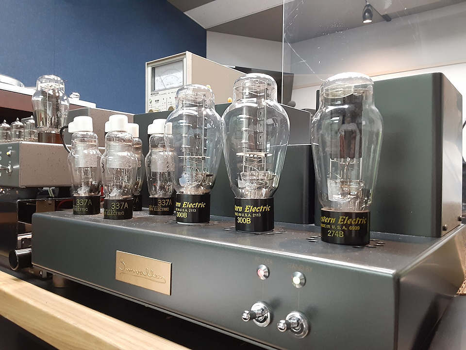

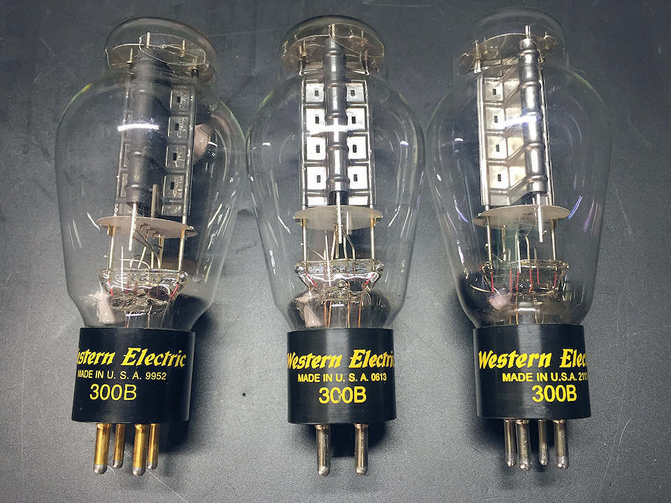

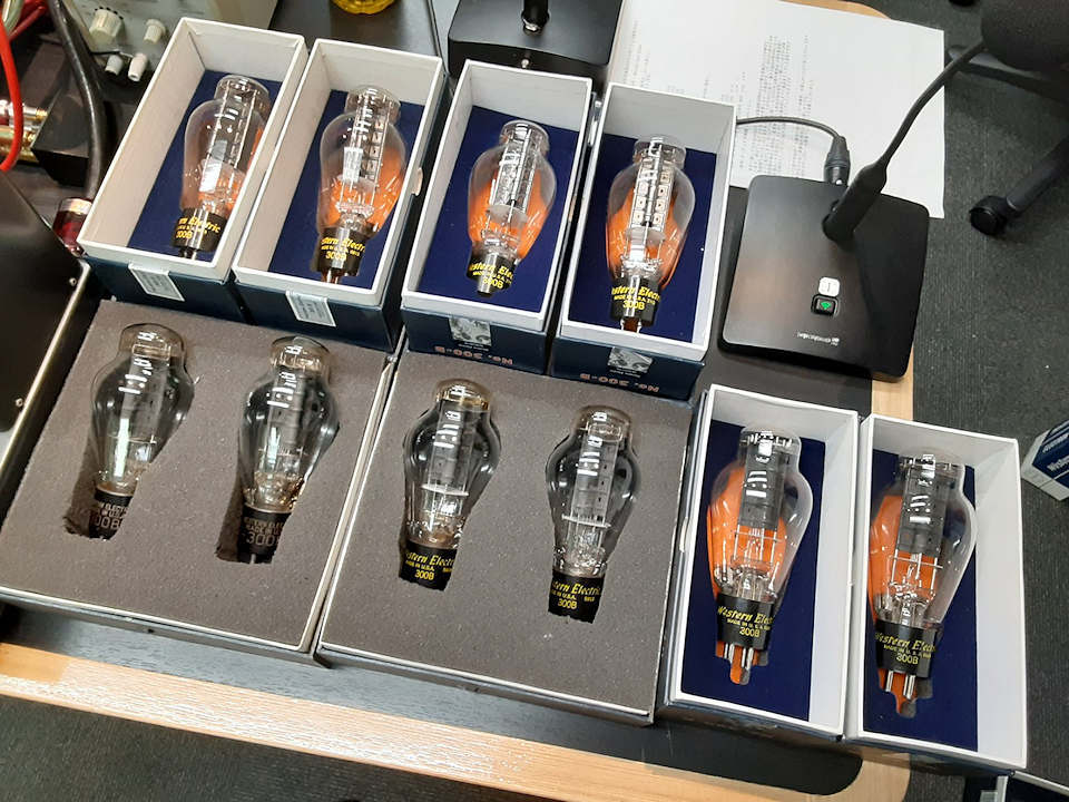

We have prepared three types of WE300B this time to objectively audition.
Three types of re-issue WE300B. From the left, it is the fourth quarter of 1999, the first quarter of 2006, and the first quarter of 2009 .
The LOT 9952 on the left is said to be the special order of a Japanese distributor at that time, and the plate is carbon-suited and the pins are also gold-plated.
I remember that the price was about 20% higher than the regular product at that time, but it is said to be the highest grade among the re-issue products from 1995 to 2006
(By the way, there is also a non-carbon / gold plated product in 9952). So you need to check the actual item carefully).
If you look closely, LOT 2113 has a less blackish appearance in terms of plate color, or an appearance close to silver. Let's move on to auditioning immediately.
First of all, it is an experiment with a single (SV-91B Sunvalley amp).
We use the same music and the same gain with the same amplifier. If you listen to it in this way,
you can see that there is a considerable difference in sound output depending on the age of the tube.
First of all, you can see that the LOT 2113 has the longest range of low frequencies in the re-issue WE300B.
It is a low expression that not only stretches but also feels thick. LOT 0613 has a slightly higher-frequency balance,
but I feel that this tendency has become even more apparent in this comparison.
Also, it is said that LOT 0613 (to be exact, a re-issue after 2002) has individual differences in the degree of vacuum in the tube,
and I heard that WE had a lot of trouble in terms of quality control (at that time, it was a regular route in Japan.
Basically, all the individuals that came in are good products that have cleared with inspection, so don't worry), and LOT 2113 seems to have cleared that task as well.
This time, I would like to introduce the difference between LOT 0613 and LOT 2213 because I was able to understand it from the outside.

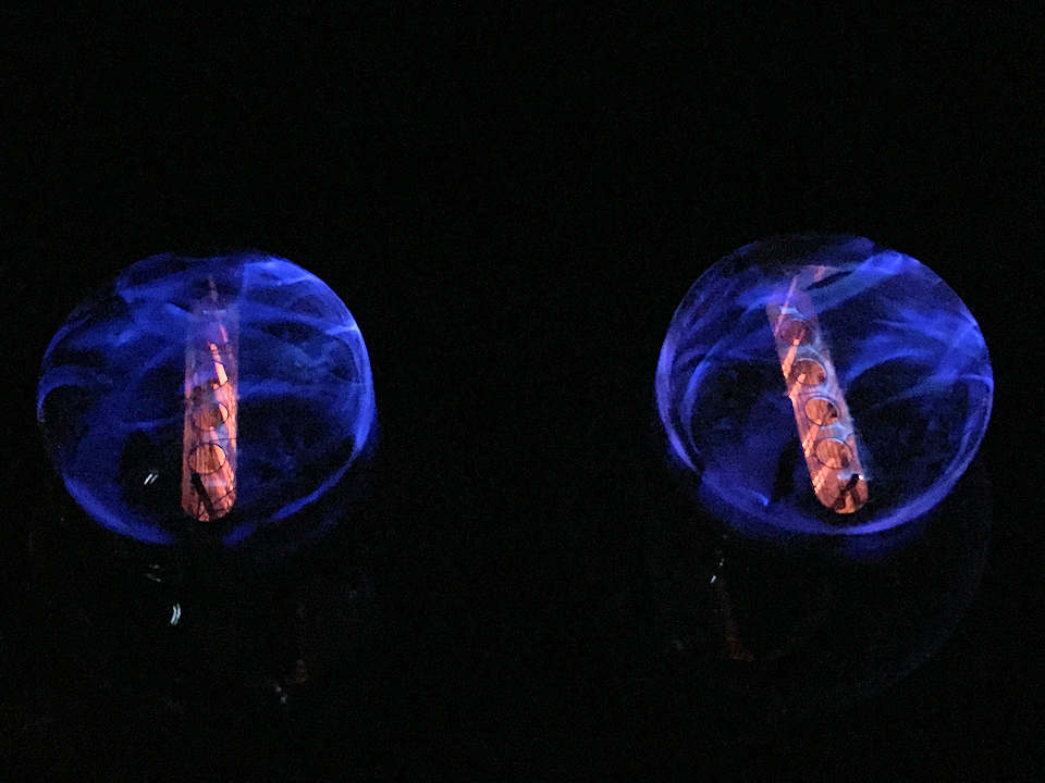

It is the situation of glow discharge that I took with my smartphone. I tried shooting LOT 0613 under the same conditions,
but it was at a level that I could not recognize visually even if I could see it. Furthermore, while the glow of LOT 0613 appears in the upper half of the tube ,
LOT 2113, like the LOT 9952, the glow appears concentrated around the mica plate at the top of the tube and the brightness is also quite high.
It is said that this glow is ionized and emits blue light at the moment when some of the thermions emitted from the filament toward the plate do not reach the plate and collide with the tube wall.
If the glow always comes out strongly. It does mean that the tube is excellent, but if the glow is uniform among the tube, it can be said that the quality (control) is stable.
Anyway, the glow of LOT 2113 is wonderful.

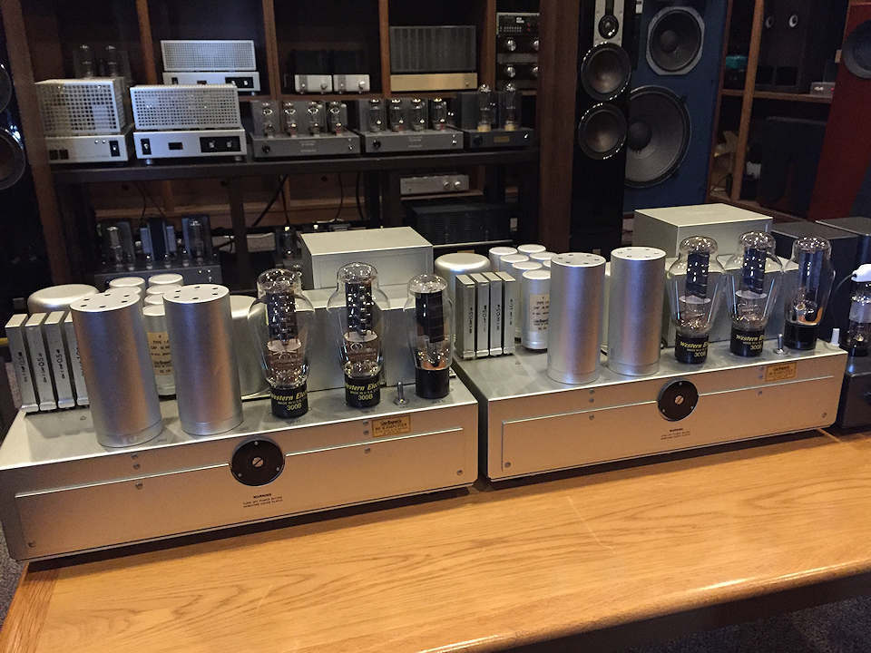

We will check the sound quality by push-pull amp.
Monaural / transformer drive push-pull. The sound of the theater amplifier with the deepest expression tends to be heard with the thickness of the mid-low range,
but while the LOT 2113 further strengthens that tendency, the fineness of the graininess of the high range is a group among the three reproductions.
Since this 86B is the same pure iron output transformer as the original, the frequency response is only extended to about 13kHz / -3dB.
That is what makes the sound quality of this amp decisive, but while none of the Western Electric 300Bs feel any lack of high frequencies,
the LOT 2113 has a natural extension of high frequencies. It's often said that the Western Electric 300B doesn't need a tweeter, but the legend is still alive.
The new Western Electric 300B / 2113, which have just arrived to have quality and sound quality. It's woth the long waiting

SV-91B (WE337A-WE337A-WE300B-WE274B). Single / filament DC ignition
LM86B (262B-262B-300Bpp-CV717 / 5R4GY). In the first push-pull / filament AC ignition
