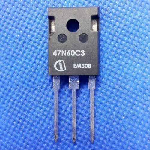

-Hello, this is my first post here and i hope you guys can help me out. I recycled a pair of 47n60c3 mosfets from an old board and i wanna know if they are suitable to build an amplifier with, im thinking something like a simple class A amp using each transistor for each channel, so i want to know if these mosfets can be used for this kind of purpose 🙁

What I can say its got good avalanche characteristics , in other words if the Vdss is exceeded (rated voltage ) it wont break down if the drain current is within limits .
Will it work in class A --well yes .
Is it "as good " as a mosfet known to work well or designed for audio --er no.

-Thank you a lot for your response, i'll keep this in consideration. I wonder how much watts i could juice out of these mosfets in a class A config considering their limits, is there a way to calculate that?

Good powerful devices, could just about get 180W class-ab out of a single pair with good heatsink.
180W is very ambitious, the datasheet does not describe low frequency SOAR, always an issue with modern MOSFETS. The shortest graph tp is just 1 ms. Real loudspeaker loads have low impedance and wild phase around port resonance, where music power content can be high
The datasheet I saw on Infineon website showed DC curve for SOA and the junction to case thermal resistance was fairly low.
Without an SOAR graph its pretty foolhardy to try and use a switching MOSFET for analog duty, but this one has a graph and it suggests 7A @ 70V is on the DC limit which is pretty good. 0.18 C/W thermal resistance in total by my calcs.
The high voltage rating means the threshold voltage is quite high, losing more output swing than some MOSFETs.

A 600V/47A part which can probably be run at 12V/2A as half of a class A audio amplifier
