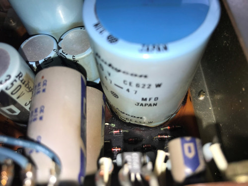

I d like to start by the power supply
Bridge rectifier :
It is 1N4007 diode so i will swamp em for UF4007, i think it's an easy choice; less noise & faster

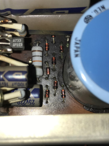

To continue with diodes, here's a bunch of WZ-310 above the second quad of 1N4007. Seems to dissipate a lot of heat !
I was thinking of BZX79C30T50A for the replacement and to mount them 5mm above the pcb to help with the heat. Any better choice or tips here?

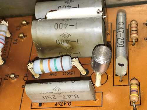

Most of the time i would not change that kind of film caps but the 15k ohms 2w ressitor on the right of the 1uf gray cap started to toast it so... let's swamp 'em all!
Here's the point is to find a good quality replacement for the 0.47uf 250v and 1uf 400v caps with quality and size in mind. PIO, Wax,... are too big.
I could change the resistor by a 15k 3w and take it away a little bit from the caps. Any suggestion here too?

Film and foil is preferable to metalized polypropylene (MKP), but your space constraints may force the use of MKP on you.

Lifting power resistors away from the board is always a good thing but how old is it and how long do you want to keep it. Your photo does not show heavy damage after all these years.
PIO and Wax are notoriously electrically leaky and are trouble waiting around the corner. I always choose Panasonic/Nichicon/Sanyo/Vishay PET capacitors for signal, I doubt you will improve on what is already in place and the electrolytics should be kept to the same voltage and values if possible. Ensure they are reasonable quality however, I am servicing a Luxman SQ707 and the main smoothing capacitor has no measurable leakage and the capacitance is still 5% over original printed value, (the tolerance when new was +20% -10%), so they will stay in place.

For the 470n I would use Vishay MKT1813447405 and for the 1u Vishay
MKT1813510405 and the 15k resistor fit a 2W 5mm off the board but I doubt there will be any improvement . As you said, it is working perfectly, why break it?

For the WZ diodes, i d like to improve the heat dissipation so i could find a replacement and take em away from the pcb a little bit, like the resistor near the film cap.
Here's a better picture of the little heat problem near the caps:
I d like to avoid that kind of cap frying. I could leave the 0.47 in place since they are not affected. I dont look after sonic improvement, just more reliability

I had the 'pleasure' of encountering a CL34 in bad need of repair.
The powersupply PCB was in an even worse state than the one shown in the thread.
Components are severely underrated, Zener-diodes and a power-resistor alike.
Finally parts of the PCB turned into carbon and the the amp. died.
Repairing the PCB and replacing burned parts restored life but the input IC-controlled servo acted up. Again parts were replaced including an IC but in order to make heads and tails on the input circuit I had to trace how the tubes are actually connected. This reveals a surprise or two, look for yourself in the attached pdf.
Good luck with getting this particular CL34 up to speed.

Thanks, do you remember what did you use to replace the WZ-310? It seems to be the hottest area in the CL34
