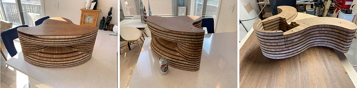

If your CNC is not 5-axis (4 might do) a CNC has limited use, but if it has a sufficient Z-axis range something like this is possible:
You build up 2 butcher blocks, carve the horn and outside shape and then flip one onto the other and glue them together.

When i wen thru my HF horn period i used tractrix, Le' Cleche is sort of an evolution on that. The mid & top Horns at this ETF is an example:
Danley’s synergys are kind of boring (& conical), but solve the big issue of the (relatively) huge issues with C-C and the timing issues usually only solvable with DSP XOs.
