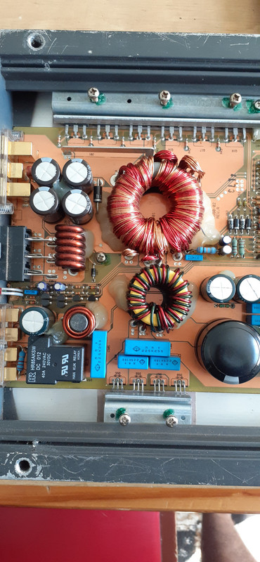

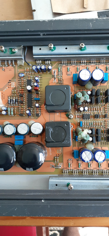

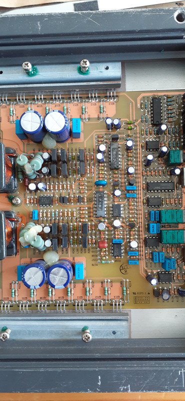

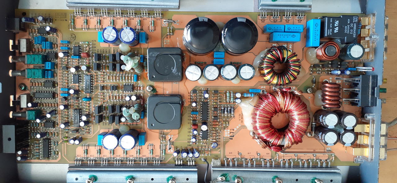

Hi all,
this amp doesn't turn on, switchs between protect and power leds.
psu and output section dont have any shorts.
[/url]
[/url]
[/url]
[/url]
Is the power supply trying to power up to where you see positive and negative rail voltage try to build?
Are you seeing pulses of DC approximately the same as the rail voltage on the center legs of the output FETs?

Ok, I will get out the scope and test.
I've just used a 7.5v 1.5a psu and the amp powered up.... but doesn't with a 12v supply
not sure if this was the issue, earth was loose. amp is turning on now.
haven't gotten my scope yet to check.
i think intermittent fault,
i was checking the voltage regulators, the 7812 outputs 11.1v, could that maybe cause an issue? also the heatsink ground seems to kick the amp into protect, if i disconnect it, it will power up
