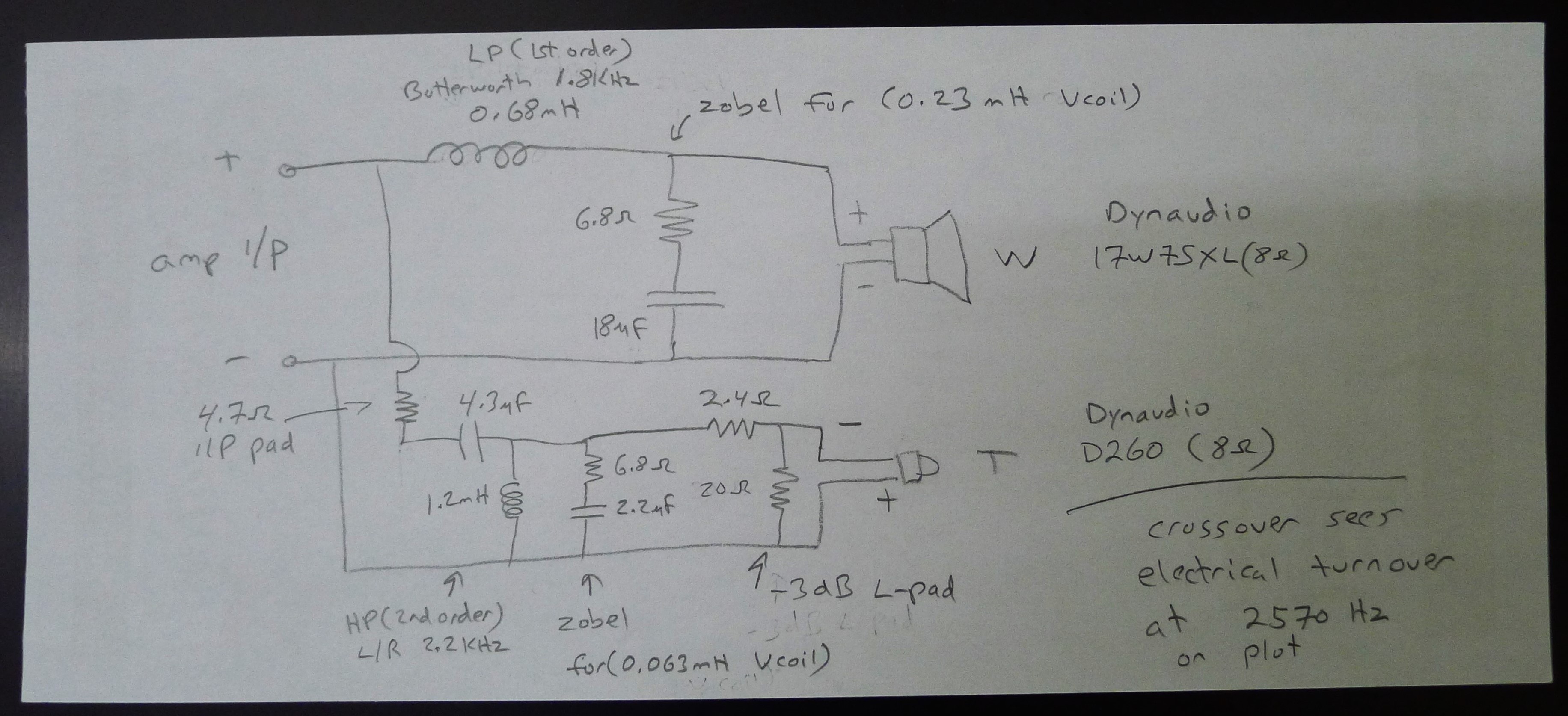

I have Dynaudio 17W75XL {pn#84862}8 ohm mid/woofers from Dynaudio BM6A studio monitors [put into in 12 litre vented enclosure] and D260's tweeters out of Vision Acoustique model 702 speakers. I have worked hard on a very nice-damped/braced cabinet for these drive units. I now need optimum crossover design for this combination with high/low pass sections, respective zobels for woofer and tweeter (if recommended), maybe resonant or notch filters to improve sound and tweeter attenuation if necessary plus any phase corrections, etc. that might also help sound quality. Currently I have below configuration crossover that sounds good already and will rebuild crossovers a final time to live with the speakers forever upon getting proven ideal x-over spec and finally put this fun project to bed. Had based initial crossover design with attached theoretical plot with online "Speaker Wizard.uk" resource. Using Solen standard air core coils and polypropylene caps now but will consider Solen litz coils and Solen film/foil caps next time for final crossover build. Also using Solen achrohmic mil-spec resistors. Love the Dynaudio sound so far...!!!
Thanks in advance for any help!,

Hello Gordon, very nice cabinets, also my kind of style finish. Unfortunately the XO filter isn't accounting for baffle step loss of frequencies and the calculus is based on idealized impedance (and frequency response) being a straight line (8 ohm). The best I can offer is tracing Dynaudio original measurements, applying simulator brewed baffle step response and make a crossover that will be closer to real deal but not entirely as real measurements which are proven to be harder to execute than one would like too. I have a set of 4 ohm car audio MW160GT and D260 but my tweeters have dented domes and come from different years of production, looking different at the back chamber. I'll use 17W75 LQ datasheet for I don't know if XL version existed in DIY form since XL actually stands for higher Bl parameter meaning it was intended for a vented application and LQ is that also. I need the baffle measures, width, height and center to center distance of the drive units. Thank you.

Your current crossover looks quite close to the Foccus4 design, if you untangle the doubled-up excesses of that one. But your polarity looks wrong to me. You usually get a rather echoish or hollow sound on steel guitar like Dire Straits if it is wrong. Box seems a bit at small at 12L too.

Gordon, how do you find the tweeter level with this filter of yours? Would you like it changed in any way? I'm close to making the sim. Btw. hepta litz sounds like heavy snake oil!
Hi Lozjek,
I find the tweeter level with that much attenuation within a dB or two of me liking. I cannot stand for over achieving tweeters! Still would like to find the optimum crossover for my Dynaudio combination however. According to Solen themselves midrange should come out more coherent with the Hepta Litz coil in series to mid/woofer but maybe it will be snake oil in the end?! What are your thoughts on a better cap such as film/foil compared to regular polypropylene - had you tried? Anyone else...?

I am supplying the plots I promised to. It was a little bit odd to work on it. I used the official Dynaudio woofer measurements in their respective cabinet and I didn't apply any changes to it. It is what it is. My filter proposal is a simple one which I thought would be a proof that tweeter is better protected from lower frequencies level and the XO point is in the ballpark. However you are free to modify it to your taste. Padding resistor in tweeter branch can be any value in either direction so if you are confident, try it.
Tweeter very high frequencies are 0 deg axis so as soon as you start moving horizontally, the level goes down. I would not worry about it. The important range is at about 5 kHz. That should be set right. Black curve is summed response of drivers.

Hey Gordon, there is this great tracing software at fprawn labs that makes so much easier the job since you don't have to click 1000 times to get frd and zma for one driver like I used to do with SPL Tools.
In XSim you place the driver icon on a sheet and right click to tune properties. There you'll see a dialogue to browse for the files. Additionally I have used +0,5" of delay to the woofer part which states that woofer is half of an inch further away from the baffle.
The files are attached and what I think of Sirius tweeter filter is in the simmed photo. It's okay for a 1st order filter but I am very reluctant to drive a sensitive tweeter voice coil like that so I always use steeper ones. Blue curve is with the filter of mine (yours) additionally padded down to meet the grey which represents Sirius.
