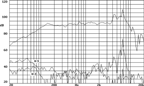

Drivers
Here are some drivers I've found that look decent.
The only specific parameter that I can think of that is important (when compared to a closed box, and used as mid) is that I want a large Xmax, correct? I would like to be able to rear mount so that a speaker grill (cloth) could be attached directly to the baffle. Intended crossover around 1.5 kHz.

Of the 7 drivers in the last post I'm guessing the Faital Pro 6FE100 was best suited (91 dB sensitivity). How about these:
Faital Pro 6FE200
Fs: 120 Hz
Sensitivity: 95 dB (1 W/1 m)
Xmax: 4.67 mm
Rear mountable
Cheap
Slightly jagged response.
Faital Pro W6N8-120
Fs: 100 Hz
Xmax: 5 mm
Rear mountable
Sligthly expensive
Not extremely flat, but should be fairly simple to fix with PEQ.
Faital Pro 6PR110
Fs: 100 Hz
Sensitivity: 96 dB (1 W/1 m)
Xmax: 2.75 mm
Rear mountable
Sligthly expensive
No sharp dips.
Beyma 6G40Fe
Fs: 102 Hz
Sensitivity: 94 dB (1 W/1 m)
Xmax: 3.1 mm
Rear mountable
Sligthly expensive
100 dB scale and few datapoints -> I can't really comment on flatness... Slightly troubling dip at 1 kHz.
Beyma 6P200Fe
Fs: 65 Hz
Sensitivity: 93 dB (1 W/1 m)
Xmax: 5.5 mm
Rear mountable
Sligthly expensive
Seems fairly flat.
/Anton
Doesn't the excursion increase heavily if I'm boosting the lower frequencies?
Yes it does. However, unlike at bass frequencies, you are more likely to run into thermal issues before you run in to problems with respect to excursion. Remember that for the same acoustic output excursion doubles for every halving of frequency. At low frequencies you need very little power to get a driver to its xmax. If you want to drive a typical hifi 7" driver to xmax at 100 hertz you might need 150 watts or more.
If your design requires large excursions (think more than about 8 mm p-p), I would advise using 8" drivers instead. You not only get more volume displacement, you also get a greater distance between front and back, for less cancellation.
