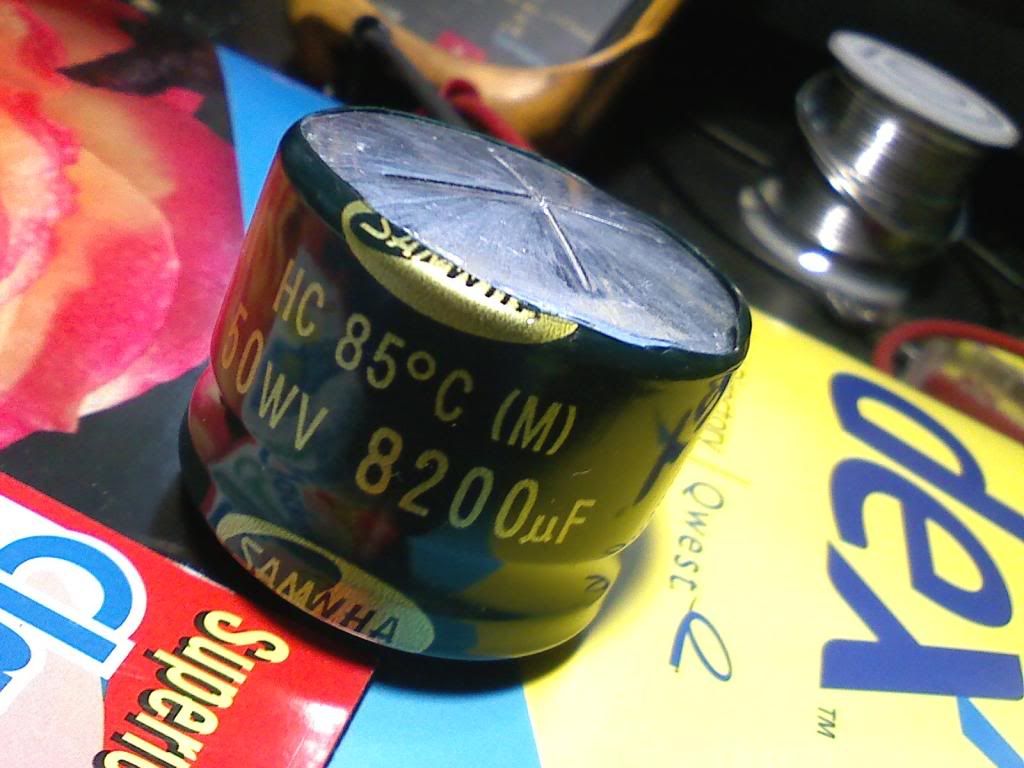

I am shopping for replacement parts for this amplifier, I have Mr. Babin's repair tutorial, and am an experienced tech.
The first question I have is about the two large filter caps in said amp.
One is bulged and the other is not.
I intend to replace them both, along with a lot of other parts in here.
The max height with bottom cover installed is ~35mm.
Is this a suitable replacement?

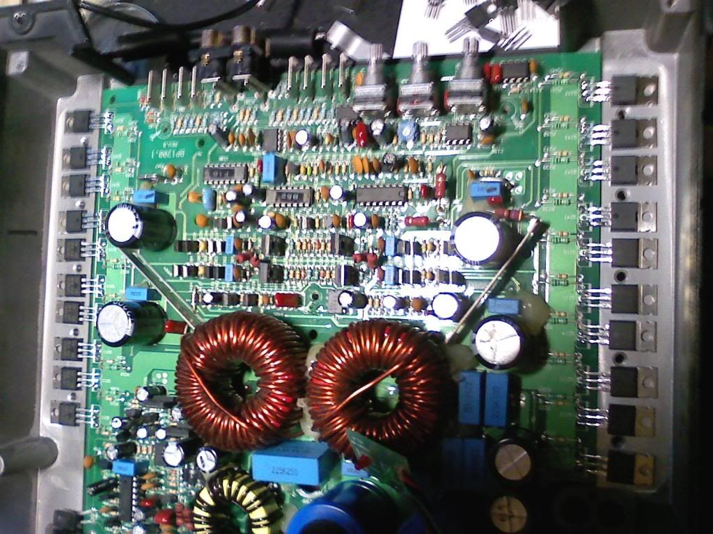

Ok.
I have the amp stripped of all fet's power and output.
Also have filter caps out and tl494 + 1266 drivers out.
Amp powers up fine.
Installed new filter caps, now it goes into protect.
Rectifiers are in, test good, and were never removed. All FET's/494/1266's are still out.
Normal?

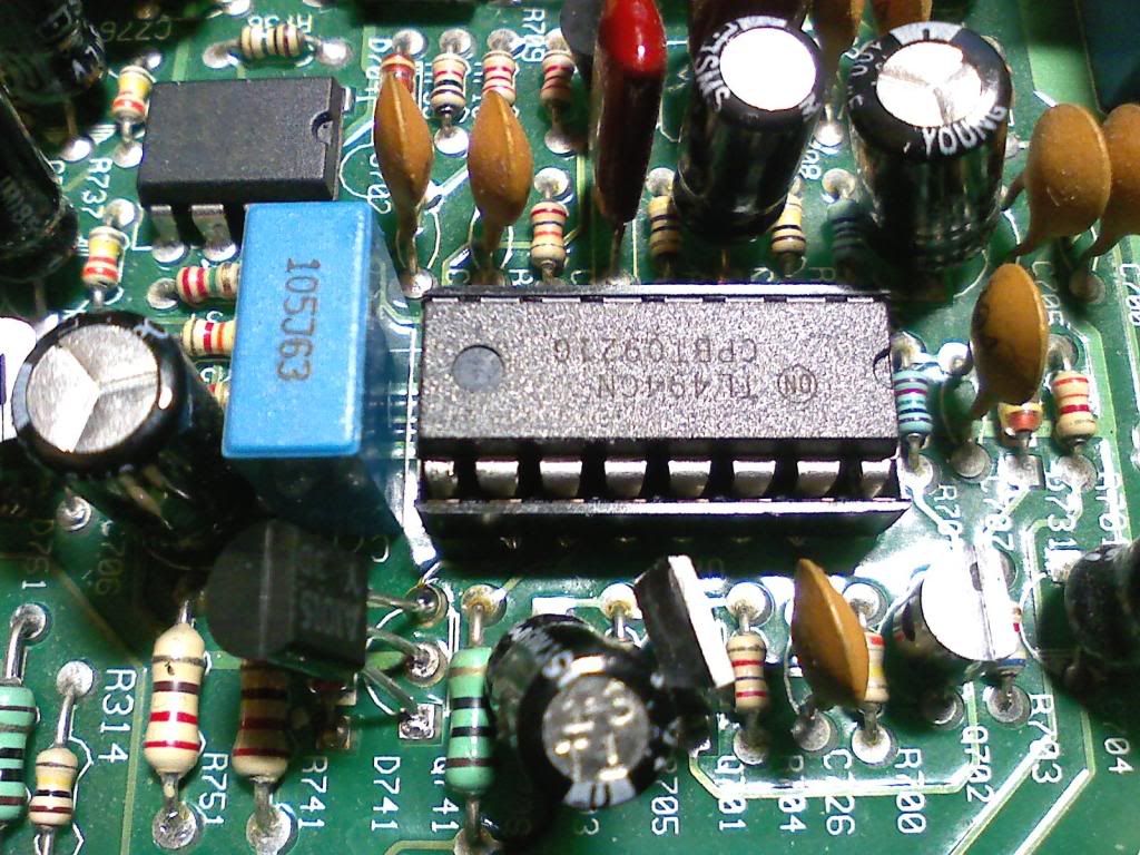

Looking at the schematic diagram, it would appear that this is normal. Initially, the red LED is lit. It is driven off when the 494 begins to produce output.
Ahh, 494 WAS in when I tested it last. It was overheating badly, so i decided to replace it.
I used a socket..
I used a socket..

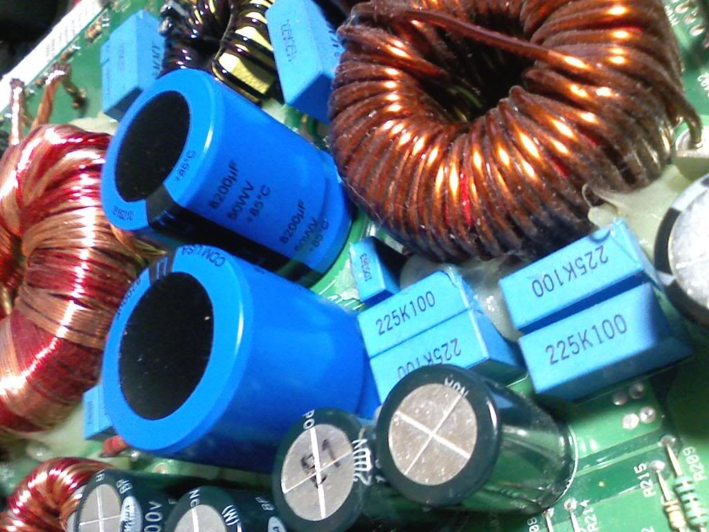

I replaced both filter caps:
with new, mouser sent wrong size but i used them anyway:
They are too tall for cover to fit properly, but not so tall that amp can't be mounted on flat surface.
I am going to have to modify the cover...

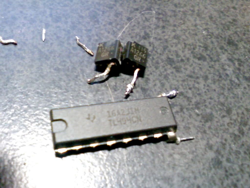

Here are some other bad parts:
Q741 and q751 were shorted, and tl 494 got super hot as I was testing it. (Maybe I shorted pins🙄)

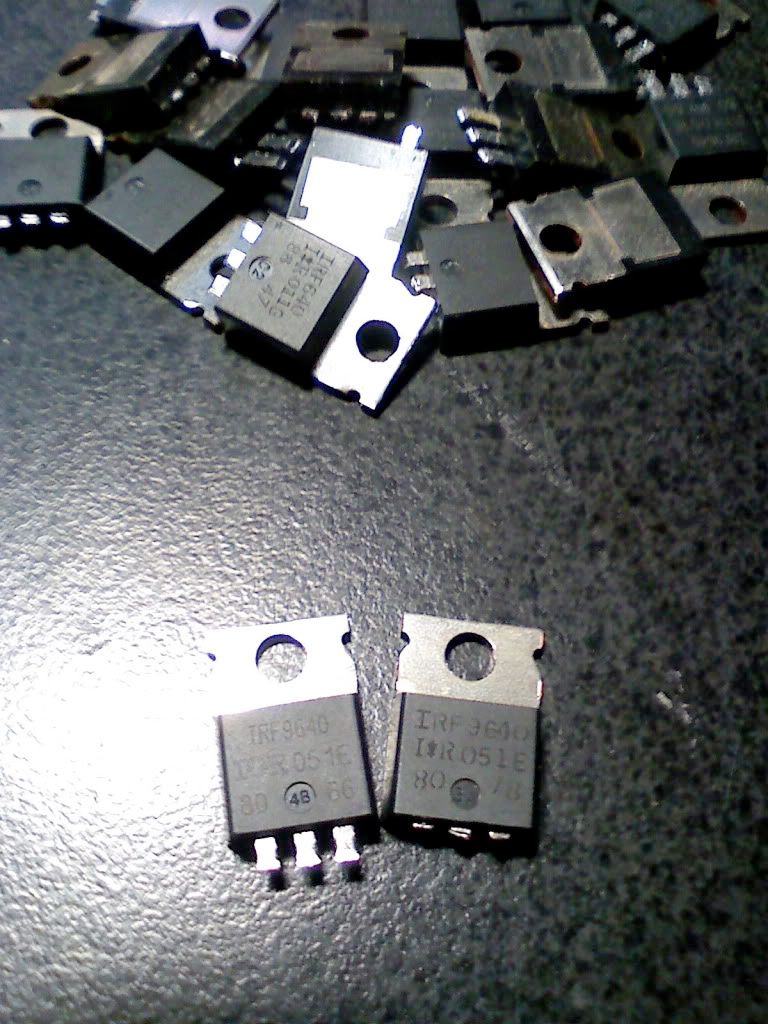

The 2 shorted irf9640's were the only outputs that were bad, but I decided to replace all fet's power and output BOTH sides. Irf3205's all exploded too, of course.

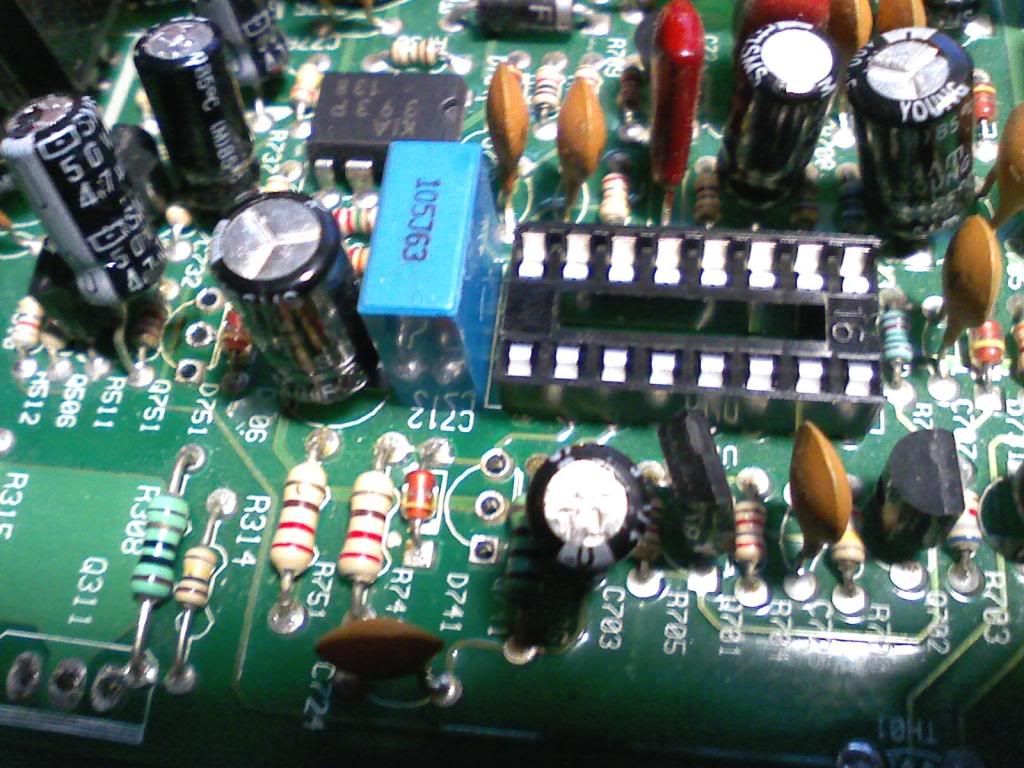

Socket installed:
Once I get the new tl494 in mail,
I am going to power it up and check for wave quality.
With no fet's installed, of course. I have a scope.
Any pin/procedural recommendations would be appreciated, and a good addition to this repair thread.

It turns on normally, and I have a nice clean waveform at the place where the IRF 3205's gates get soldered!
