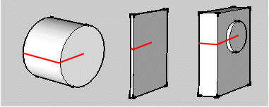

In post #1 I talked about a 1 inch dipole tweeter on a 1 inch circular baffle and with no depth. This is certainly a theoretical concept only. How near to that can we get with real world tweeters? Before we start I would like to refresh your knowledge of ‘dipole distance’. This is the distance from the middle of the rear dipole source to the plane of the front dipole source:
The dipole distance (red line) is shown for two dome tweeters back-to back in a tube (left), for a planar tweeter like the B&G Neo 3 (middle) and a small baffle with two vertically offset tweeters (right – more about that later). Note that the dipole distance will not vary around the perimeter for the tube, but it will vary for the rectangular constructions.

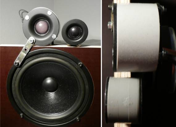

I have built two dome tweeter dipoles in the back-to-back fashion:
The bigger one is two Monacor DT-25N back to back in a tube of 3.3 cm radius and 4.4 cm depth (including the front plates of the tweeters). This adds up to a dipole distance of 7.7 cm, which would correspond as wavelength to a frequency of 4450 Hz. Let’s look at some measurements from 0 deg to 90 deg horizontal with a high pass filter at 2.5 kHz to protect the drivers. Shown are 0, 15, 30, 45, 60, 75 and 90 deg:
We see nice constant directivity from 1 kHz to almost 4 kHz. At 4.5 kHz - the wavelength of the dipole distance - the wave from the rear tweeter will need just a wavelength to reach around to the front - so no phase difference (or 360 deg) on axis to the wave from the front tweeter. Since both waves are 180 deg out of phase at the source, they will reduce each other. Hence we see a dip in the on axis frequency response. Above that dip the dipole CD gets lost and beaming takes over. You see that in the spreading of the off-axis-SPLs with rising frequency above 4.5 kHz.
You may have noticed that those DT-25N are really small tweeters. Two Seas Millenium tweeters mounted back to back (as used in Linkwitz’ Orion) would have a dipole distance of 13.7 cm. This corresponds to 2500 Hz. You simply can’t have dipole CD with them anywhere within their recommend frequency range.
The smallest tweeters I could find where the Dayton ND20FA. You see a back-to-back dipole with them beside the Monacors in the picture. The dipole distance of the Dayton tweeter dipole is 5.6 cm ( 6125 Hz). I have measured their horizontal response too:
You see how the on-axis-dip has moved up to near 6 kHz. Below nice CD down from 4.5 kHz, above 6.5 kHz beaming (which does not show very well because some low pass got in the way above 10 kHz). This is as good as it gets with back-to-back tweeters.

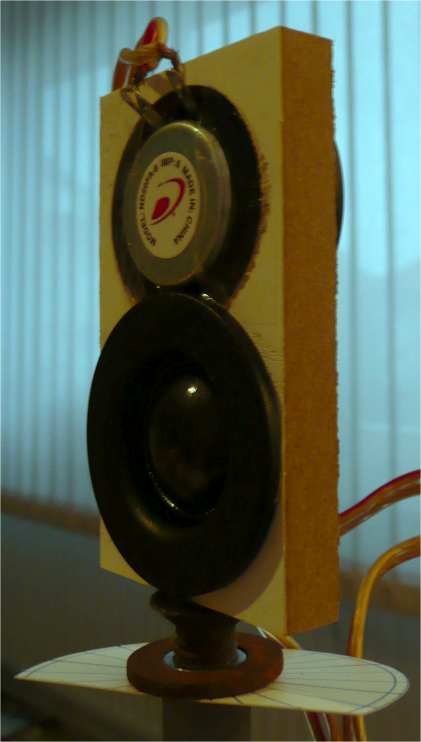

I have asked myself if it would be possible to undercut the dipole length of 4.1 cm. Voila:
I placed two Dayton ND20FA-6 back to back, but vertically offset, on a small baffle (8 x 4.4 x 1.4 cm). This results in a dipole distance of 3.6 cm at minimum (9527 Hz). See the horizontal response (0, 15, 30, 45, 60, 75, 90 deg), measured at 45 cm distance:
Not too shabby, either, with that dip at 8 kHz.
You may think that the vertical response will be very bad, concerning the vertical offset of 3.4 cm between the driver centers. That’s what I did too. But measurements along the vertical axis show a benign response. Green line is the power response:

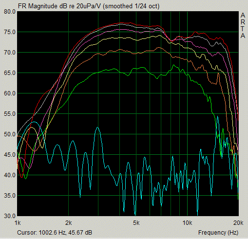

I cut the front plates of two Dayton ND20FA to the minimum and glued them roughly together without any baffle. You can compare the size to the previous baffle above. Dipole length now is 3.1 cm.
Then the same horizontal measurement procedure as before:
Since I could not believe what I saw, I did the same for the backside of the dipole tweeter and moved to the other 90deg side:
Green lines are for power response. Don't know why the 75deg response for the first diagram did not come up like that for the second series.
Tell me that this can't be true. Both drivers together are under 19 Euro. One BG Neo3 is 79 Euro in Germany.
