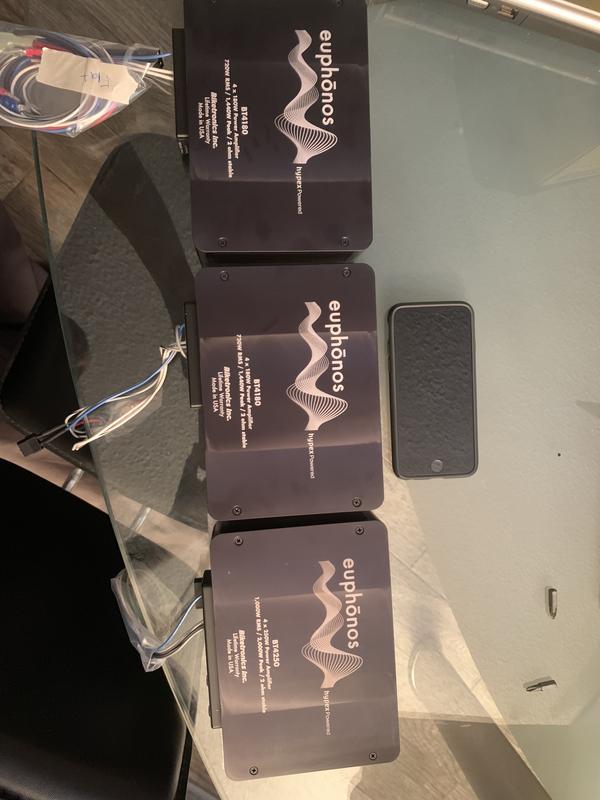

Here are some pictures!
Size comparison of BT4180 and BT4250 vs an iPhone 6s:
BT4250 above and BT4180 below:
BT4180:
BT4250:
BT4180:
BT4250:
You’ll notice my BT4180 and BT4250 bear a custom logo which Biketronics is able to accommodate onto the cover for you if you desire in place of their stock plate design.

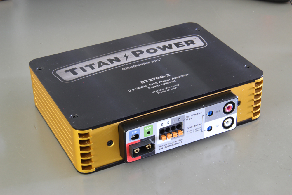

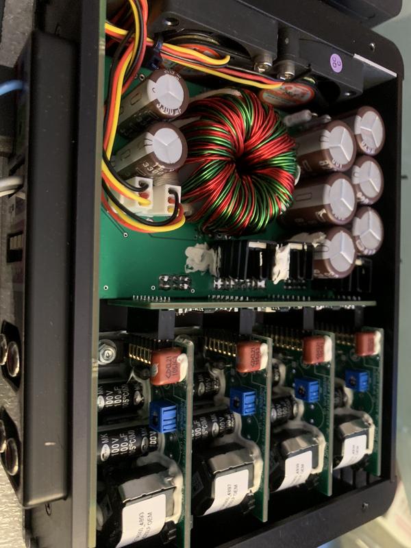

The BT2700-2 is 2 ohm optimal and pumps out 2 x 700 watts.
For anyone curious.. the 4ohm ratings for the BT2700-2 is ~450 watts per channel @ 4ohms loads.
This is mainly due to how the UCD modules handle current as there are two 400 watt 4-ohm UcD modules in parallel to produce the 700 watts @ 2ohm.

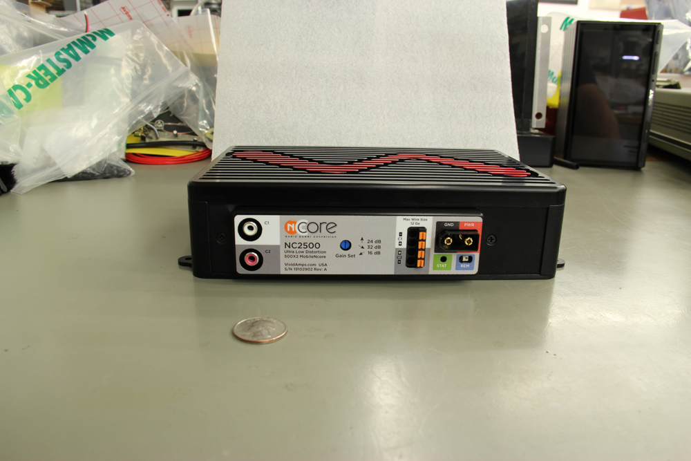

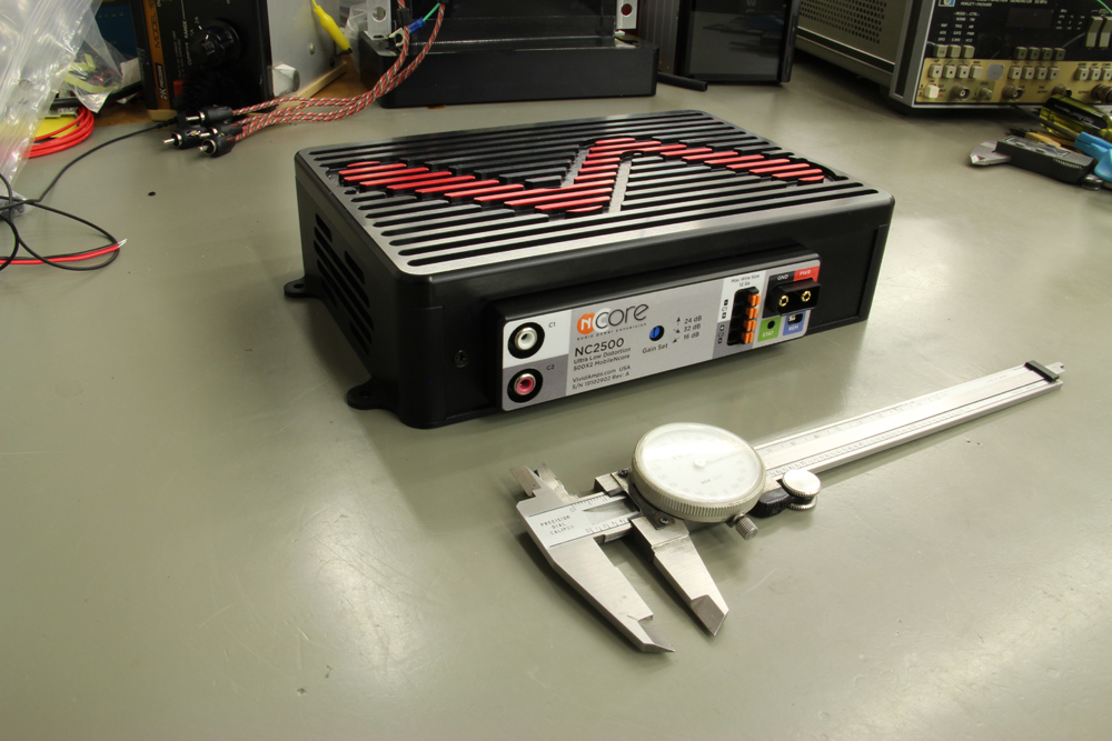

Also here are some pics of of the NCore 2x 500 watts @ 4ohm with a pretty much undetectable noise floor:
The power ratings for the NC2500 adhere to the Hypex ratings of of the NC500 OEM modules:
700w @ 4ohm
550w @ 2ohm
400w @ 8ohm
(per channel)

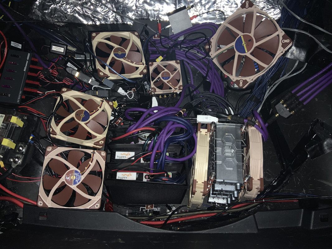

Here are my three stacked together (1 BT4250 and 2 BT4180) The noctua fan is a personal add on to help keep it nice and cool.
Active cooling is on all current models.
