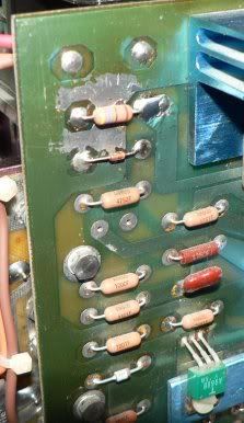

btw, my pcb looks like this:
the damage to the top of the pcb came from a breakdown due to faulty power-eletrolytic$$$$$ when the amp fried it took a dynaudio 17w75 with it

the MKII had Dales (all brown, no color rings)
i guess ive got a mk1
Isn´t that Dales resitors?
Yes, and there's a Toshiba 2SA968B in the corner.
Unless it has been modified, this is a MKII board.
Very confusing, the logo does not have mk-2 on it, Klaas ?
The KSA circuit Bra posted at the beginning of this thread had 50v rails, i never gathered who and why it was changed.

Klaas,
good guess is that your Krell is a mark I and has been updated to a MKII.
(in the late 80s it was possible to have a KSA250 converted to a monaural unit without a charge, the MDA500)
Means the 50 volts on your Krell is what it should be.
Btw, the fan on your KSA50 has been reverse mounted on the cool tunnel.
I would like to see a close-up picture of the front end/driver board of your Krell, if possible. I can only see 2 Toshiba devices, the KSA circuit that was posted had 4 .
