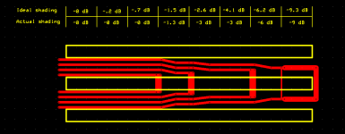

Here is a rough sketch from the previous thread of what I am thinking:
Since the force generated is proportional to the current through the magnetic field, I believe in theory that I should be able to add shading like in the image by progressively terminating traces early since then less current will flow further up the membrane. Although it is probably a good idea to widen the traces after terminating one such that the width of all the traces is the same across the whole membrane length. I.E. that on the bottom then the 4 traces add upp to 6 mm width, then after terminating 1 early then in the next segment then I widen up such that the 3 remaining traces add upp to 6 mm width. It would also reduce the resistance of the shaded segments, which I believe will let me, with 4 starting traces, shade down to -6 dB without any efficiency losses.
To shade beyond -6 dB down to - 12 dB I will have to pad the response with parallel resistors cut into the membrane but since only 12% of the membrane will have a shading from -6 to -12 dB the overall efficiency losses should be negligable. These parallel resistors is one of the reasons I might stay at 6 mm of traces width since then I have more room to add the parallel resistors in the areas between the magnets.
All in all I believe I will be able to add the shading network to the membrane itself while keeping the overall efficiency loss below 0.6 dB.

The next step is to start playing around more with the membrane. I still need to model the shading network... But I also want to play around some more with material and thickness. And since the steel plates are split into segments I will be able to mount and test multiple membranes at the same time by not testing full length membranes. That will allow me to do some AB testing which is nice.
