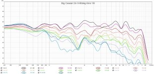

Your FR looks to have alot of smoothing applied, so yes, this type of soeaker will be full of resonances throughout the pass band. Mild rough response makes music sound more energetic. Too much will make it fatiguing. The high HF directivity is to be expected as well. The conical WG isn't a constant directivity design, so the only option you have is to boost HF shelving a bit to compensate. All things considered, its a very well designed package you created.

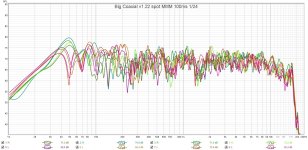

I attached my old Audyssey analog mic to the laptop and took some measurements near spot. First I eq'd each driver per semi-nearfield measurements. The nature of horns and slots in the baffle makes lots of spl variations, which are fortunately impossible to hear when doing sweeps. The 1kHz peak should be eq'd too... But this will do for today

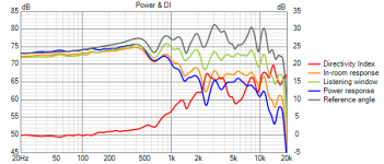

I couldn't keep my fingers off from HFD... v1.22 is eq'd based on near spot measurements. Xo is same LR2 at 200/2000Hz. Audyssey mic is not calibrated, but I set it's spl level according to my phone app's readings, which sounded ok. Polar was taken by moving the handheld mic around the speaker in the room, so it contains lots of reflections despite of 6ms gating.
