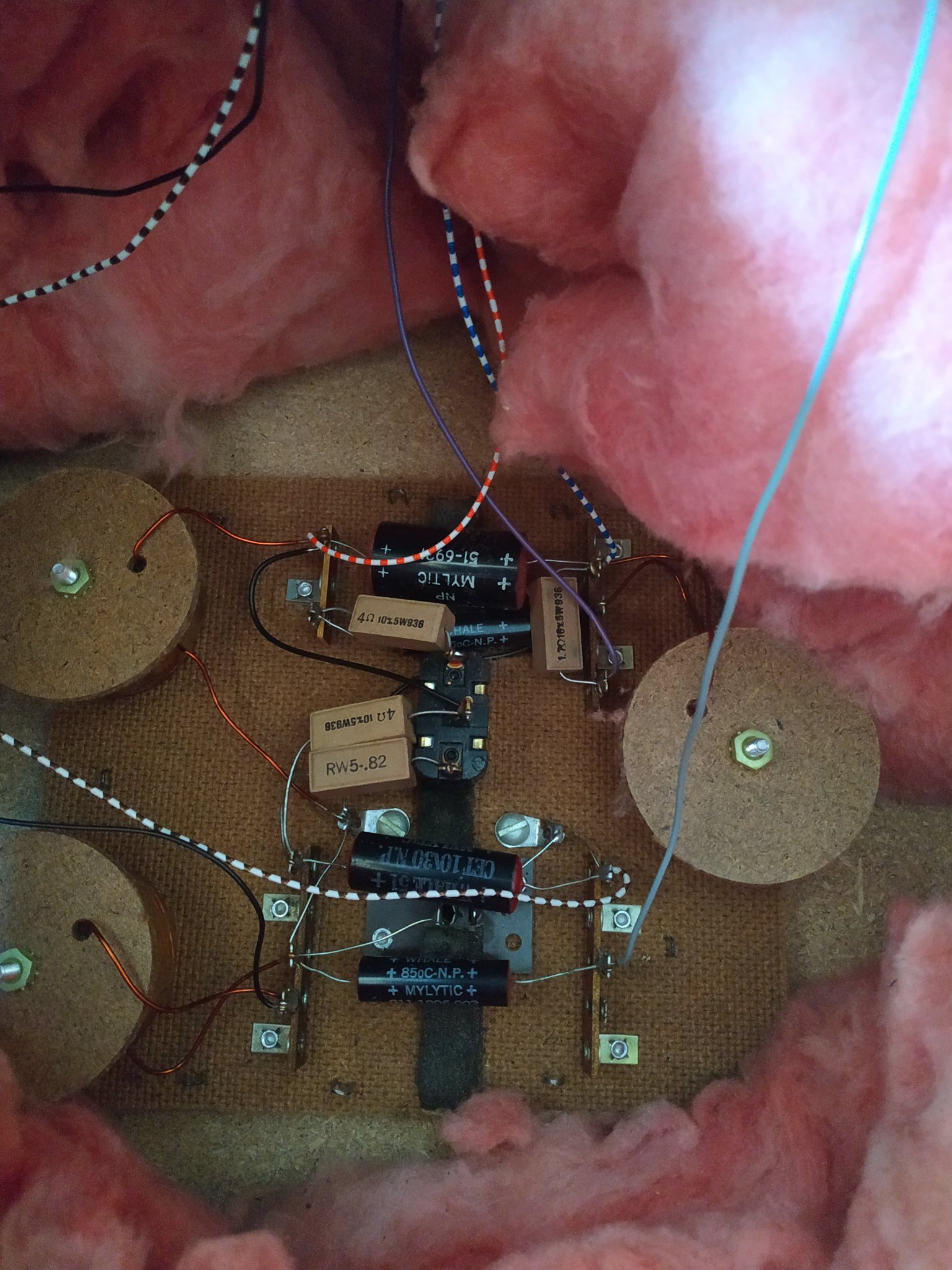

I found some nice XO and wiring pictures on the web for comparison, especially on this site:
https://www.audiovintage.fr/leforum/viewtopic.php?t=27809

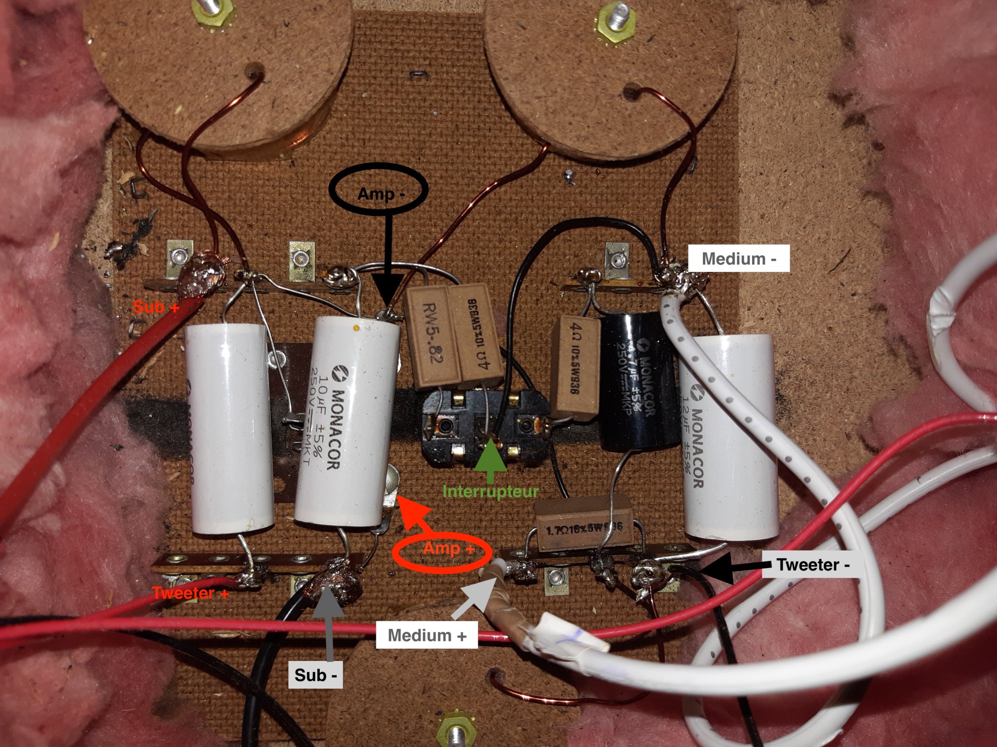

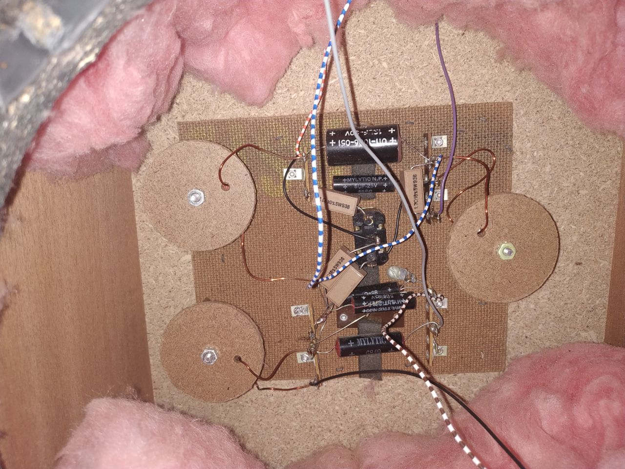

So far I cant find and error in your XO.

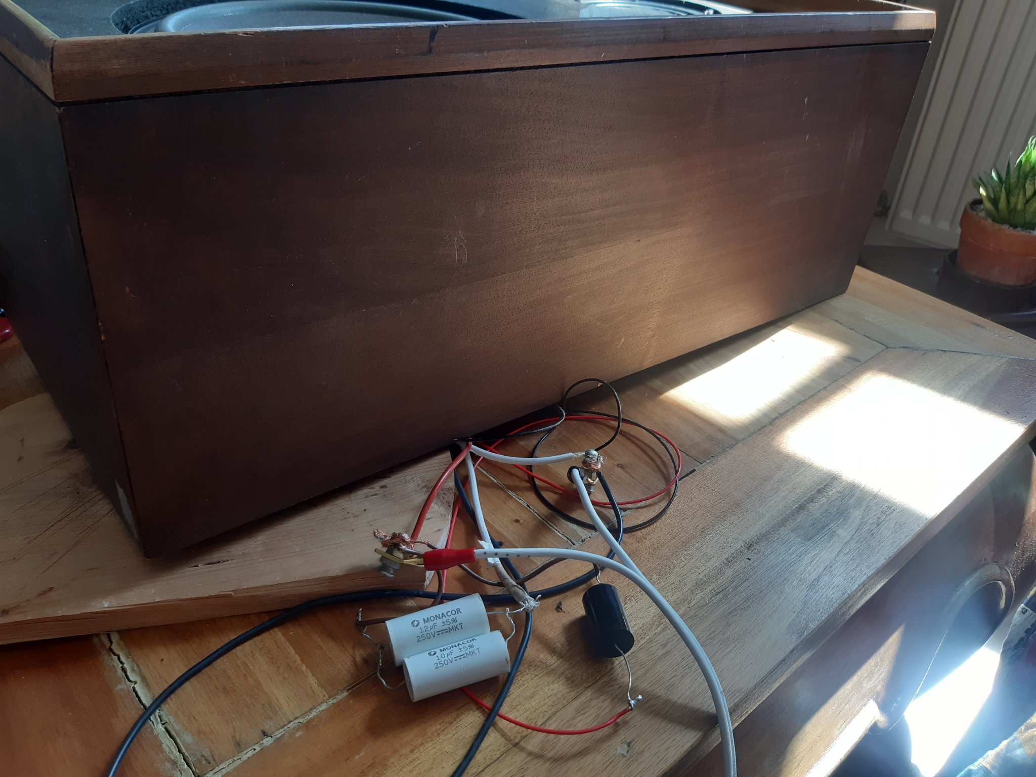

On picture at #4 amp plus/minus should go other way around, but that dont affect operation. Cap replacement job looks ok.
Possible reason why mid isnt working may be faulty 1,7 Ohm resistor or poor solder joint. Have you tried to check it, and do you have that problem on both speakers?
Btw, that 1,7 Ohm goes in series with midrange, so if replacement driver is 4 instead of 8 Ohm you can simply replace it with somewhat higher value, say 3-4 Ohms.
Iam working on schematics drawing, a bit weird layout but not to hard to understand. Hope to post some tomorrow.

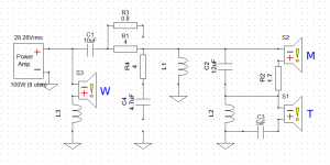

You were right of course if as I suspect you were talking about a series crossover... (a way to do a lot with few parts)Yeah, started to do a ladder scheme,
I agree with schematics from #43, but I think "H" terminal (also connected to center of other connector) should be amp+
That HiFi Stereo article also claims that.
This is hand sketch I made. On available pictures I couldnt see the value of tweeter series capacitor so I left it without value. Interesting layout anyway.

I agree it looks upside down. 🙃should be amp+
Its good to have drawings from both ends, your version is a bit more revealing.

In the meantime, I played some more with VituixCAD, and simulated a 2nd Order Reverse Polarity XO. Here is how it looks. What do you guys think? I'd love to have your opinions before putting together something silly. Also, I'm surprised to see the medium with upside down polarity in such XO. The driver won't play inside-out, right?! I guess it would make sense if I had a clue about engineering.

The midrange is reverse wired in your circuit to ensure it is acoustically in phase with the other drivers.
That is what the term "Reverse Polarity" is indicating.

OK! So I am not sure I have fully understood the dos and don't of the impedence graph. So here it (with all other graphs, on an updated version, which also uses the exact values of components found at my local dealer)
...sorry, I see that I failed to send the end of my message in the last post. So here is the state of things now. Would you say that the impedance is usable? Your opinion on this (or any part of this XO) is much appreciated!
The lowest point is higher than 5 ohms. That was the concern, so that looks OK.
Try taking the resistor away from the woofer circuit. In any case let it be higher in level.
