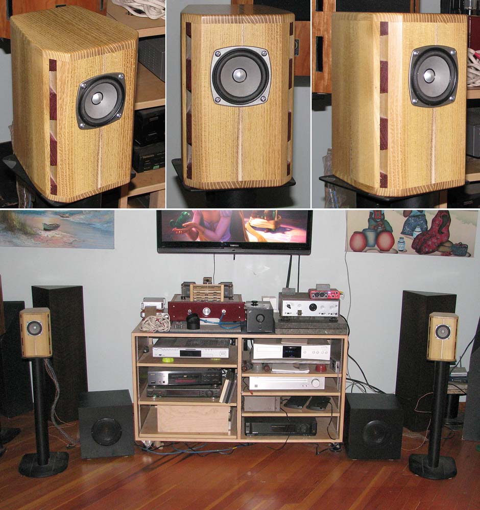

I just made a couple posts on the subject of outside shape: 3D printing enclosures without actual knowledge
Inside is a different thing. A sphere is one of the worst shapes for internal standing waves.
The affect of shape, inside & out, is different depending on what frequencies you are talking about.
A rule-of-thumb is that if you pass the unwanted back radiaiton, having it go thru a quarter-wavelength of damping material before being reflected. Of course how close depends on how effective the damping material is at the frequency of interest. A TL, quarter- or half-wave, damped until aperiodic is good for taming any internal air space resonances.
With sheet material having a box with significant chamfers can get really close to a more ideal shape.
With a loudspeaker in a room you are more interested in the horizontal than the vertical.
Trapezoidal with big chamfers:
Rectangular with large chamfers:
Cuboid shape (Classic Golden Ratio):
While none of these use the same driver (there exist literally hundreds of these with many different drivers), they illistate the difference in shape. The first speaker ia 2.5 litre, a variation of the same basic shape can be had up to 135 litres so far.
If we do take a set of these with the same driver, but of the set of 3 different shapes. Alignments are all the same. But with a reslving enuff system one can hear the difference. The extra effort of building the trapezoid pays off in a lousdpeaker with a lower diffraction signature, and a greater ability to “disappear”.
Here one can see how the trapezoid mimics a teardrop in the horizontal plane:
