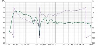

I plan to spend some more time tonight to debug the phase issues I have. This week I measured a very deep dip at 260-280 Hz @ 1m distance, although I am quite sure that the drivers individually have the right phase setup. It looks like that the filters or phase shift of low/mid drivers results in almost exactly 180 degree phase shift... 😕
Adding roughly 600 us delay to mid and tweeter solves it largely, though I did not search the optimal value yet.

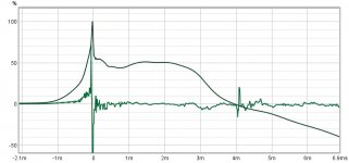

To illustrate my point, hereby some in room measurements at 1m distance, all at AMT height. Harsch XO is done at 300 Hz and 1600 Hz, delays are only set to Harsch XO values (no driver delay compensations).
Non-inverted:
Clearly a phase mismatch is around 300 Hz. Step response is not a nice traingle.
Inverted:
Better phase alignment at 300 Hz. New dip at 500 Hz. Nice step triangle, but strange start of step response, probably due to HF in wrong direction.
I will do some more experiments with changed delays...

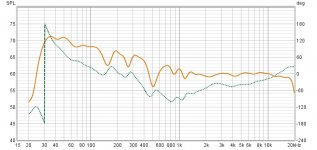

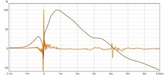

After an evening filled with delay related measuring experiments, it looks like I got my test open baffle system in a better shape. I made a LR4 preset with exactly the same driver compensation EQs as my Harsch XO and searched for deepest dip around 300 Hz using inverted woofer. The mid delay needed to be 405 us compared to woofer. Applying this delay to Harsch XO (added to mid+tweeter) gave satisfactory results. Next, I spent some effort optimizing the frequency response curve.
Response is now:
Mid response is still up for improvement, but no extreme things anymore.
Nice sharkey curve eh? 🙂
Response is now:
That looks good Fedde! The tonal balance has a nice right tilt down and that makes for an enjoyable and fatigue-free listening experience with foot-tapping bass. The time alignment on the bass/mid and tweeters is good.
Thanks for the feedback XRK. I am glad I sorted this out. I added cushions on the floor during measurements to be less confused by reflections.
Still, I need to get used to the new sound a bit. On first (low level) listen it became more soft, perhaps due to missing peaks or improved timing. Though I need to listen longer for final conclusions.
