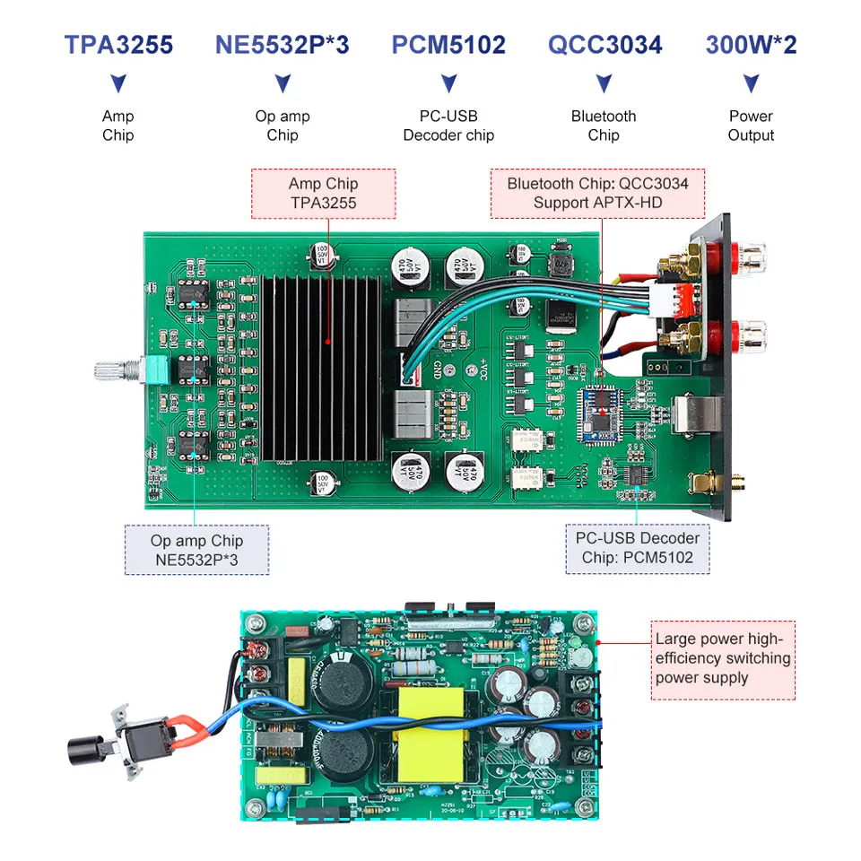

I have the feeling that Aiyima still has not kept his promises.... Another TPA3255, with bad caps....
