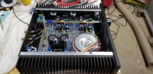

Well my Neurochrome LM3886DR is all built now!
I did my best to keep all the wires separate and not parallel. Ended up using Mogami coaxial for the run from the 10K Alps pot to the amps, but the run from the inputs was too short to use it, so I used some short bits of 22g twisted solid strand.
The power wires ended up braided just because I don't like zip ties.
Amp to speaker outs is 16g twisted solid core.
The only thing left to do is connect a source and some speakers to see how it sounds. (don't worry, I will test with an old crap 6x9 car speaker before connecting a real pair of speakers)
Before I do try it though, does anyone see any obvious mistakes I have made, or things I should correct?
Be nice, this is the first amp I have built, and without such an easy kit with access to Tom, I don't think I could have done it.

You're very welcome. I'm glad to see that the amp came together nicely for you.
You get bonus points for using grommets where the wires go through the false bottom.

Looks fantastic! Nice build!

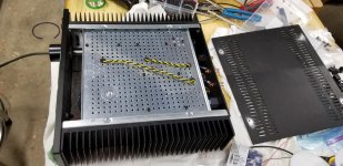

I try to get the case ready before I start with the electronics. Working the case usually takes more time and if you have the case ready to go you just "drop in" the electronics.

Yeah... An electronics teacher of mine of years past referred to the chassis as "the last 10% of the project that takes the last 90% of the time". 🙂
That's one of the reasons I've started to have ModuShop (and others) deliver the chassis with all the holes cut and threaded. I love being able to put together an amp in half a day instead of in a few weekends. But... It is more expensive. They don't work for free.

Yep, it took me all weekend to drill out all the openings for my Hypex DLCP build. Would have looked better if I had Modushop do it. Live and learn.
