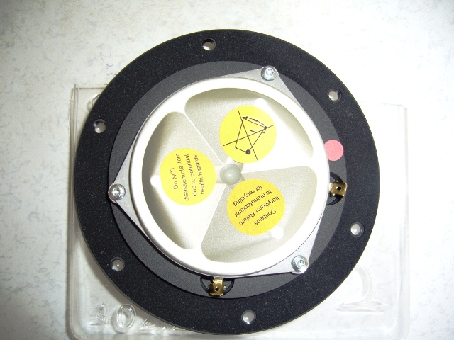

So does the MAT absorber connect to the small pole piece vent that normal blows through to the back of the magnet? This looks very 3D printable and we can measure the lengths of each channel to see what wavelengths of interest they were trying to absorb here. There is still output from the back side of the cone proper. Is that being forced through this as well? I don’t think so as that would be too much acoustic resistance and you would not get the proper bass response based on the driver Vas, Fs, and Qts.
So I heard the disc diameter is 3in. We can scale and measure from there.
The detailed image in AudioExpress appears to show a more complex 3D structure with multiple labyrinth plates with connected axial flow between the micro channel plates.
From the above view it looks like most radiation from diaphragm backside still passes through basket arms into the main rear box volume.
The plastic disk is to absorb the back wave of the tweeter.
AFAIK, it has no effect on the midbass.
There are a series of channels and each channel nullifies a narrow band of frequencies.

Hi Few,
You're welcome and thanks for the questions 🙂
The losses are simply from the viscosity of the small tubes.
There are two discs each forming 15 tubes. There are 30 tubes in total. Each tube has a unique length and is carefully folded into the disc. The distribution of the tube lengths, and consequently the tube resonances, is important for achieving broadband absorption.
The tubes have very little loss, just a tiny bit from viscosity. Which means that the acoustical impedance at the entrance of any one tube is extremely small when the tube-length is a equal to (2n-1)/4 wavelengths. This allows each tube to be very tiny but still dominate the overall impedance around specific frequencies.
I was trying to think of an intuitive way to explain this and, although it's not quite the same situation, I assume you're familiar with reflex loudspeaker behaviour. A reflex port can stop the driver from moving at Fb even though the port area is tiny compared to the area of the box walls, and irrespective of where the port is located.
The tube size is a key parameter and goes hand-in-hand with the number of tubes. If there are fewer tubes then they must be larger to correctly absorb the incident wave. In this case there is less viscous loss and also the tube resonances are less spectrally dense, this leads to an uneven absorbtion spectrum. On the other hand if there are too many tubes the viscous losses become too high and the absorption at low frequencies starts to fall. This is all discussed in some detail in the AES paper.
Can you explain where the loss comes from in the metamaterial? I can see how adjusting dimensions tunes each tube, but I don't have an intuitive feel for the mechanism for thermalizing the acoustic energy. Is it just air viscosity in the small diameter (~2 mm?) channels?
And I understand there to be two disks of metamaterial. Are there two identical/similar disks doubling up to increase the absorption, or are their roles more distinct?
Okay, three questions (sorry).
If there is a 2 mm x 2 mm entrance to a given tube, how does it manage to almost completely convert the energy at that tube's tuned frequency to heat when most of the sound goes elsewhere? I don't doubt your results, I'm just trying to update my understanding of acoustics. How do you achieve 99% absorption of 1 kHz sound with a tube whose cross section is a few mm^2? Most of the 1 kHz sound impinges on tubes not tuned to that frequency. Even if one tube achieves 100% dissipation, the area of its input seems tiny. What am I missing?

From the AES paper:
- The overall width of the disc is about 85mm and the interior width appears to be about 75-81mm.
- the channels appear to be 2mm x 2mm, based on what Jack said
- There are two sets of channels. Each have 15 paths arranged radially, for a total of 30 paths.
- The overall diameter of the device is 11mm
I pulled the image into Xara X1 and manually measured the length of the channel that 'nulls out' 620Hz. The channel length appears to be one half wavelength.
So, based on that, I think the process of making one appears to be fairly straightforward:
- Option one: copy the Kef device
- Option two: make something similar, but with 90 degree angles. IE, a maze.
Personally I'm inclined for option two. If I had a LOT of time on my hands I could replicate the radial paths of the KEF device, but ugh that would be a P.I.T.A. to draw.
This might be one of those cases where we might be able to use the AI built into PCB layout software to auto-route the paths for us. Then take that and 3D print it. You could even have custom 2mm thick PCBs made with these channels. That would provide much better resolution and tolerances. You can then sandwich them together. Stack more than 2 if needed, maybe make 3 or 5. the idea of 30 or so channels is consistent with studies by Fraunhofer institute when they developed MP3 encoding. They saw that test subjects could not discern the difference in sound quality when compression used at least 32 frequency banks. So it sounds smooth to the human ear circa 30 to 32 bands.
Something that hit me, when I was doing these Hornresp sims:
You probably can't get the whole picture unless you model every last channel.
Here's why:
There are 30 channels in the KEF device. The channels appear to be 2mm x 2mm. Combine all 30, that gives you an area of 120mm. That's the equivalent of a *single* tube measuring 12mm in diameter.
Because of this, if you only model one or two of the channels, you get an impedance mismatch. You can actually see this mismatch in Hornesp: when you simulate the device with only one or two channels, you see a reflection. And that reflection is caused by the impedance mismatch.
The same idea as higher order modes in a waveguide: If you had a waveguide that necked down from 100% to 25%, you'd get a reflection at the point where the impedance mismatches.
Here's a cutaway of the KEF loudspeaker. Note how the tweeter is one inch in diameter, the mouth of the waveguide inside the voice coil is 3/4" in diameter, and the exit of the waveguide is 1/2" in diameter. This is an excellent match for the 30 channels of the absorber.
I think that if you were to scale this thing larger or smaller, you'd have to use larger or smaller channels, respectively.
I think that if you used more channels, the channels would have to be smaller.
I think that if you used fewer channels, the channels would have to be larger.
Again, we want to avoid an impedance mismatch.
