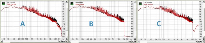

Ok there are now six reactions to the listening test.
Outcome is in the table below.
The three samples where in this order resp:
A: The unprocessed 88.2/24 .wav file from 2L.NO
B: Now BW restricted to 20Khz/24, packed in 88.2/24
C: BW restricted to 20Khz and truncated to 16bits. packed in 88.2/24
In case B and C, non correlated content was added to above 20Khz,
and in case C non correlated noise was added to fill the space between 16 and 24bits.
Two candidates couldn't here a difference.
One had all answers right but reported very slight differences.
Three judged the original version to be sounding the worst of the three.
This test proves nothing but that if there are differences, they must be very small.
Hans

View attachment 823884 View attachment 823885
Cool. All other where to afraid, to old or to technically inhibited to even try. Aha so you added some fairy dust above 22 k for A and B. Thats one way to do it. Another would to leve this additions out I suppose. What made yo take this interesting path?

I must say A was noticeably worse sounding.....it had a definately muddied Sound with less definition. This I do not believe to have been imagination, now the difference between B and C, I could understand as there was no night and day difference there for me....very subtle, and I could understand being mistaken.
Please don’t take this as an excuse from me but something was definitely wrong with A ?

When you say something like 24/44 is 'packed' in 24/88, exactly how does one pack it? Are the 44kHz data zero-stuffed to make them 88kHz, or what?
Could it be caused by resampling to 96k?I must say A was noticeably worse sounding.....it had a definately muddied Sound with less definition. This I do not believe to have been imagination, ...
Thanks, Hans!
Btw, my workstation complains that files are at 88.2 , not 96 kHz 😉
Thanks Elektroj, you are right, I didn't notice.
I took it from the test bench site as being a 96/24, see image below.
But it happens to be 88.2/24, still well above the 80Khz that JC and Richard are propagating as the minimum Fs, so for this test it won't hurt.
Hans
Original was 88 as well as the posted files. No resampling dona as I understand it.
Was supposed to be 96 ?
https://www.diyaudio.com/forums/attachments/the-lounge/823593d1583743699-black-hole-testbench-jpg
Edit.....after looking at this site/chart Hans downloaded from wouldn’t a more appropriate test have been between the 24/192 (one file to left), 24/96, and the 16/44.1 version straight from the site? It was there three files to the right.
Bob: it was supposed to be 96 on the link but 2L had something wrong. This way we have exact provenance of what was done, whereas on the 2L site we don't know what they did. also if you KNOW what each file is that can drive an expectation of the outcome. This way you only had your ears.
Yah.....something is not right with A though, I’d go to the mat on it.
Bill, what I meant was a random blind test of the three unadulterated files straight from the site.
It doesn’t matter that I failed to identify it correctly......I’m fine with failure, it happens to me on a regular basis! It’s just that something is quite obviously (to me) wrong with A.
