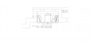

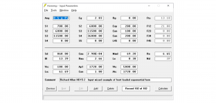

As described in the first post:
L12 is in the folded horn built from timber. This is obviously an approximation of an exponential horn in the three folds. That approximation is not unreasonable in Hornresp.
L23 is formed by the two horns facing into the transept, and is the path length to the top of the horns exiting into the transept (ref post 1)
The last expansion is from the transept into the hall itself.
The model is half PI space, as there are two of these horns in the transept. The actual hornresp model is for only one of them, as you obviously need the second horn to turn the full Pi space into half pi space.
I hope that between this post and post 1 you get the hang of it.

Today was long. I thought that all the pre-work yesterday would make this easy. It did mostly.
The hard bit was adding braces to everything that braces could fit to. More measuring and cutting and glueing and screwing.
The build order was kind of middle out. Middle baffle first.
Then the second baffle and braces.
Shoving them into their approximate location (I put nine giant felt pads on the bottom - a damn fine idea as it turns out.)
They fit pretty well. A gap of about 20mm on the left hand side for the design desk width.
Then bolting the drivers in. I angsted over the driver access hole - and in the end made it 400mm a side. I wish I had made it much taller, as getting the top bolts in was a real hassle. I ended up doing contortions on the floor and getting cramp.
And swearing a lot. But anyone that knows me would kind of expect that anyway.
So, the tops went on.
Both went on fine, and all the screws went into the baffles hidden away inside the box. Phew.
The left hand box is close enough to perfect. A sand and lacquer will have it exactly as I envisaged.
I will never publish a photo of the back (into the transept) side of the right hand one. Somewhere during screwing there was about a 6mm shift of the back panel next to the horn exit. At that point given all the baffles screwed to it, and the fact they had been there for 5 hours meant there was no "quick fix".
Even a cup of coffee and a good chance for my OCD to kick in did not have me take - well I don't know how many - screws out to try adjusting it. The adjustment would certainly have involved ripping lots more things out and....
Oh well.
If you ever want to see obsession in a build, check out "Bad Obsession Motorsport" on youtube. They have a project building a mini using a modern turbocharged engine and 4WD. These guys are utter perfectionists, and hilarious to boot. Cups of tea (they are Brits) feature heavily in their work.
Well I have to accept that at the back of the right one is a bit of a lip under the top. At least it is hidden.
I should have got someone to laser cut the panels🙂

I hooked both subs in series making an 8 ohm box.
I did not bring a DSP XO with me. I have hooked them up to my desk stereo. This has a passive XO at something below 80Hz (LR 24dB). The 18 inch sub hooked to it is a reasonably typical driver. IT used to sit next to my desk, so while I can't remember where I set the frequency, it wont be anything above 80Hz.
Just plugging this sub in had the levels totally out of whack - I expect the model is right, there would seem to be easily 10dB more bass from this sub than the good old ported 18.
I ran a sweep from 200Hz down to 10Hz. As you do.
In the crossover region it was a mess. No surprise though.
From about 60Hz-ish (at a guess - I figure the LR XO slopes up there somewhere) down the level leaped to a lot more than I was expecting. I cannot imagine there was even a watt going into them, but the output just continued down - rattling pretty much the whole place.
I couldn't hear much at the end - though I would not expect to. The tin wasn't rattling anymore either - so I guess that by 10Hz things have indeed rolled off a lot. As expected, and probably a good thing.
That said - at 20Hz they are rocking and rolling to use a carefully calibrated term. I am going to have to be very careful with these.
