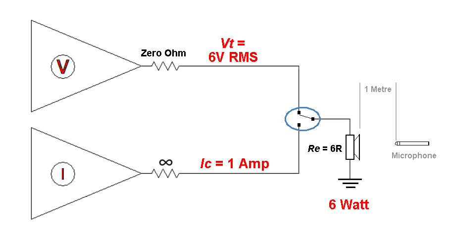

Dear Joe,
do you even understand your drawing?
0 ohms with 6 volts output is indeed 6 volts into a 6R load,
but infinity ohms into 1A, to a 6 ohm load is infinite volts, have you invented your own mathematics now?
even if you were to change infinite, to "very high impedance", the answer will still be very high voltage.....
if you do not realize the folly in what you post, then you will be continually be challenged by people who knew better than you..
George Simon Ohm can never be disrespected....nor discarded...
Source impedance is zero, the amplifier is outputing 6V (and a cuurnt based on the R).
Source impedance is infinite, the amp is outputting 1A (with a volatge based on R). ie 1 A into 6Ω.
Now qirg a speaker the 1st case has to use the (usually) reactive speaker as the IV converter. No conversion needed in the 2nd case.

what i am saying is that you need an amp with an infinite voltage in order to do that, sorry if i was not clear..
because each thevenin circuit has an equivalent norton and vice versa..
