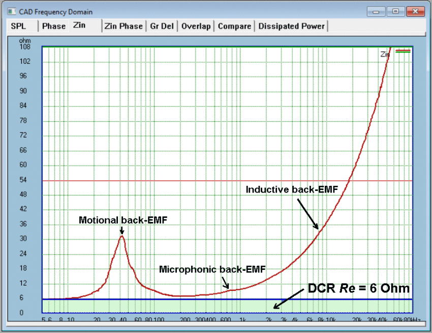

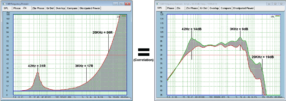

I could elaborate on something that got me in a heap of trouble when I used the term "back-EMF impedance" which is the excess impedance above the value of the DC resistance of the voice coil. Only the current that flows through the DC resistance part of the impedance dissipates heat.
Let us say the impedance at 3KHz is 17 Ohm, but the DC resistance is 6 Ohm.
We use a voltage source set to 6V and compare that with a current source producing 1 Amp.
Now if there was no back-EMF impedance, then both would result in 6 Watt because they are equivalents. But the back-EMF impedance means they are not and it is the relative change in dB that is important.
So this is the jig:
And here is the result. We will concentrate on the 3KHz, but note that you can pick any frequency and you can both calculate and measure the change in dB.
3KHz:
Zload Impedance = 17 Ohm
Re = 6 Ohm (Part A of impedance)
Back-EMF = 11 Ohm
Current drawn from voltage source, 6V/17R = 353mA
17R/Re = 2.83
Log(2.83)x20 = 9dB
Now check graph for dB-SPL difference = 9dB
Vre = 0.353A*6R = 2.1V
Power Dissipation = 0.353A*2.1V = 0.75 Watt
Relative to 6 Watt (full 1 Amp) = 6W/0.75W = 8:1
Log(8.1)x10 = 9dB
Not sure if you can see the pattern, but the Vre represents in voltage terms exactly what the driver is producing because it is only a function of current. Also note, you can do this calculation at any frequency and the maths and check the voltage to current variation in dB.
If you understand it, and I know that it might not be easy, yet the above proves that the dB-SPL output of the driver is directly related to the current and only current.
The key here is to understand that the excess impedance is back-EMF, where F stands for force and what does that mean? That this is a voltage source working against the current of the amplifier. It impedes the current, and hence I call it "back-EMF impedance."
Any driver imperfection will show up as a variation of the back-EMF impedance in series with Re, and hence modulate the current of the amplifier. The resulting Vre will show up the distortion. If using a current resistor like Pavel did, the voltage representing the current of the ampplifier is actually Vre being measured.
Ergo, if you have a bad resonance somewhere in the driver, that will show up in the current of the amplifier. But it might also trigger rubbish, like IMD, from the amplifier and each design could be different.
This also explains Pavel's measurement and why distortion was lower under current drive, because the modulation or corruption of the current cannot take place wihen the amplifier is putting out a fixed current. It resulted in a massive difference of 20dB of distortion. Had he used a tube amp, would it have been less?
So the tweeter's distortion was its own under current drive, but got worse under voltage drive, this now makes sense. We haven't reduced the distortion of the tweeter under current drive, it is just that it is worse under voltage drive.
Whew! There is of course more to it... I have just tried quickly to give you the idea.
