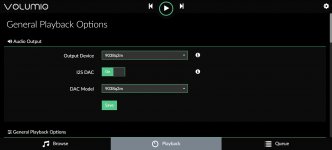

hi, there,
to make it easier i'm posting some photo rather than typing.
freshly installed volumio 2.513, unzip and copy ' ko ' ( have 4 files now ) to /boot.
ssh to volumio 2.513
sudo cp -r /boot/ko/hifibunny-codec.ko /lib/modules/4.14.71-v7+/kernel/sound/soc/codecs/hifibunny-codec.ko
sudo cp -r /boot/ko/hifibunny-q2m.ko /lib/modules/4.14.71-v7+/kernel/sound/soc/bcm/hifibunny-q2m.ko
sudo cp -r /boot/ko/hifibunny-q2m.dtbo /boot/overlays/hifibunny-q2m.dtbo
sudo depmod -a
sudo rm -r /volumio/app/plugins/system_controller/i2s_dacs/dacs.json
sudo cp -r /boot/ko/dacs.json /volumio/app/plugins/system_controller/i2s_dacs/dacs.json
sudo nano /volumio/app/plugins/system_controller/i2s_dacs/dacs.json
sudo reboot
install this volumio plugin
https://github.com/ChrisPanda/volumio-es9018k2m-plugin/releases/download/0.1.0/volumio-es9018k2m-plugin-0.1.0-sys-2.4x.zip
setting 12s
volume setting
resampling
dsd setting
plugin volume setting
digital filter dosn't work, don't touch it.
both pcm and dsd allow to lowest. great sound quality, modification on the dac boad is optional.
done
cheers
