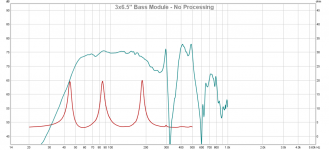

So, it looks like pouring a load of glue down each joint worked.
Results:
The measurement was taken indoors, with the mic placed at each port outlet, and then summed in REW. Since the ports are the same size, it should be pretty reliable. I'm hoping to take everything outdoors for some proper measurements, though the outdoor space isn't huge.
The 300Hz peak comes out of the low-frequency port. 4-500Hz is from both. If you want to cross to the mid-high cabinets above 100Hz, you'll need EQ and/or a steep crossover slope, but it's perfectly possible. The low-pass filter on the mixing desk I use is only 18dB/octave, so I'll probably use a couple of parametric EQs to ensure the peaks through the midrange don't get excited.

Chris,The measurement was taken indoors, with the mic placed at each port outlet, and then summed in REW. Since the ports are the same size, it should be pretty reliable. I'm hoping to take everything outdoors for some proper measurements, though the outdoor space isn't huge.
The summed measurements look pretty good! Looks like Fb came in at the bottom of your 10Hz "window of acceptability" ;^).
Was the mic on the floor or at the center of the plenum and ports?
My bet is there are rather large differences in the upper response peaks and dips between those two measurement positions.
Looking forward to how your outdoor measurements at some distance compare to the outlet measurements.

Hi Art,
The mic was resting on the bottom panel of the cabinet. Just a quick-and-dirty measurement to make sure everything was sealed up properly.
A quick listen suggests some EQ to knock those peaks down fixes the very "boxy" sound you get running it full-range.

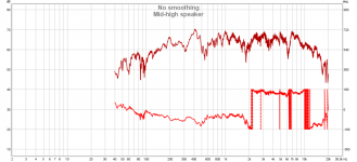

First up, the 1x6.5" top:
The dip around 2kHz is dependent on the height of the mic. The 400Hz peak isn't fantastic, but way better than the untreated cabinets. I've been EQing out the 400Hz peak.
Sensitivity came out at 94dB at 2.83v at 200Hz.
They're a bit bass-light, but that can be helped by putting them close to walls. The measurement here was on a stand in free space.

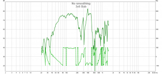

Next up, the sub:
Outdoors, without close-micing, the rolloff moves up quite a way, which is a shame. The upper response is still messy.

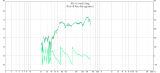

After some playing around, I got the two to join up:
BW3 at 170Hz, LF with reversed polarity. I also added a couple of notch filters to help kill off the out-of-band mush.
With a little EQ applied to the mid-high speaker, the result is a really good sounding system. A touch short on bass extension, perhaps, but enough to give acoustic instruments (cajon etc) some grunt.

Chris,Next up, the sub:
Outdoors, without close-micing, the rolloff moves up quite a way, which is a shame.. A touch short on bass extension, perhaps, but enough to give acoustic instruments (cajon etc) some grunt.
I'd like to do some high-power testing before committing to building the second bass module, but things are looking good.
Not bad, within a few dB of the sim at 60 Hz, should be able to get it flat to there without heroic EQ.
Not that it would make a difference unless you used these subs with others, but why reverse the LF polarity instead of the top?
